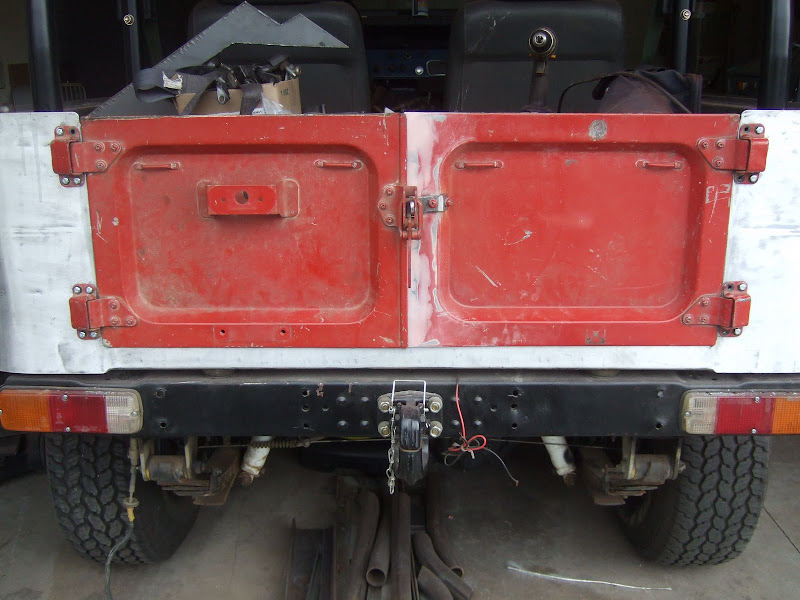

The dimensions are not exactly the same. When I put barn doors on my later model Aqualu tub, I had to widen the barn doors about a 1/2". They don't fit as well as they do on an early model tub, but they fill the opening no problem. I also had to add about a 1/2" to the hook as well. And, like you said, drill the holes for the doors. Overall, it wasn't too bad to get them to fit.
But, like I said, they fill the hole no problem.

Will can shave the corners and adjust the hinges or drill them in the right area to mount the edges inside the jam.
As you can see if you flush mount them inside the jam, you will have to reshape the corner. I you allow them to rest just outside, you are fine.

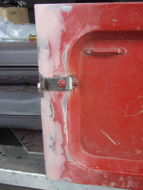

The barn door hinge fits the holes of the ambulance door. I using these existing holes for the top hinge, so i only have to drill holes an backing nuts for the lower hinges.
