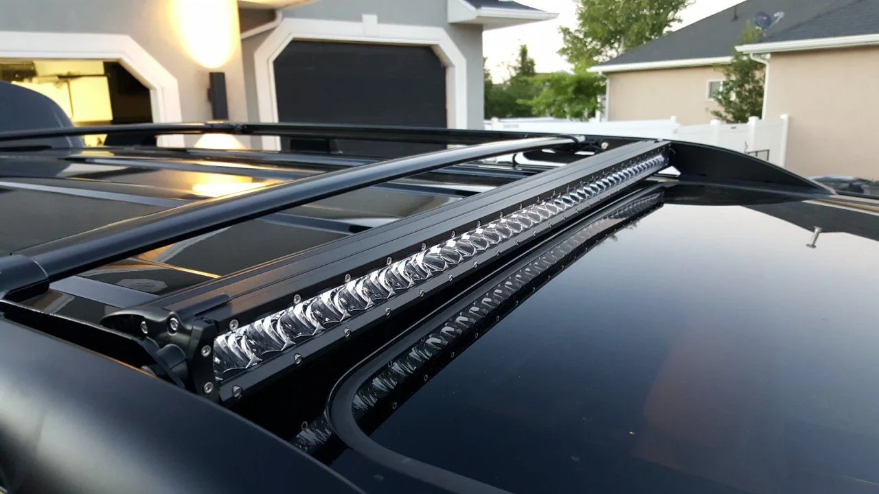

Few little updates..... Added a 40" LED light bar to the factory roof rack after fabricating some brackets, thread is here.

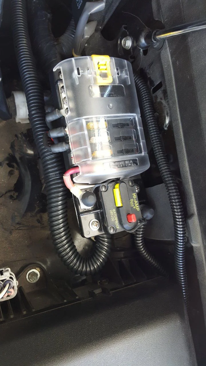

Spent this morning finishing some electrical work. Added a BlueSea fuse block and circuit breaker (made a little shelf for them out of aluminum). Ran wire back to an auxiliary 12V outlet I added for the fridge (mounted under the 120V plug).

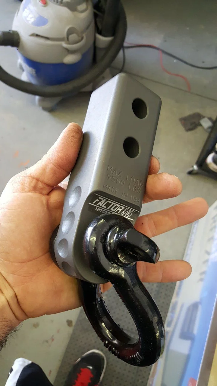

I have a Amazon Prime problem. :hillbilly: This nice little FACTOR 55 lightweight hitch-mount recovery point showed up yesterday.

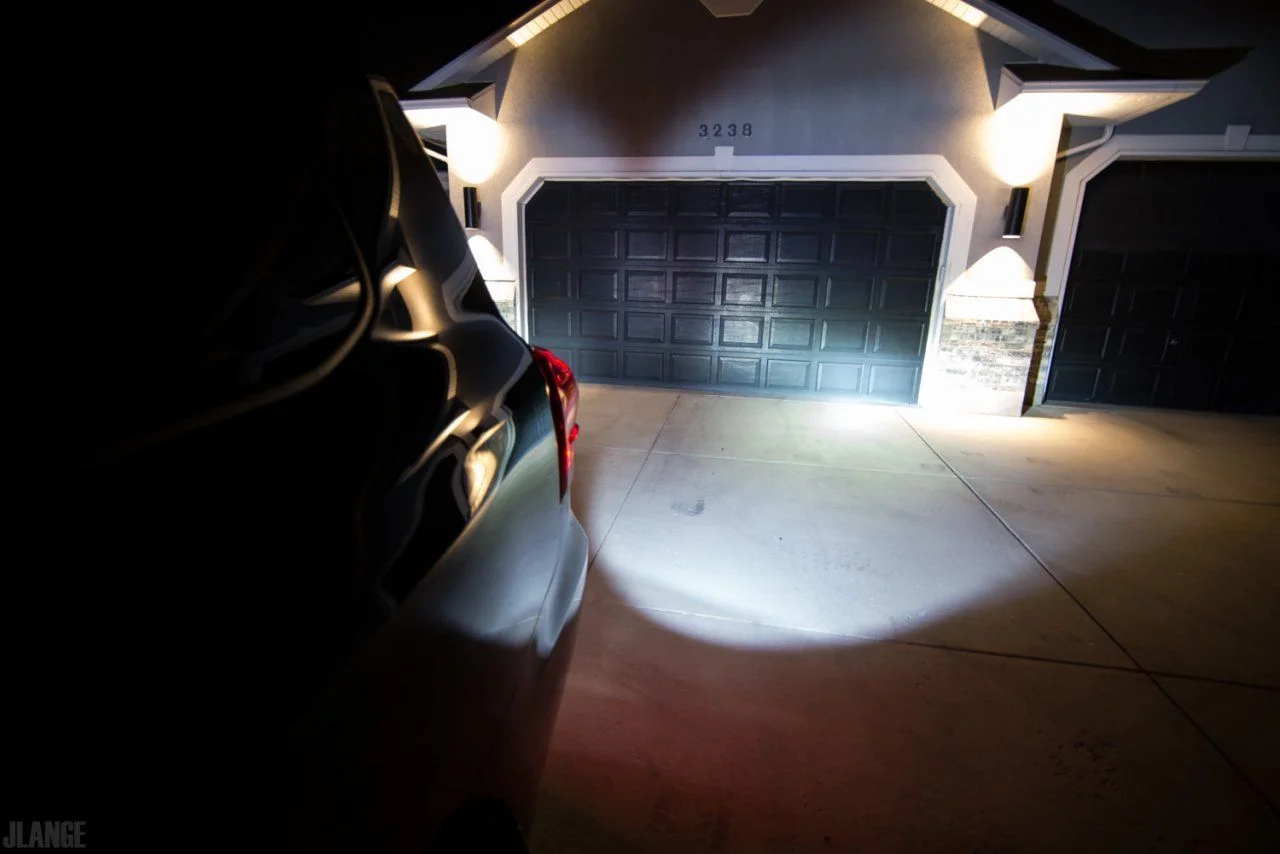

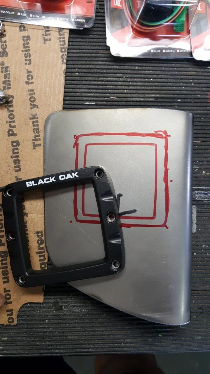

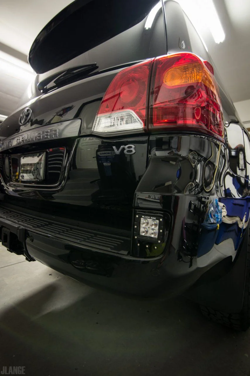

Finished up a little project I had going for mounting a couple LED reverse light pods in the factory bumper reflector area yesterday.

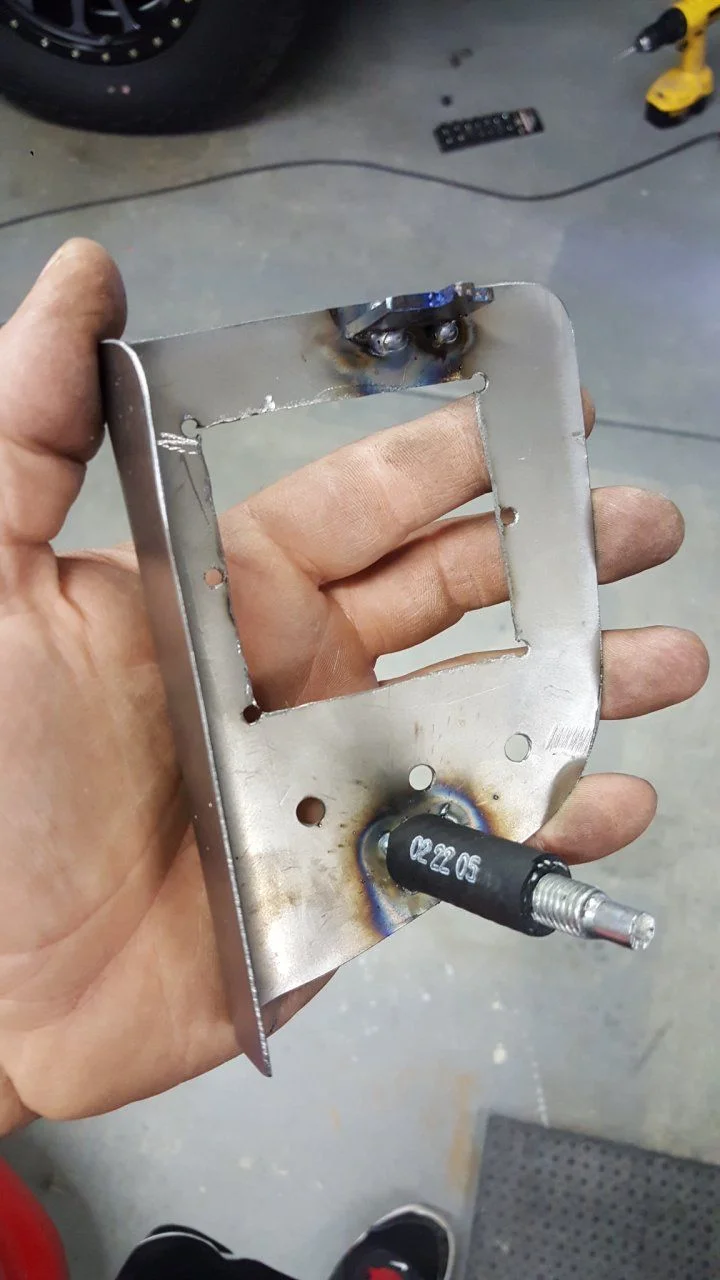

I made an outline of the shape of the factory reflector lens and transferred that on to some stainless sheet metal. I made sure the led cube lights would fit in the existing hole without major trimming, and they did:

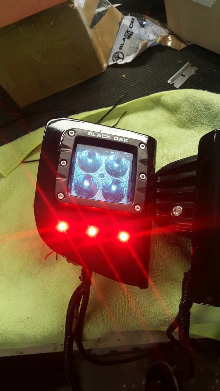

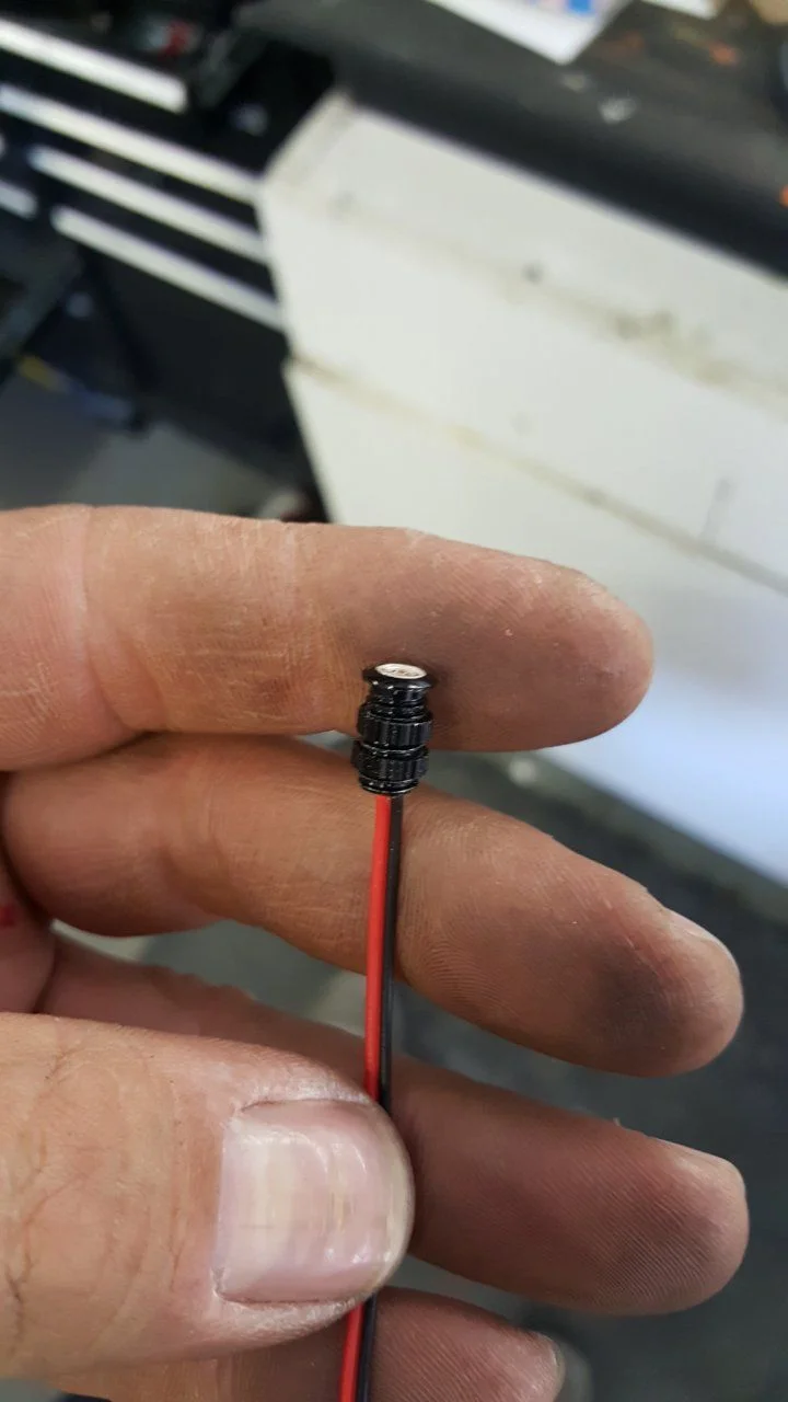

Added some small flush mount led lights below the LED pods to act as marker lights (wired to taillights)
Back side mounting (version two)...
More excellent work, Yoats.
Lookin good. I'm impressed with your fab work.
Anytime you wanna come to Long Island and grab my cruiser, have at it. You have skills my friend, Very nicely done. Love those rear lights, great fabrication. You have talent.
Any plans to fab some more of those rear lights? I'm sure there's a few guys on here that would be interested in buying some. I'll be first in line and have $$$ ready! Great work!
Awe, thanks man! Next time I am back in NYC visiting my family I'll hit ya up! ;-)
Thank you also. No plans, there were a little bit of bugger to make (like a tv show, not as "easy" appearing online, lol)

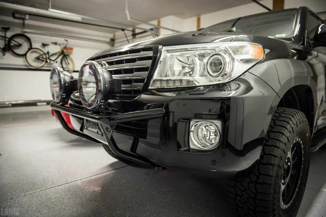

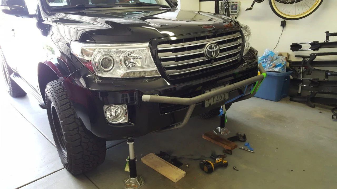

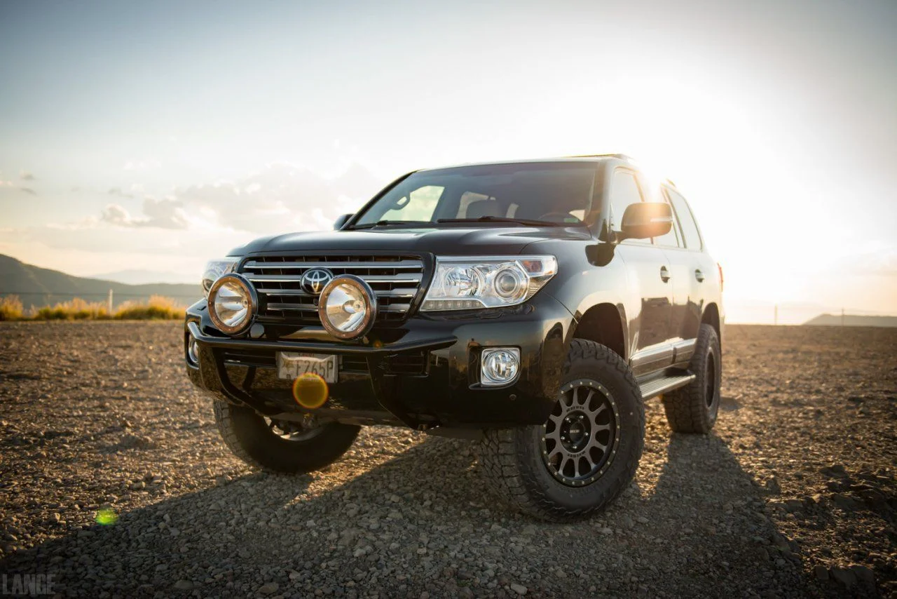

Quick update on my front light bar creation I finally finished. Had some house projects get in the way of the Cruiser!

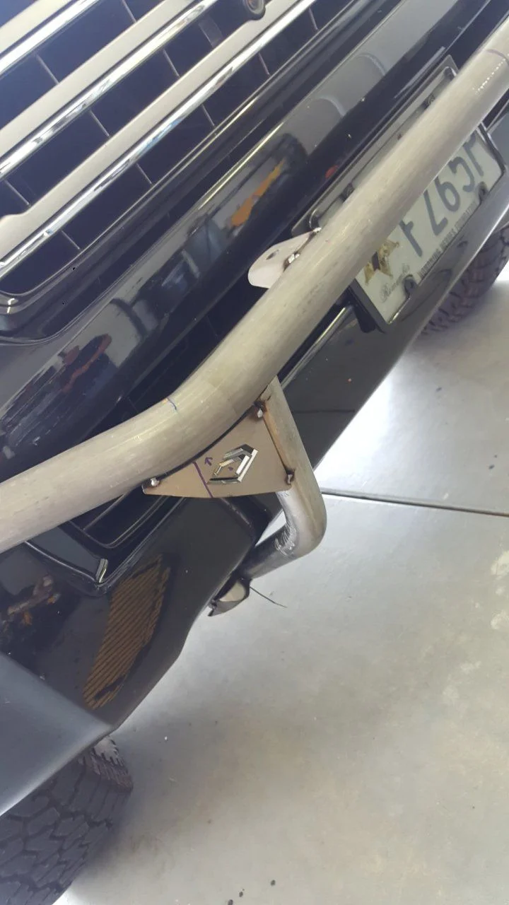

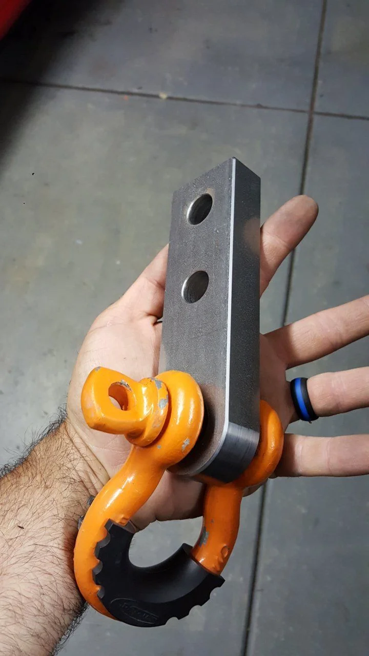

Anyway, I mentioned this in the "what did you do today" thread, but I came across these bad-boy's on Chassis Unlimited's website. They are 1" thick and made for a clevis (or D-ring). They have two versions, a "blank" unit (still comes with the larger d-ring hole, just not the other two holes), or a unit with the 2 holes for mounting. The holes are 2" apart. I bought a set of both and the pre-drilled units fit the 200 just fine. Best part, they are $24 each new for the pre-drilled, or $19 for the blanks. I ended up welding my lightbar creation to these.
I also purchased some cool tabs & gussets from Chassis Unlimited. Love this place (first time I found them online).
After the finish welding and cleaning up, I primed and then broke out the paint gun shooting it with some single stage gloss black I had laying around. I had some cheapy 10" HID lights laying around for a year or two so I mounted those up there for now. Not sure if I will keep those or go with the ARB LED rounds, or some trusty Hella EuroBeams. Lightbar is nice and solid. And just to reiterate, this is nothing more than a lightbar; I did not engineer it as anything else. It serves it's purpose well for now. :)
Took it up to a local canyon that overlooks a copper mine this evening for some better photos.
