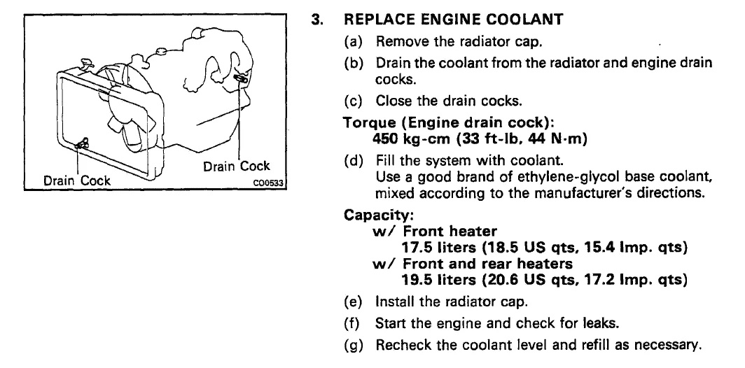

I"m pretty sure there's a block drain as well. IIRC when I back flushed my '88, I made sure that drian was open to get ALL the old coolant out. Just doing the radiator doesn't get it all.
This will help you locate the block drain:
Yes, I guess I will try to find that drain as well.

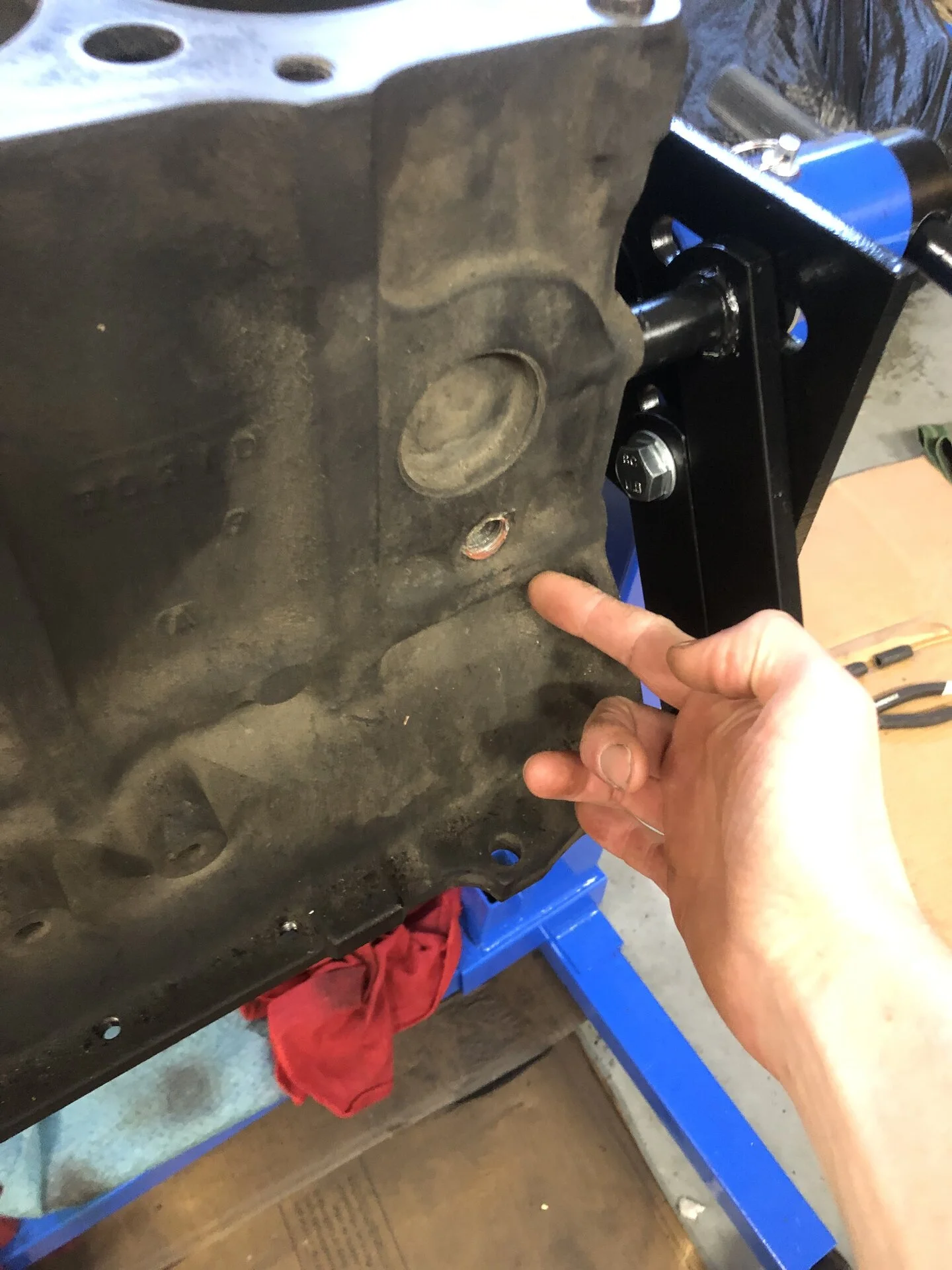

My engine is out of the truck and the petcock is removed but it lives here in the back of the block under the last freeze plug.
If I recall it’s a 17mm. Maybe 14mm? You can reach it from beneath the truck. You may have to remove a heat shield if you still have those installed. It’s been a while since I’ve had mine on and I don’t remember if it blocks that drain or not.
