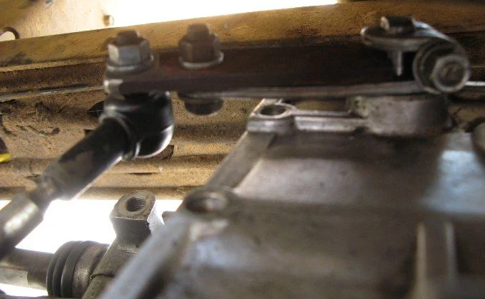

The stock linkage is a Rube Goldberg contraption that is prone to wobbling and to not engage/disengage positively after 30+ years of use. When I installed a new professionally-built Orion case in mine, the shifting detentes were a little more stiff than the stock case, and the shifting arm on the stock linkage bent so badly (because of the angle of pull on the stock linkage) after one season of wheeling that it wouldn't shift out of low range any more:
Twin sticks provide a straight, direct linkage to both the shift points on a single case, making a much more positive engagement/disengagement. They totally fixed my Orion shifting problem.

I extended the arm and cleaned up the detents some. Works fine now. 30% less effort required to shift with this simple mod. I actually painted it after this picture was taken.

It seems like removing the gate also removes an important brace from the shifter mounting stud. It's a grinder cut and bend and you can put it back.
That's what mine looks like! Getting that straightended back out before the new T-case goes back in. I fall into the "no more levers" category though, so I wont be twin-sticking my 40.
Feel free to steal my lever extension idea above. Seems to work great.
