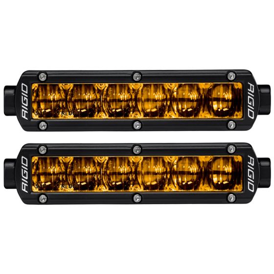

Does anyone have experience with these new DOT/SAE J583 fog light from Rigid Industries

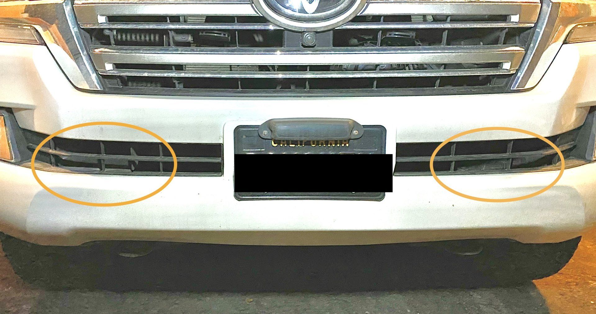

I'm thinking about placing them in the space circled in the last pic, though it would take a little trimming of the plastic grill supports:

Does anyone have experience with these new DOT/SAE J583 fog light from Rigid Industries (https://www.rigidindustries.com/sr-...ctive-yellow-surface-mount-pair-906704.html)?
Well the square RIGID led fog lights seem to be very good at being a true fog light, so I would assume the light-bar configuration would be about the same? They are both DOT compliant so that is good :). I also came across this brand as well but I dont think they make a fog light bar. LED Pods
