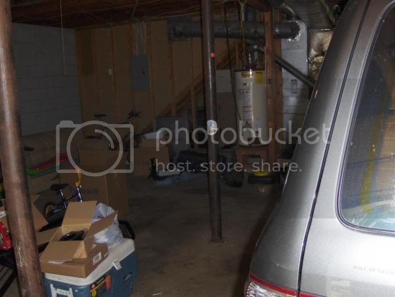

weeeeee
Oh...I thought you had a urinal in the corner.
I don't have 9 foot doors...but I do have a valve stem tool and a compressor :)
I deflate the tires, roll in, then inflate.
Agree, not enough boxes, tools and most importantly evidence of rare or cool parts other people would want you to part with - I'll wait a decade and let you repost to see if it's improved....
All the good stuff is tucked back in tthe workshop to the left of the Avocado :)
Obviously, there isn't enough good stuff, you can still get 2 cruisers in there. Reference Marshall's garage as a good indicator of enough quality stuff :D
All the really good stuff is already on the trucks, no point in letting it rot in some garage :)
