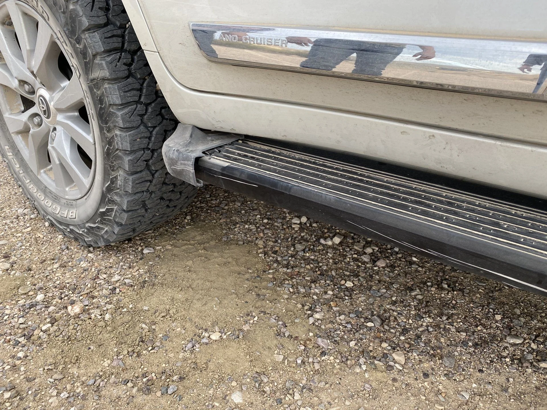

OR, if you're like me and love to take the wrong line due to incompetence, then you can damage the running boards over easy trails......
7f7eaae7-825d-49f6-a582-f07850142695-jpeg.2144515
Same here. I destroyed my running board on a tree root by taking a bad line. No rocks where involved.
