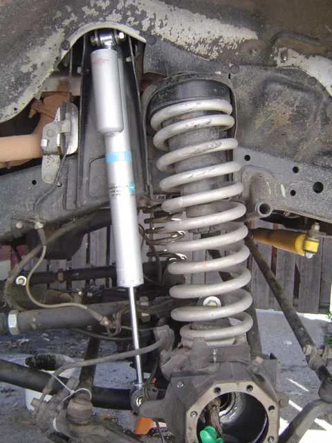

I did new front control arms and went with custom jionts (jimmy joints) rebuildable and super slick, with bigger bushings. It wasnt all about flex as much as pinion angle and lift amount. here is a pic..... mine flexes welll and you always seem to want more but i dont want to go any higher......

Are you using a typical radius arm setup w/ 2 y-arms? I'm familiar with Jimmy Joints and have used them before. I don't see how you alleviated any bind from the suspension with this setup. In order to eliminate bind w/ y-arms you have to remove one of the legs from one side..... That's how my Jeep was.
Perhaps I misunderstood the pic....

Hey sickboy, is there anyway to get a better pick of your radius arm mounts? You know, just a couple of pics of the fabbed suspension.
I can look and see if i have a better pic...... may have to take another.......
It is your typical Y arms set up (although its adjustable), the arm is longer than stock wich gives a little more room to twist without binging..... I definitly do not have the "flex" as shown on Bens old ride but they have turned out well for me. My caster/pinion angle is back to stock, I have more "flex" and its enough..... I am done pushing the limits of my 80 for now as i am pretty happy with where its at.
