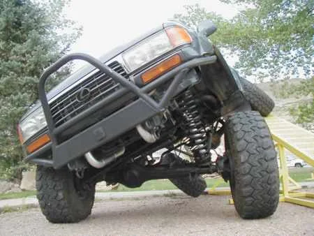

Anyway, you can see by this pic of the front axle, it's been modified from a 3 link to a 5 link...
I think someone should experiment with just removing one of the 4 bolts holding the control arms to the axle and see how much that opens up the flex(not necessarily while wheeling, a ramp would be sufficient for measuring it's effectiveness I would think).

Take away 1 of the bushings on 1 of the radious arms and the 80 will flex great , but the lone arm an the other side will have to hold the axle from rotating all by itself.

This is Ben's old truck. Converter to a 3 link in the front with longer shocks. The 80 series arms with the two bushings on the front (doing the work of two arms) is that kills the articulation. The arms are trying to tear the mounts from the axle when it articulate. If you examine the suspension from a birds eye view it will become clear. One side drops out, the arm effectively becomes shorter and the axle not needs to sit at an angle..
The arms with the rotating joint took some torsion stress out of the arms, but they did not solve the problem 100%.

Well, bring it to Golden and we will do it. Articulation is not the end all do all. See pictures on the bottom of the Gigantor page. I will put $5 on that it rolled due to the suspension unloading when climbing those steps. Nasty side effect of making an 80 with gobs of travel.
Anyway, Bens was made with custom links. Converter to a 3 link with panhard. Long shocks and no swaybar.
