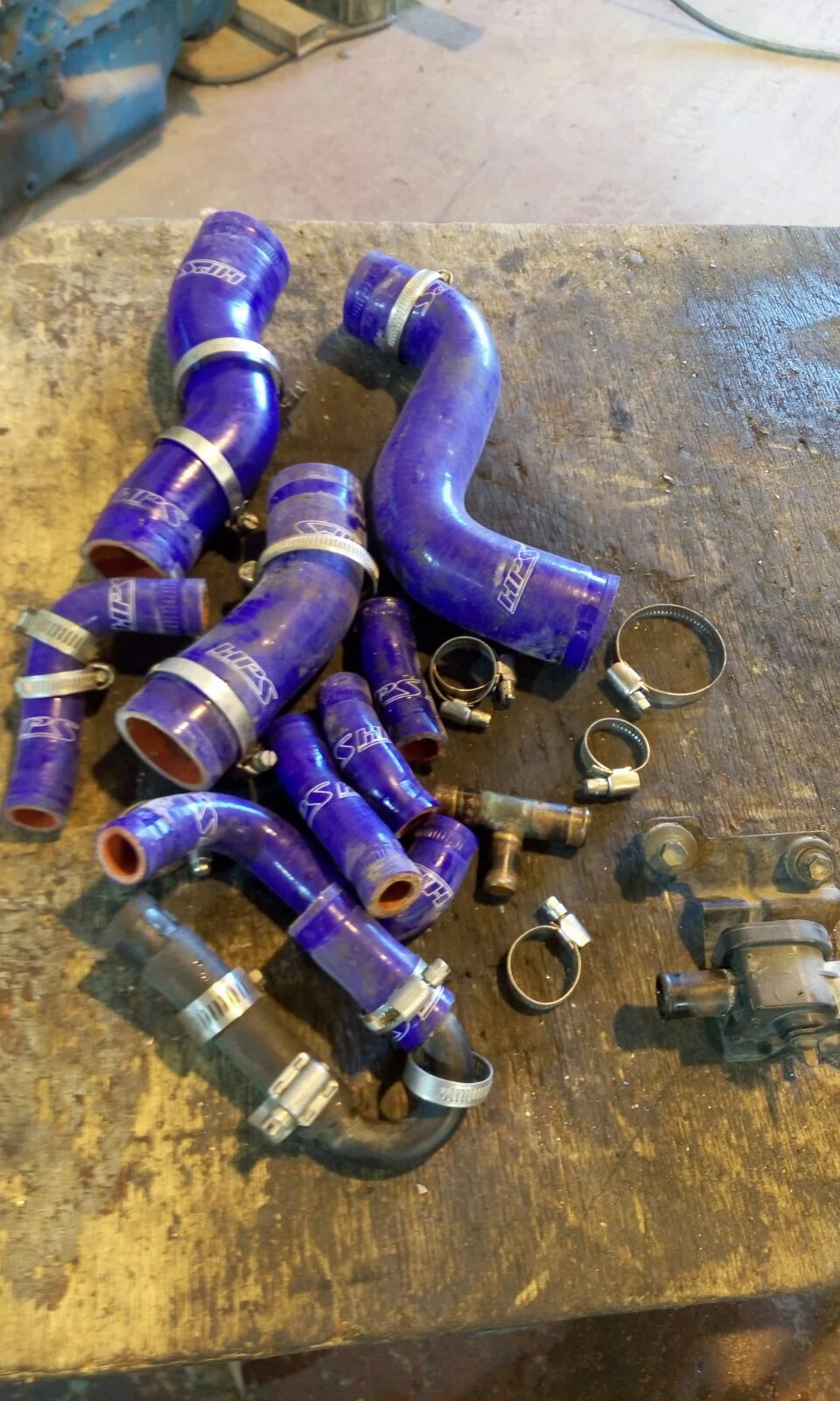

I had a full HPS silicon kit installed
The main radiator houses got deformed after a 2 months
I pulled it out and installed all OEM and Gats green stripe with constant torque Breeze clamps
NO PHH I replaced it with long bay pas with Gats green stripe
This kind of experience is what I was curious about.
out they go
