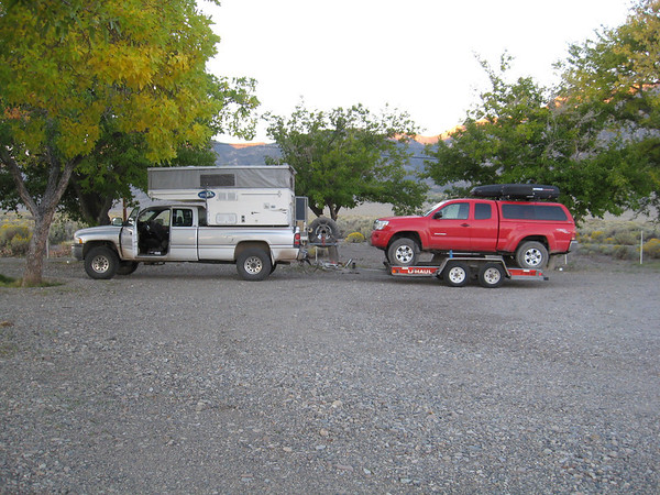

Saw one of these explode while we were out in the tule's. Extraction involved removing the RG on a steep snow/slush covered hill, limping out backwards down said hill, and then a 500 mile ride on a Uhaul trailer followed by an 875 mile bonzai run for the tow truck to get home in time for work. Word came back from the owner that he was told by the dealer (who fixed it under warranty for free) that it was a known issue, that the heat-treat of the gears was not done right & made them brittle.
Carvers Jct, NV roadside rest:
