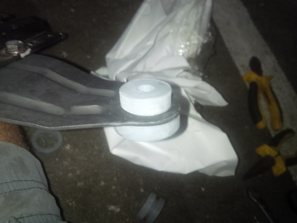

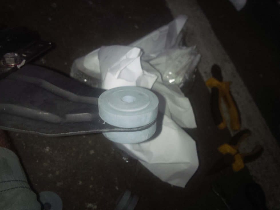

Hey Dan, if you really want to isolate vibrations, the grommets don't do that much as it'll still pass through the bolt from body to mount. Check out your oem radiator, air filter and wiper motor mounts for how to do it. You'll need some 2-piece rubber bushes. I couldn't get any where I am so I had a rubber manufacturer make me up a lot of 100 for all my non-oem mounts. When I get home can post pictures if you like (there's one buried in my build thread somewhere near the intercooler install).
Edit: found the post with the rubber photos

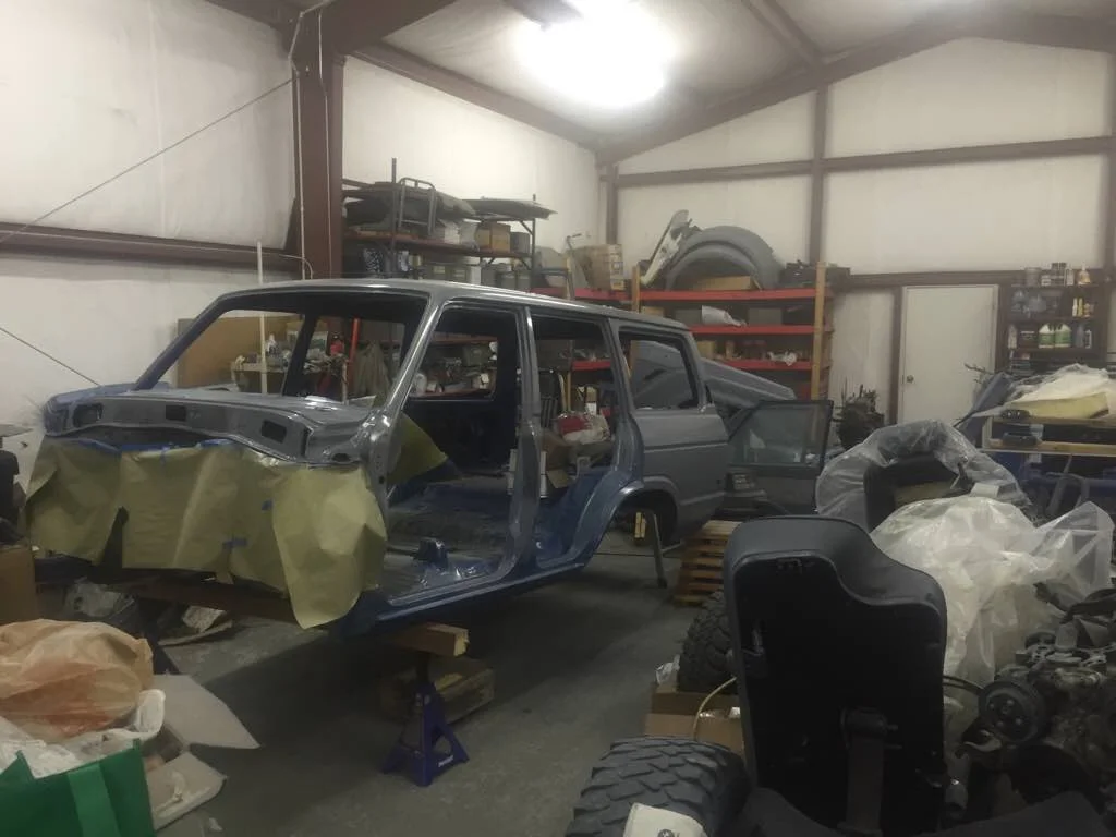

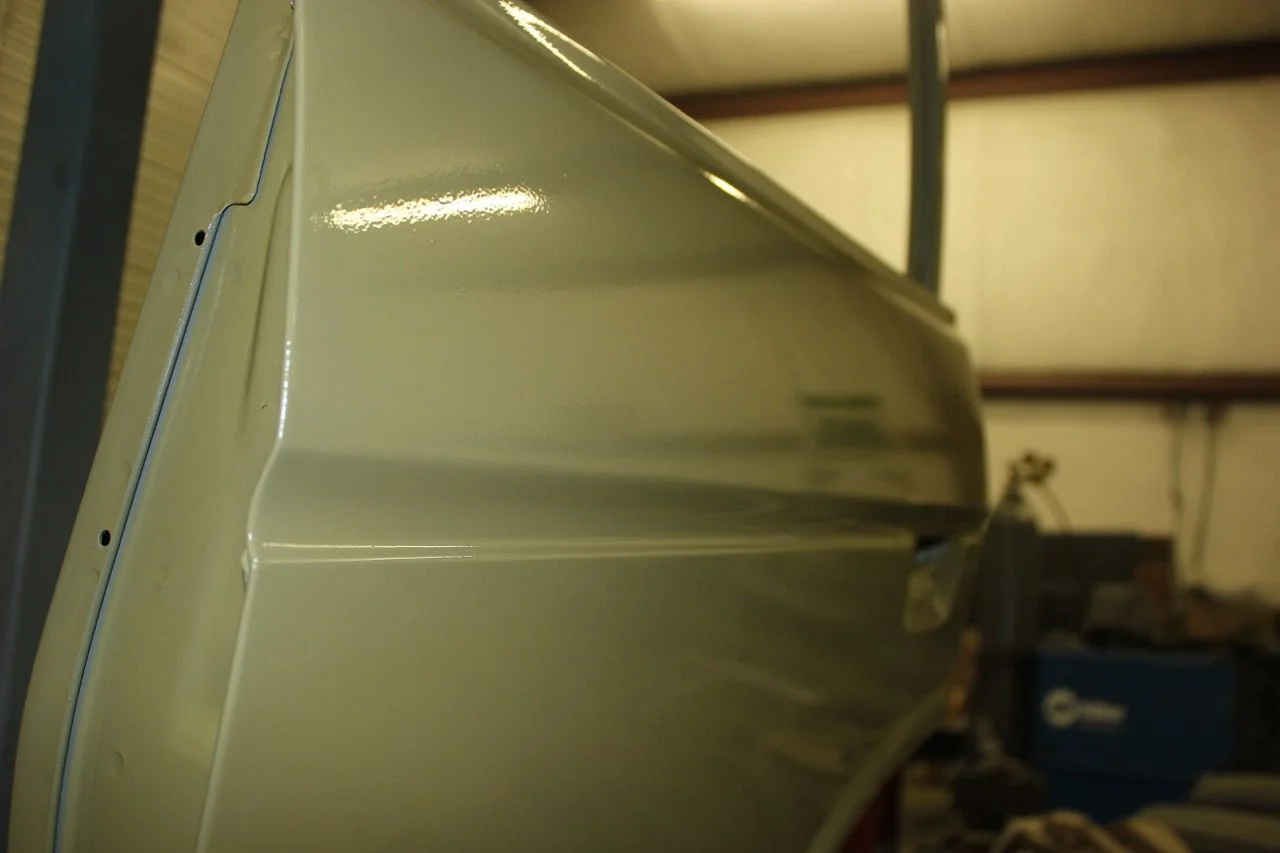

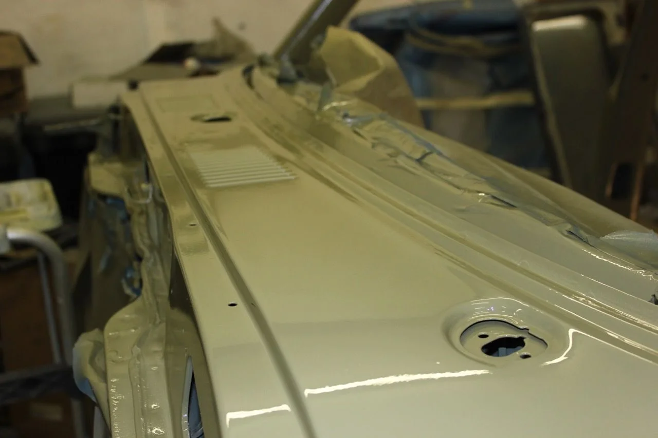

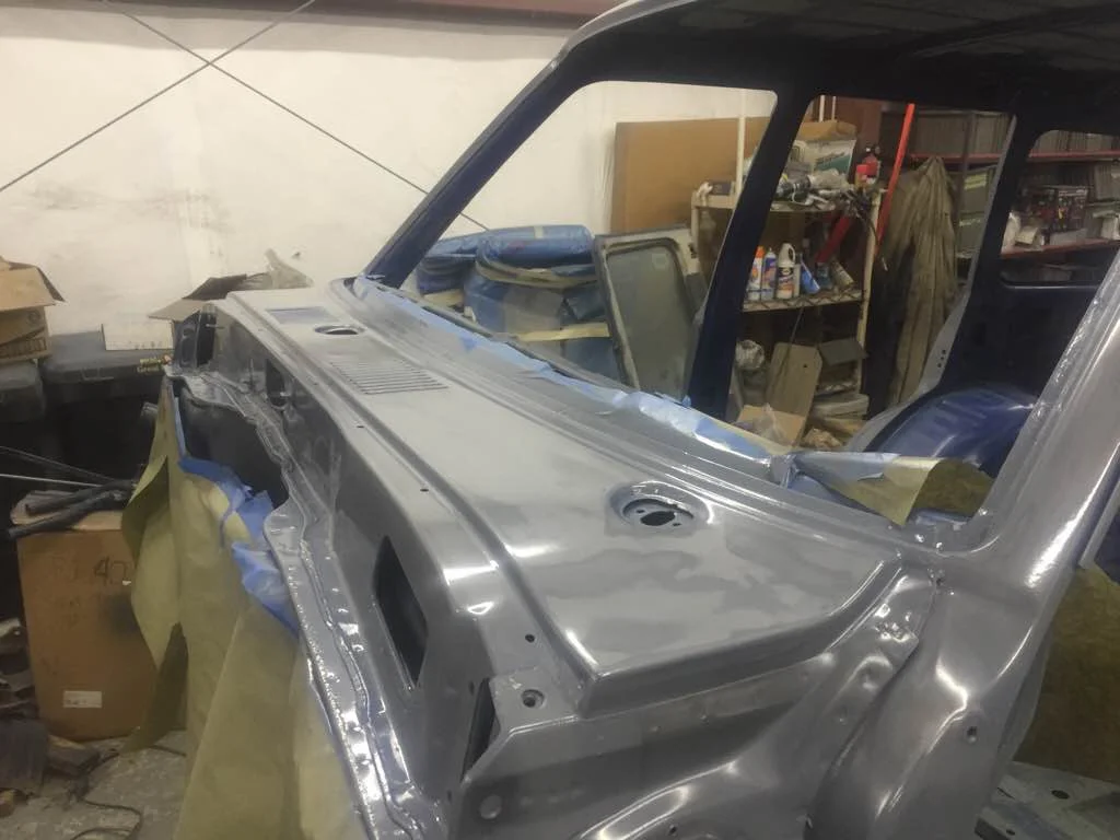

After a marathon day of sanding with Mom--the entire body (well, exterior at least) is in primer!
It's just the first coat of epoxy primer. Tomorrow I will give it a second coat, and then I *should* be able to spray the 6L4 in the afternoon!!

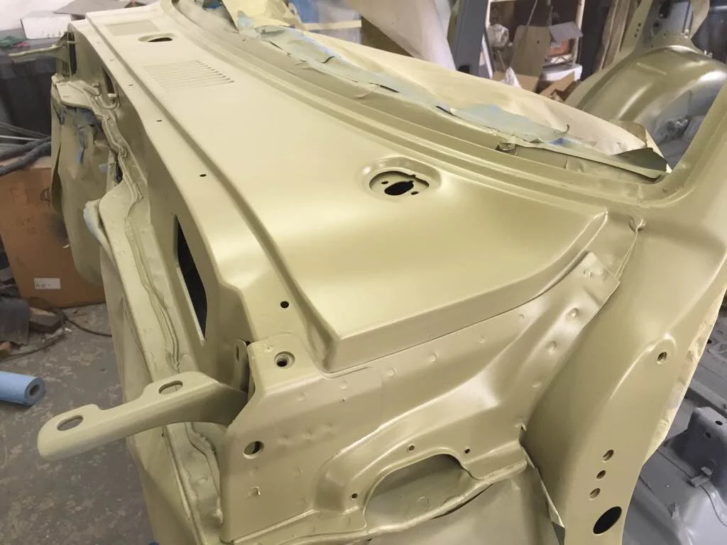

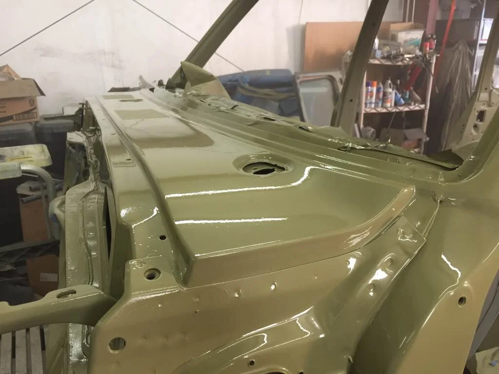

Screw the primer! 6L4!!!

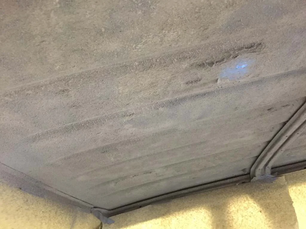

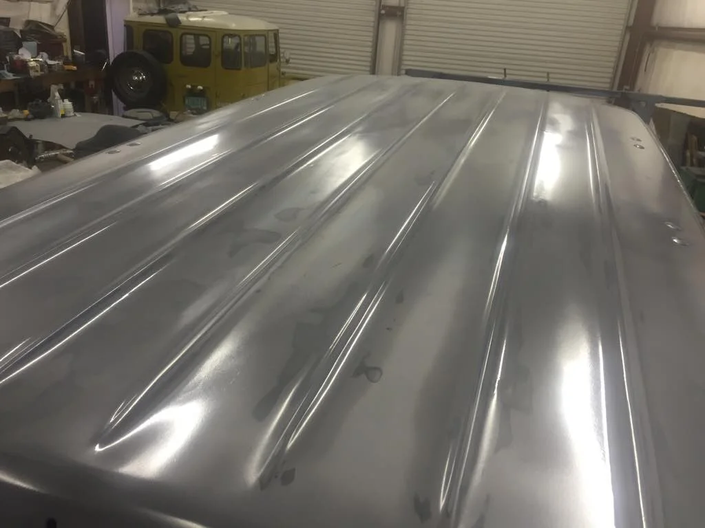

I also put the first coat of eastwood's thermal and acoustic barrier on the roof. Not sure my stutz gun is working right, but....

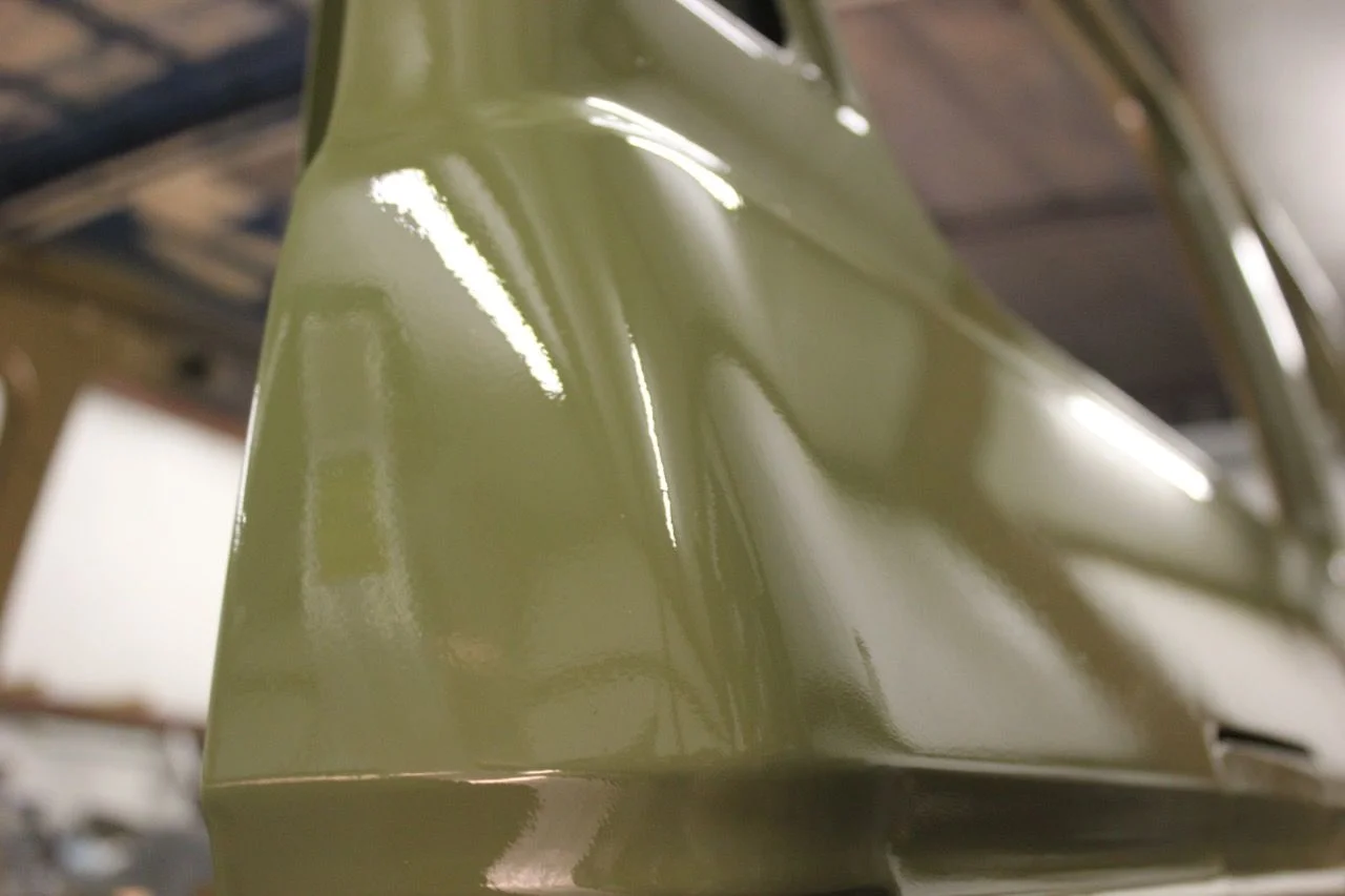

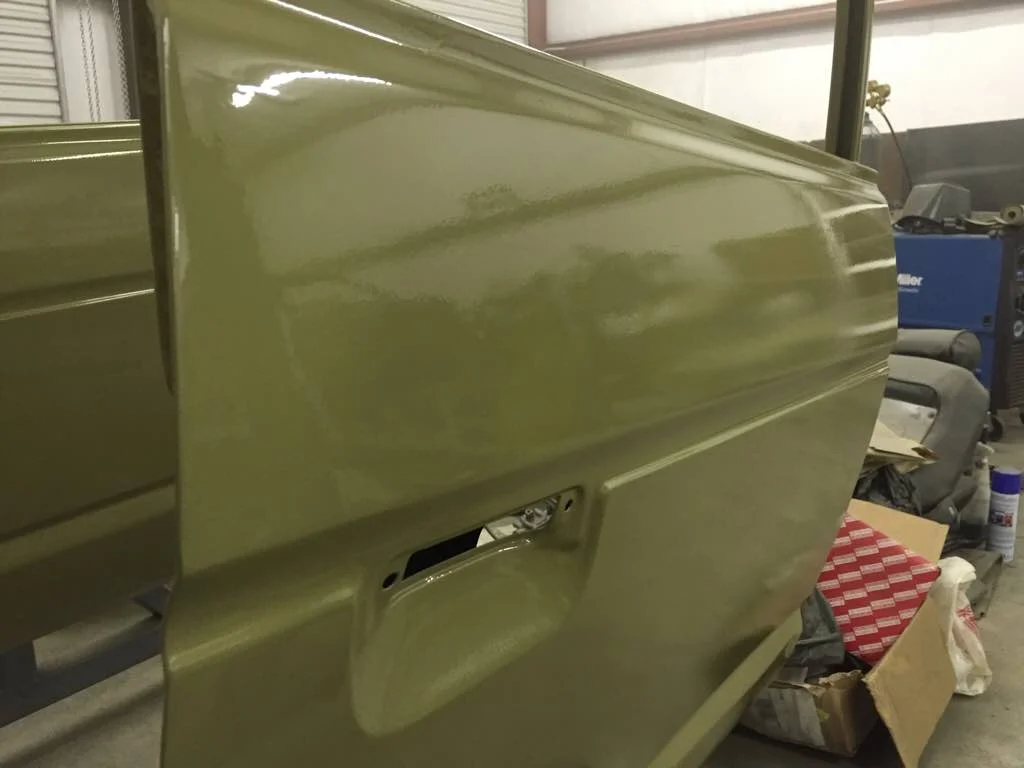

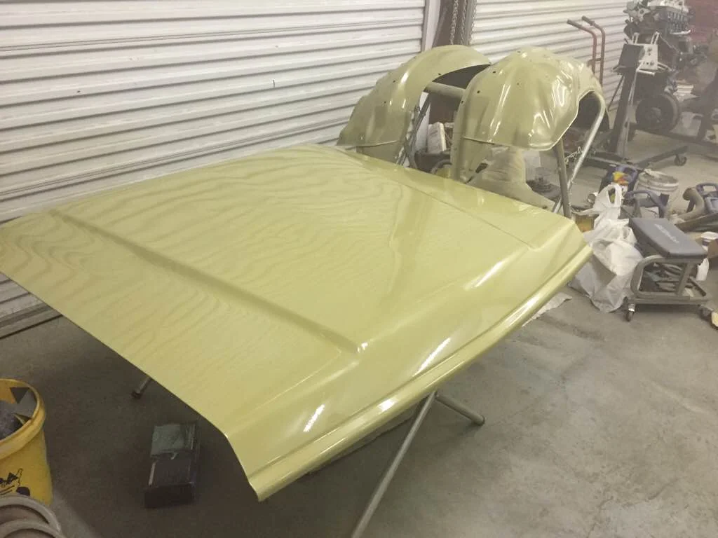

Screw the paint! Shiny 6L4!
I'll let this cure overnight, then sand any defects, and give it one last coat of clear in the morning.
I am a VERY happy boy with how it is turning out.
Dan
You need a new hood insulator: 53341-90A00
I've been thinking the same. Kind of a shame to cover up that beautiful green, but probably more awesome to know that it's shiny underneath the insulator!

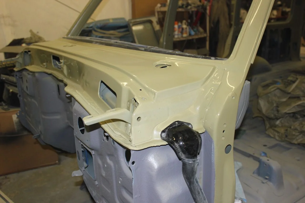

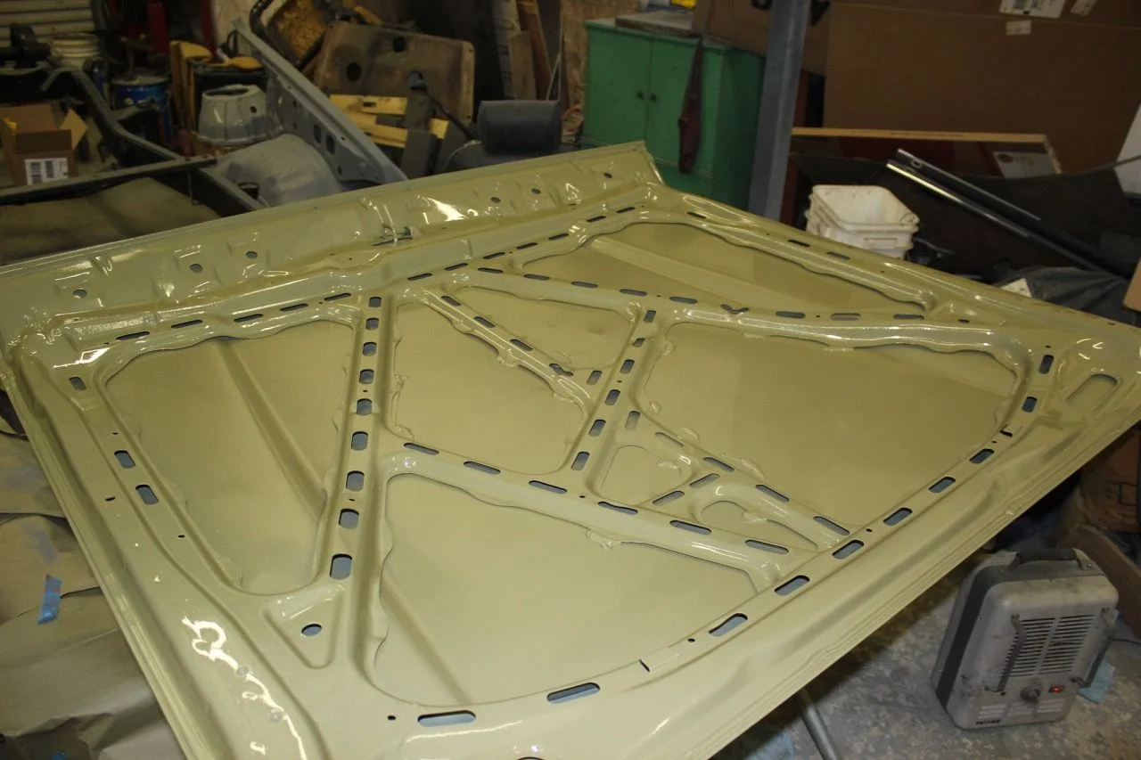

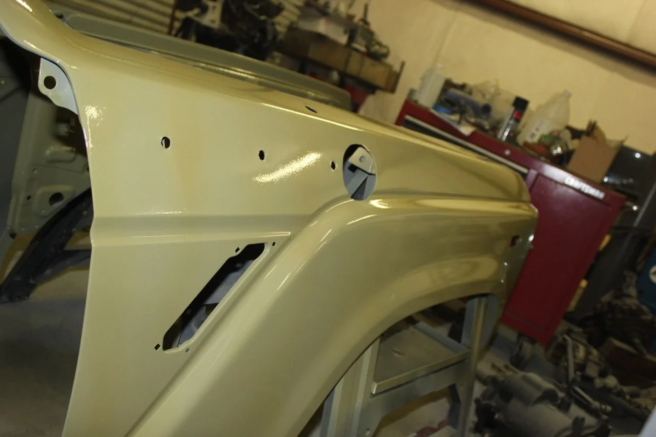

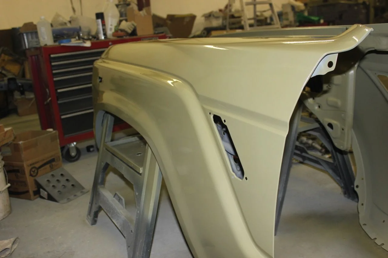

The rear doors, hood, fenders, inner fenders, hinges and a bunch of bolts are now painted, and the clear is drying as I type this!
Unfortunately I have to head back to work tomorrow. Pretty long stretch, but then I've got wheeling plans after that--so it won't be until mid December until I can get back to it.
Hopefully the weather cooperates so I can paint the remaining pieces next time: lift gate, tail gate, front doors, front core support, and front valance.
Dan

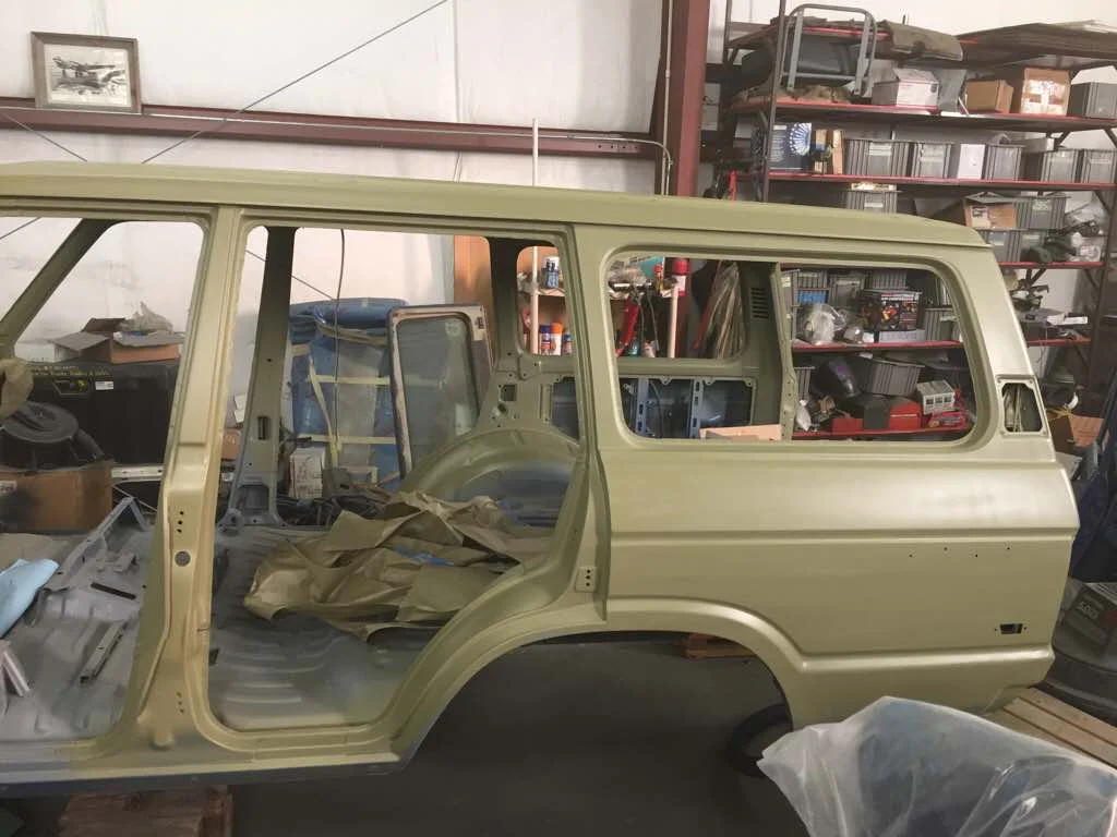

So here's some better pics...
The painted stuff. (either I've gotten better at painting, or I got better at taking pics of the pieces)
And just for fun I pulled the masking off of the body. The Medium Quartz (IIRC) Monstaliner looks awesome with the 6L4! Which is good, because the lower trim line will be "painted" in the same Monstaliner, and I think the colors look great together.

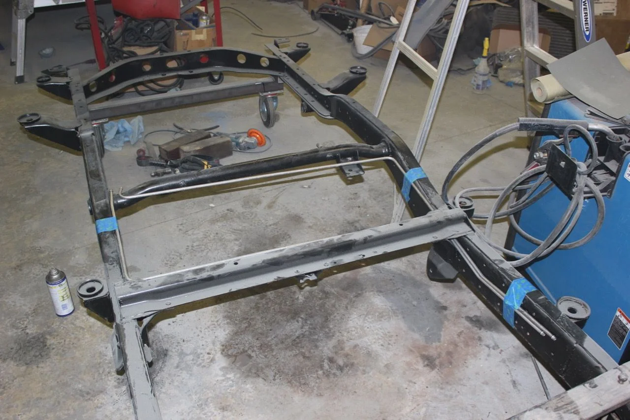

While I waited for the paint to cure, I bent up some of the new fuel lines. These are 10mm lines--to match the 1HZ's inlet hose size.
The 1HZ has a fuel inlet on the left side of the engine, so this routing should move the fuel lines to the left side, and keep they away from hot exhaust. I went with aluminum lines, but they will be well secured so I won't worry about work hardening much at all. Yes, that is two fuel lines coming from approximately the same spot. One line comes from the stock fuel tank, and the other comes from the aux fuel tank. The selector value will be mounted to the framerail right where they terminate in this pic, and a single line will continue to the engine itself.
I need to order some matching 6mm lines to fabricate the same routing for the fuel return lines too, but I will get to that when I get to work on the truck next. You can see the nice beaded ends on the fuel lines? Oh baby that kind of detail makes me happy. I also have matching Viton fuel lines to connect all of the metal lines together. (Viton, BTW, is pricey stuff, but someday I might be running pure bio, or WVO or something, so now is the time to replace the sofa lines with Viton)
