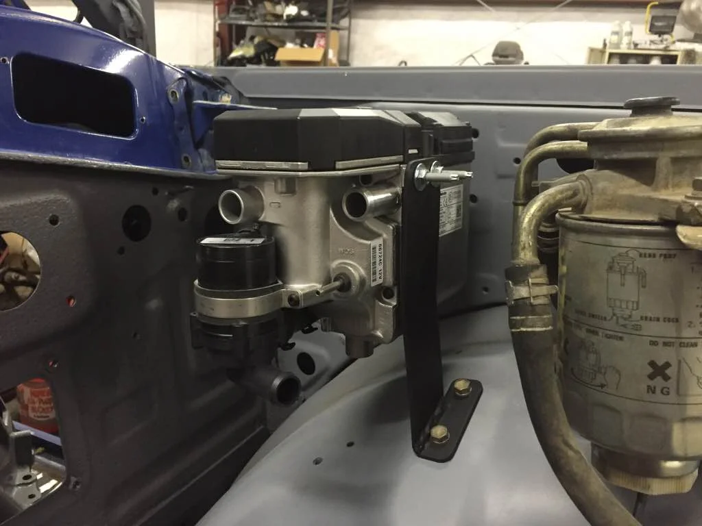

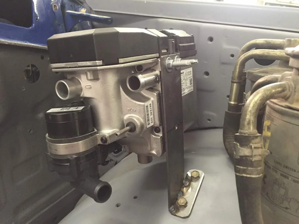

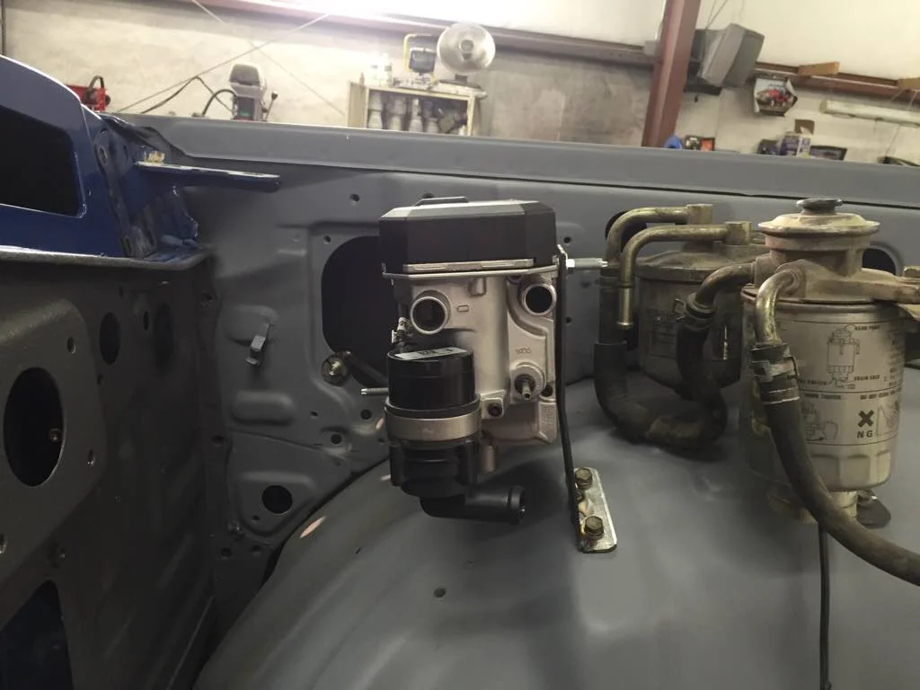

First thing was fabricating a little bit....
Yep! A Thermo Top C!

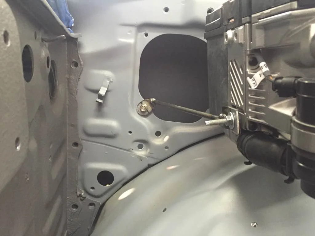

And finessing the brackets to hold it right where I want it, and then powder coating them in satin black....

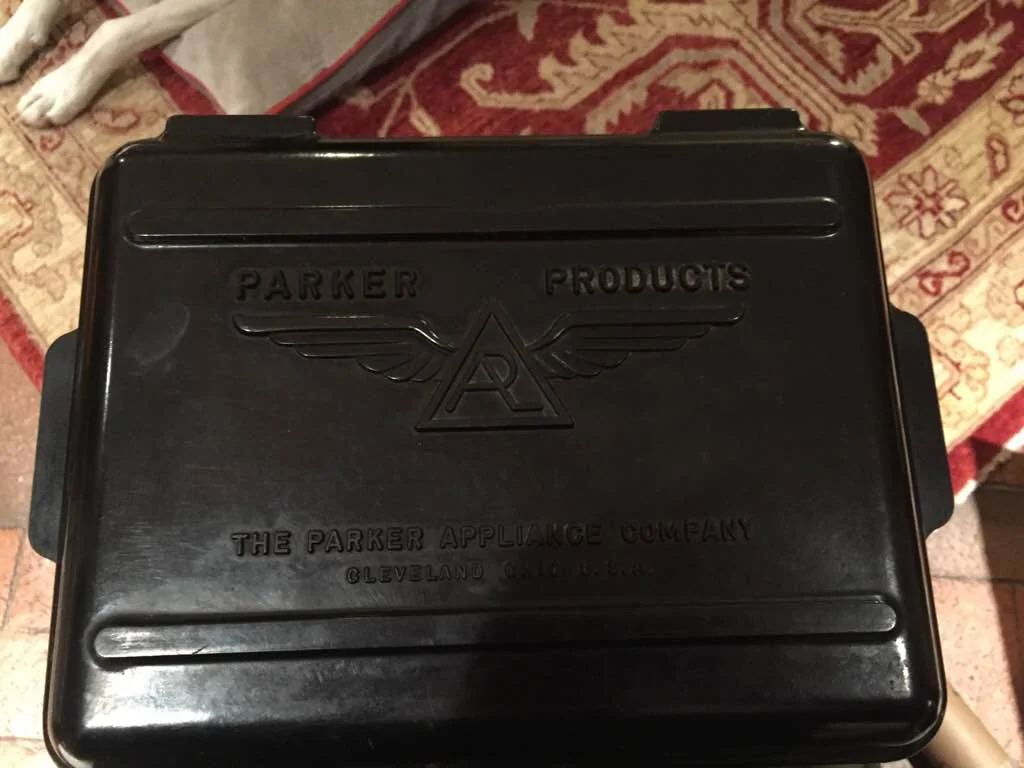

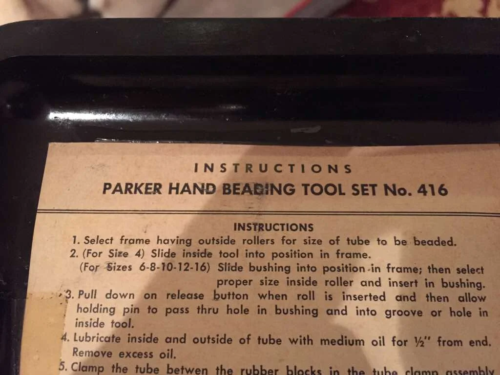

It always bothered me to have plain fuel lines, so I got serious (and stupid) and bought a Parker 416 beading kit.

But the finished product will be worth it!
So much more Toyota-ey than just clamping hose onto the metal tube. I might have to take the Blue-Jay 42s fuel lines apart just to add beads to them now. :)

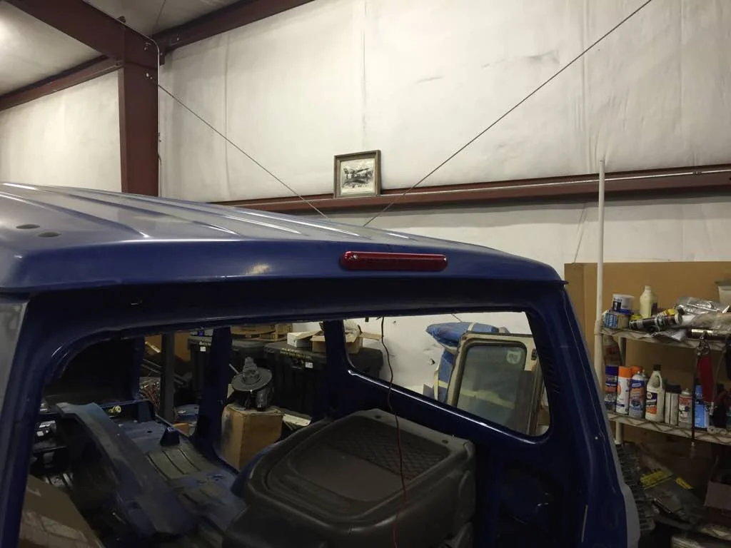

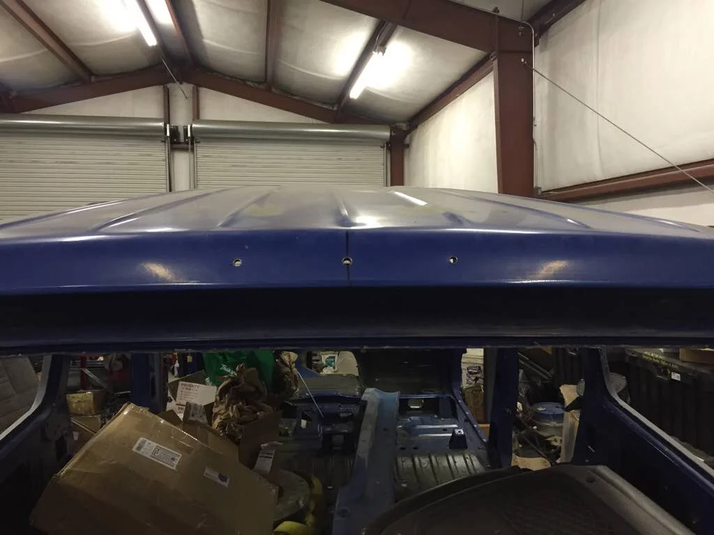

Also, I decided to add a third brake light. Originally I was going to mount it on the upper hatch, but (after drilling the holes :grrr:) I realized it would hit the drop rail, so I mounted it on the body, above the drip rail.
Nice work Dan, but have you thought of mounting the webasto with rubbers instead of direct to the body? I always get paranoid about mounting complex parts without some vibration protection from the 1HZ. It makes for more complex mounts but good for longevity IMO. Just a thought, I'm sure thousands have had no trouble without it.
Not hard to toss some grommets in as bushings if needed.
I like that idea. I will get some rubber grommets tomorrow.

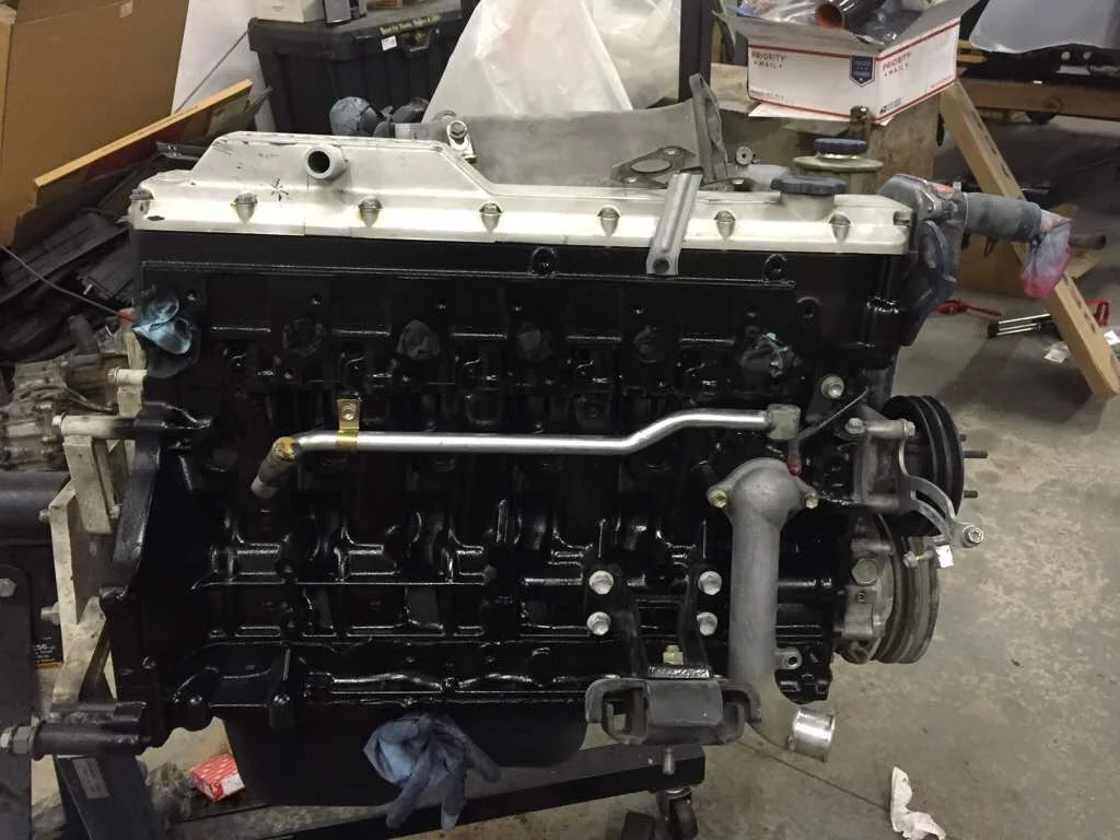

I did get this side of the engine cleaned up and repainted. Looks much better.
