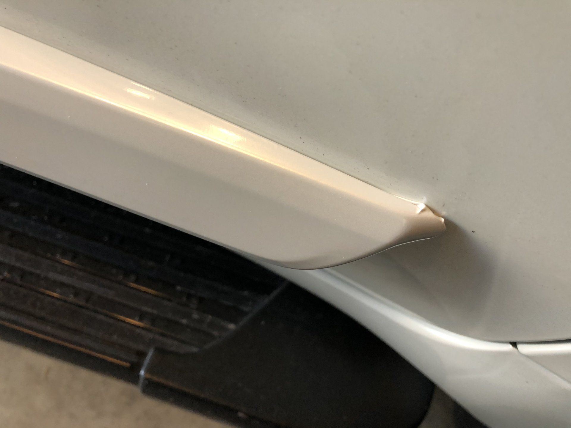

Had a minute to try my hand at vinyl wrapping my chrome door molding last night. The vinyl is a perfect color match to the blizzard pearl, so really pleased with that. However, my workmanship is garbage and wrapping the corners was really challenging. If it weren’t for the fact the chrome molding was already ruined I’d probably rip the vinyl off. I’m still a fan of the white on white look though and am thinking a professional install may be worth it.
I really like this and may now be sold on the blizzard pear side molding. Wish I had the extra cash and lived closer to @Eric Sarjeant to have him do it correctly . Maybe I’ll wrap the side molding and then rattle-can the front and rear chrome pieces matte gray. I was thinking of going black in the middle of the front grille with matte gray surrounds and wings. BTW, here’s the state of my chrome currently. Those blemishes will NOT come off!

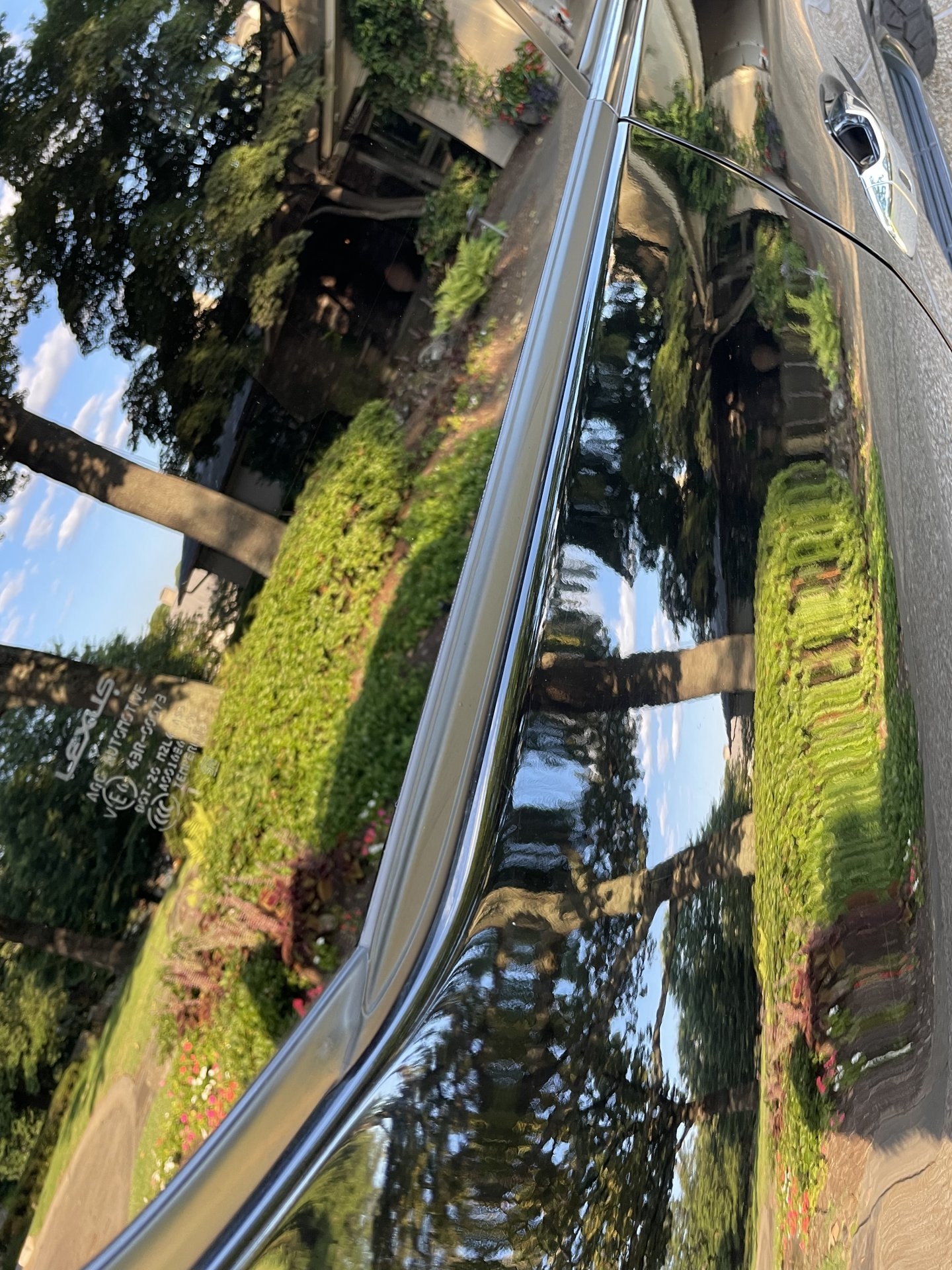

torg82, am a fellow Boulderite that is seeing the same issues with my LC200 chrome. I have replaced the hatch "Land Cruiser" chrome, but not yet replaced the side door trim and rear light chrome. Have you found any solutions to remedy the tarnish on your chrome. Groove Toyota suggest a Meguiars chrome polish, but I have yet to find anything that will solve the pitting and stains on my chrome. This Colorado Mag Chloride is brutal on our cars....and I wash mine regularly!
@HighRanch , I suppose this is the way with anything in life; but my I've lost the initial motivation to get it fixed as I've grown used to the look. I'm still interested in fixing it somehow but believe that there aren't any products out there that can fix this. I think a replacement is the way to go. Although, I was quoted $3k+ to replace all the chrome. I was starting to go down the path of just plasti-dipping it but haven't had the time. Was able to take it out w/ our new camper this past week. Towed like a champ over the Gemini Bridges OHV trail.
Found a polish that I would recommend trying…
