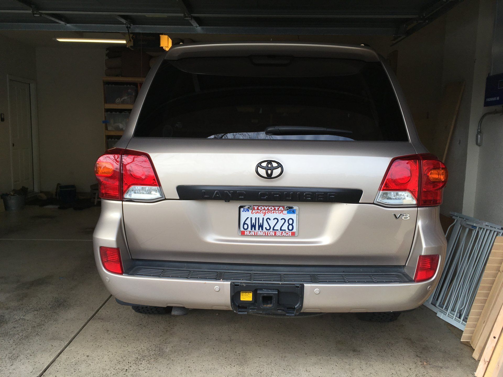

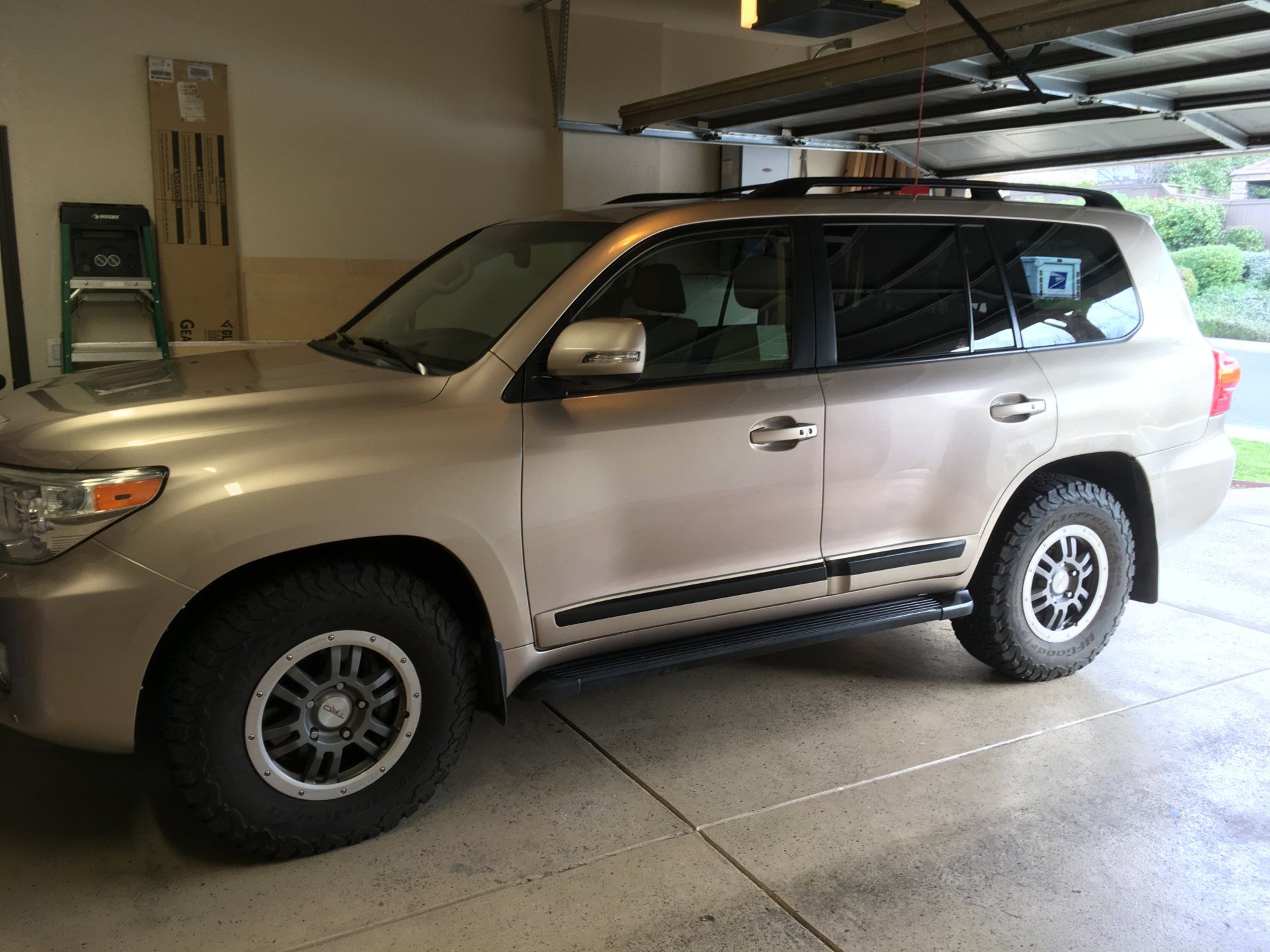

Here are some shots:
That looks bad ass on your gold paint.. Gonna have to try that out on my white.
Thanks a ton for posting those
A few notes:
The gray i used was called “3m matte metallic charcoal” from the seller vivid creative on amazon. It’s 3m 1080. I ordered (4) 6 inch X 60 inch to do the back and side moundings.
Use a mitten to apply and 70% isopropyl alcohol to clean. A heat gun and sharpen blades are a must.
