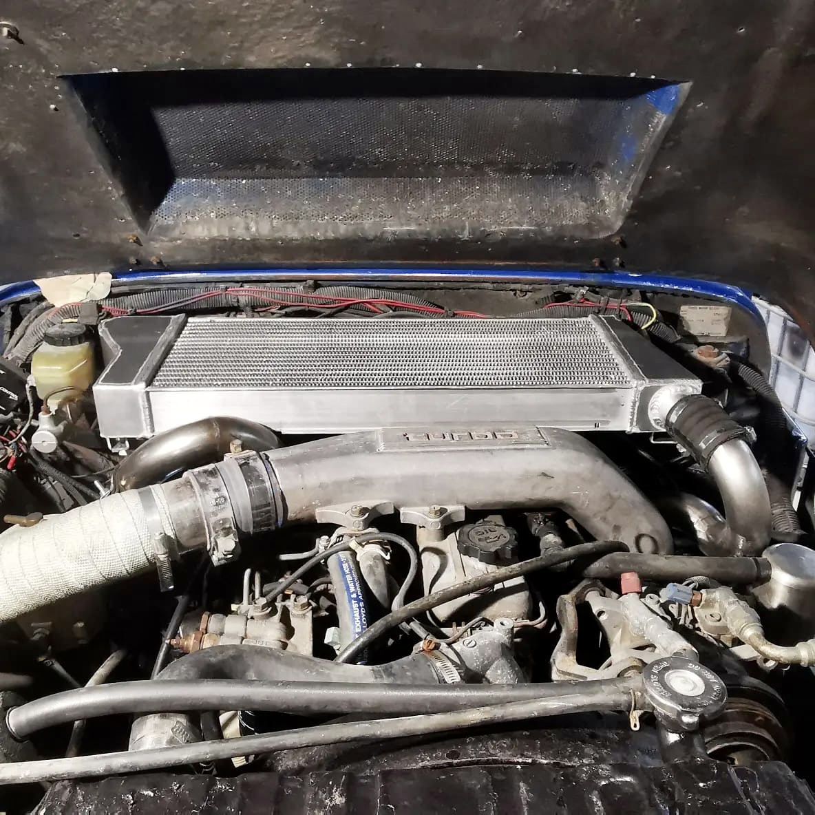

Yes my fuel is tuned up, Gturbo, 3.5” down pipe, over the top inter cooler with fan, radiator fan, etc.. My 12ht has done me well over the years. For sure it has not left me stranded. And seems to be doing great pulling this amount of weight with the gear reduction. Except for the long waits when i am in remote areas i have not had much issue finding parts for it. What I am doing here is just trying to understand my options, keeping the 12th is one of those option. Thx
