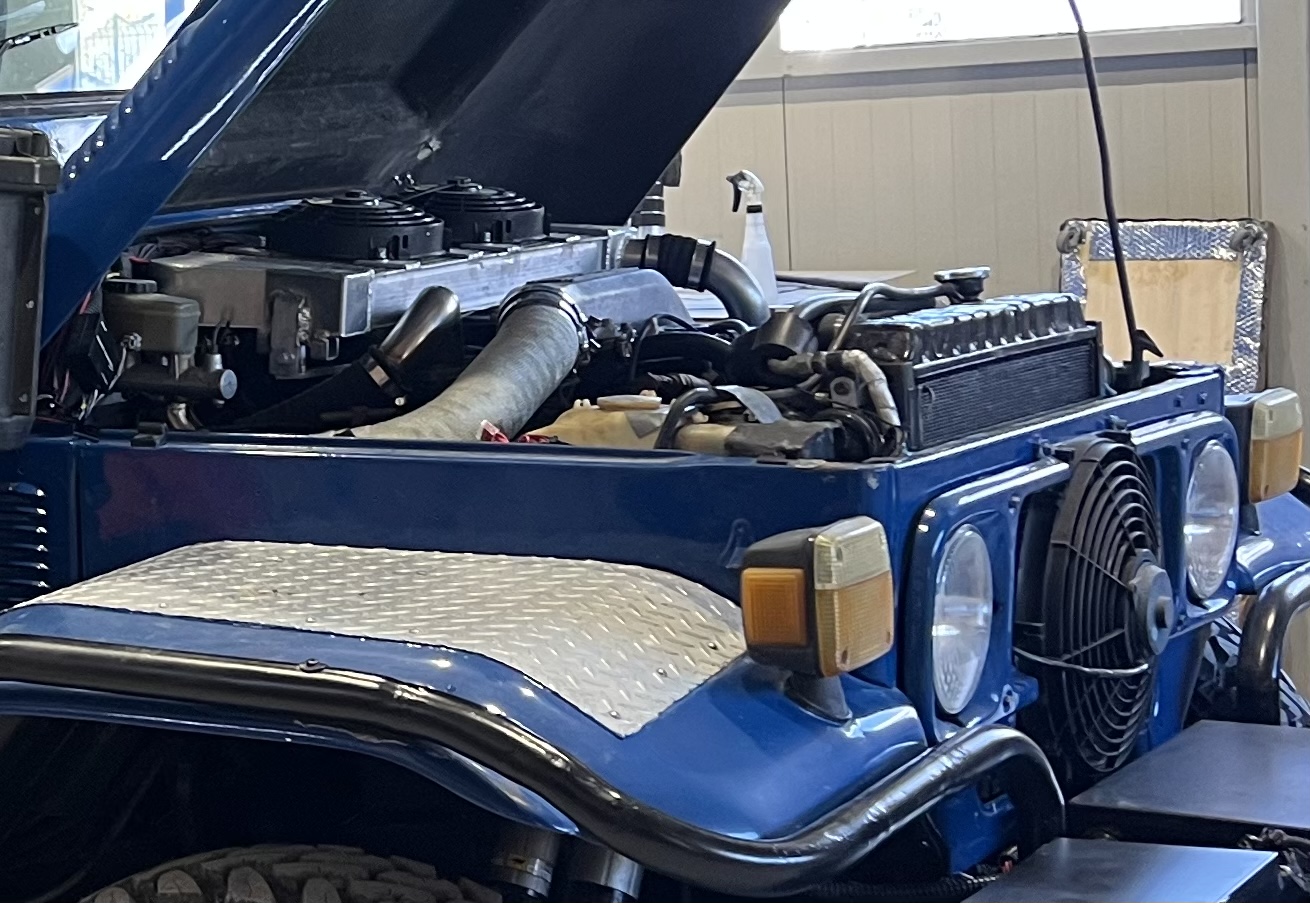

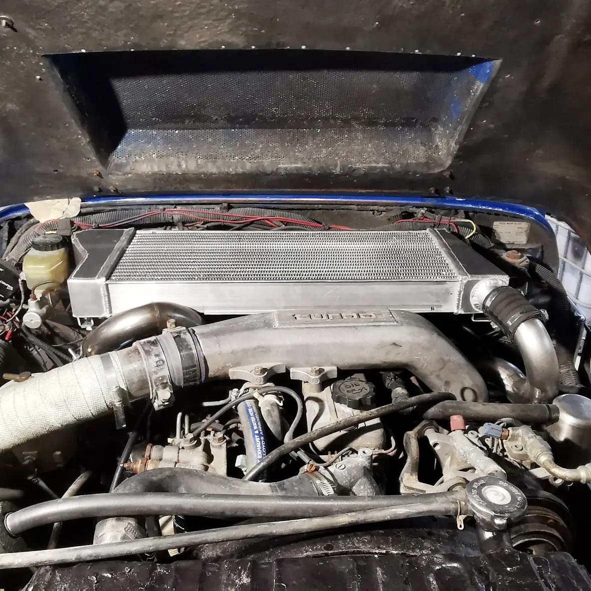

I have an over the engine intercooler with 2 fans. Why would you say i already have Alfin pistons? Yes my engine was rebuild but i don’t remember changing the pistons, but i will check i think there is a thread here about the rebuild.Thx
Have you got some more angles of that intercooler?

Angles, without the fans the final set up is with 2 fans with a manual switch. thx
with manual switch.
Your intercooler may be acting as an interheater sitting above the engine like that, i do see the hood scoop and fans but that could be limiting its effectiveness for sure

id look for air leaks and where the psi is being measured from, and although it is a huge pain in the ass perhaps moving that intercooler to the front somehow, i think you may find some efficiency this way

All good info there. I would also be concerned about pressure loss across the intercooler. One with more cores and more thickness provides less flow resistance as well as better cooling.
Basically if higher boost gives you higher EGT something is wrong. Either a restriction somewhere or a the intercooler isn't cooling. We're trying to find that.
