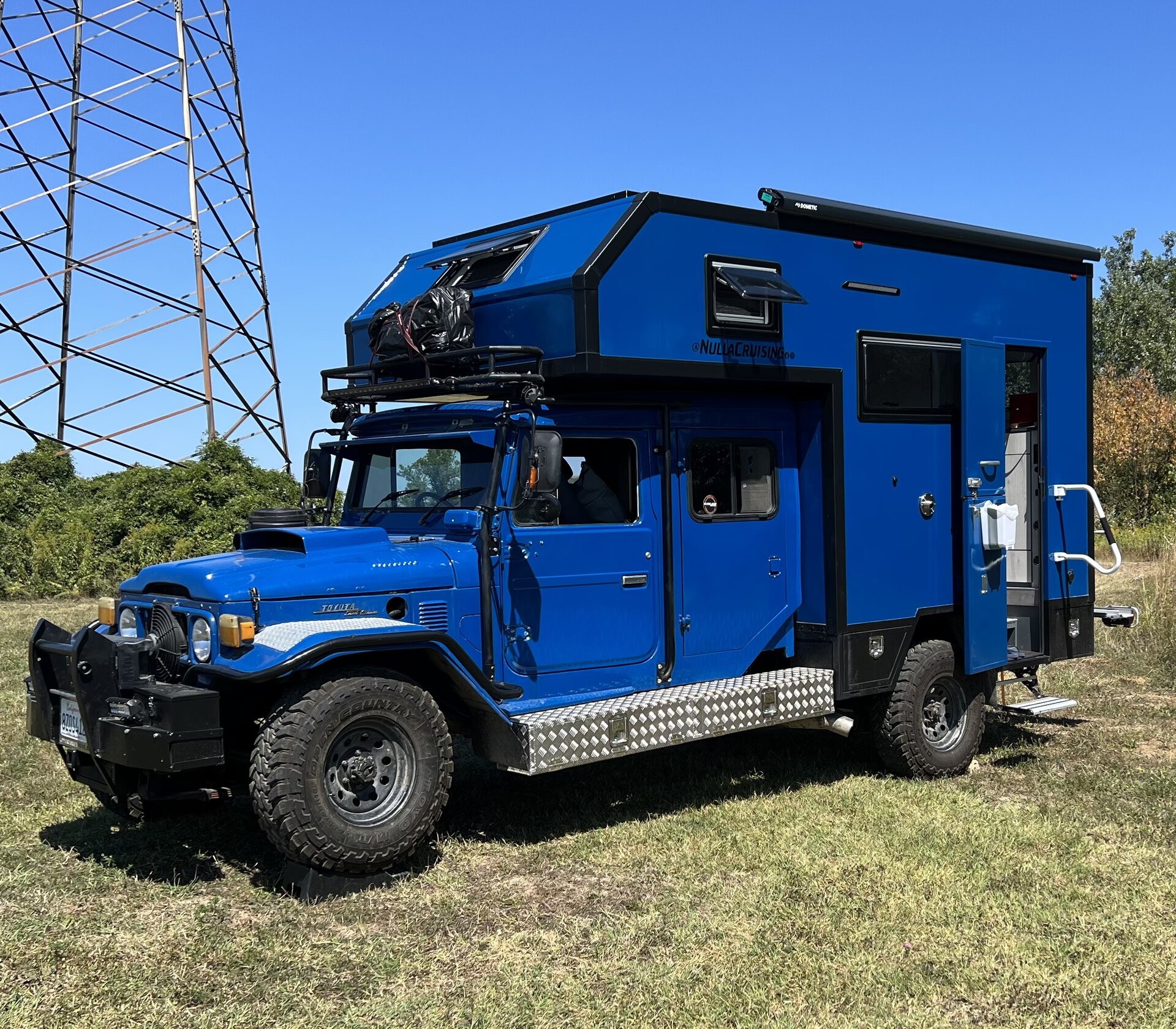

I have a 12ht engine with Gturbo and H55 transmission on my 1983 HJ47 that I am using for extended overland travels. Currently in Africa. It is heavy 10,000 pounds fully loaded. I am happy with the simplicity and reliability of my 12ht but I am thinking of an engine swap because of the need for more power. Which engine would you recommend 1HDT, 1HDFT, 1HDFTE? Reliability and simplicity is still important to me. I know there are similar thread out there but i did not want to hijack them. Thank you.🙏🏽

What a beast! thats quite the truck there
