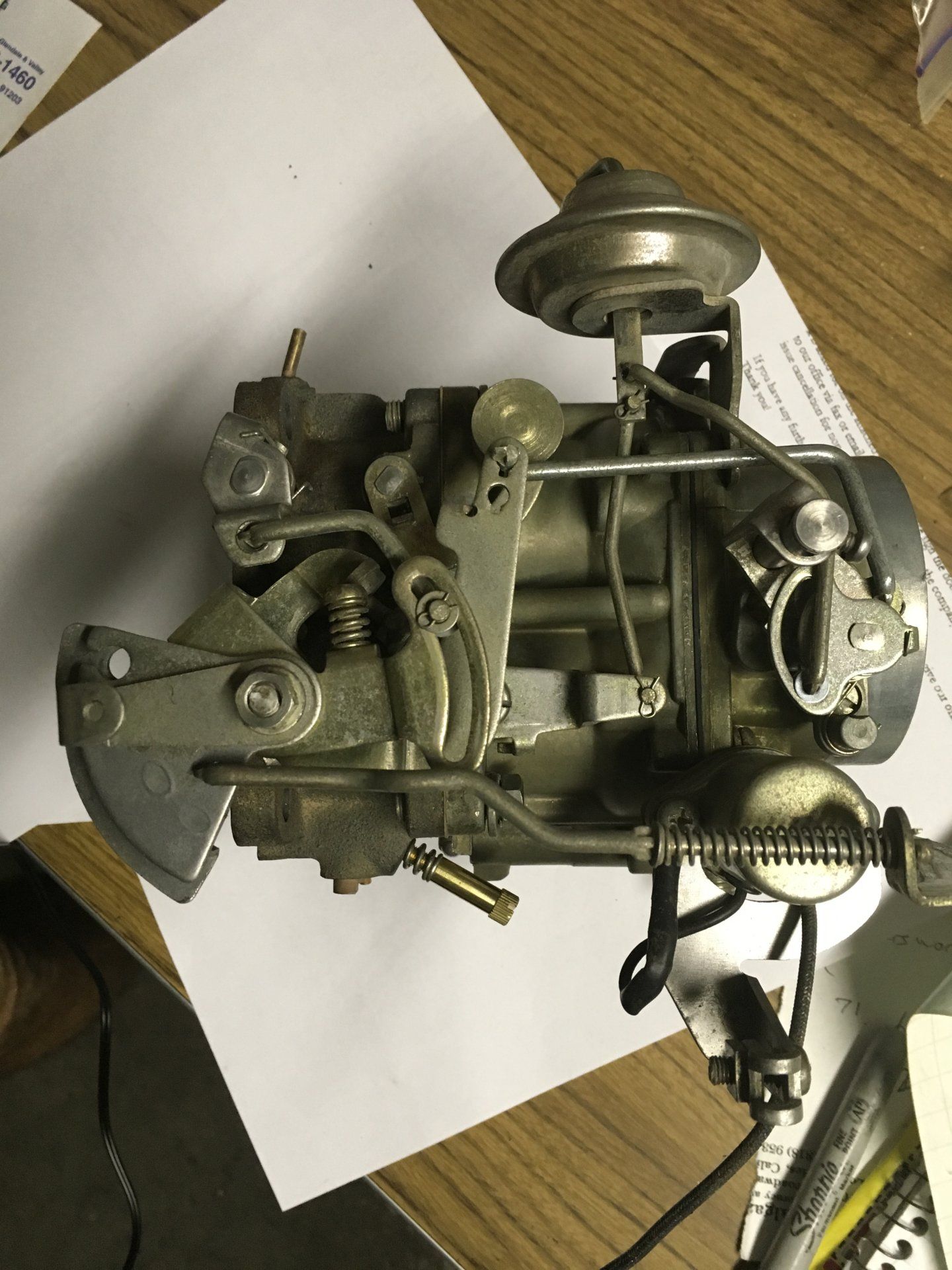

I am flattered Mark! But I will have to get you a better picture, an 'after' picture, to go with my name.
Edit: here's one:
