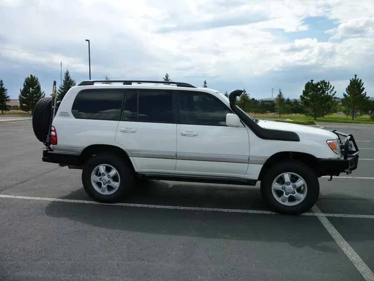

That is what I run and I am real happy with the 863's. I ran them for two weeks (sorry no pics) before my storage drawers came in and they were fine then. I towed my camper to Ouray and it rode nice as well

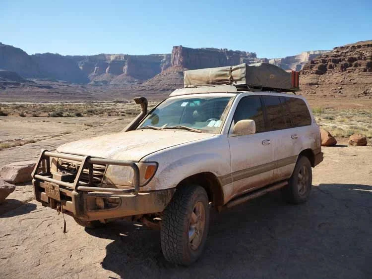

and then fully loaded with an RTT, Gas and propane on the roof
attachment.php
attachment.php
Thanks Romer.

Also some clarity on the above, Romer's running 863's. and it looks like a 1.5" drop in height when fully loaded, the setup with the gas and RTT being the worst case. Truck looks awesome though Ken, very happy. :grinpimp:

2.5" to 3. Since it had the 865's on it when I bought it, its hard to tell
All the pictures has the storage drawers fully loaded with tools and spare parts.
So you can see the difference in the first pic to the two in the desert loaded with stuff on the roof
and how it sits with a heavy camper on it

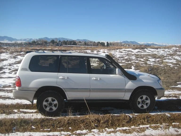

Yep. My 866's sag as well. That is why I put 30MM spacers on. They ride great for my setup, but I did not see a 2" lift with them.
Would you consider this a 2" lift? This is 866 springs, no bumper, no 3rd row seats, just an empty fridge in back.
attachment.php
I actually like the ride height, but when I add more weight it will sag- my camper makes it go down at least another inch, to the chagrin of oncoming vehicles at night. That's why I'm thinking 864, would like to try a pair if someone has some!
