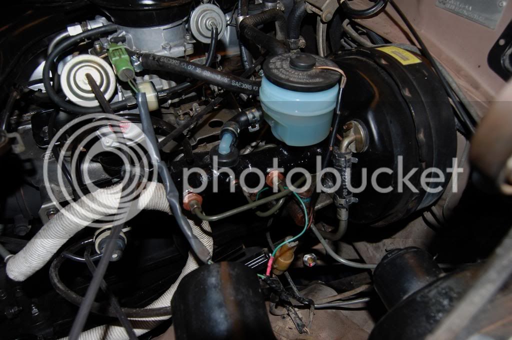

Knowing how much doing things like this mean to me, and feeling bad for me, my dad offered to come over and help out. He's 72 but works on stuff daily and isn't afraid of getting his hands dirty. He's never worked on a Cruiser but no fear. He showed up after I got home from work. We got the master cylinder done and brakes bled. Cruiser has brakes again! The element that led to the teardown in the first place.

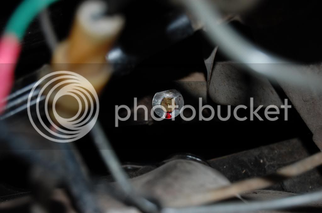

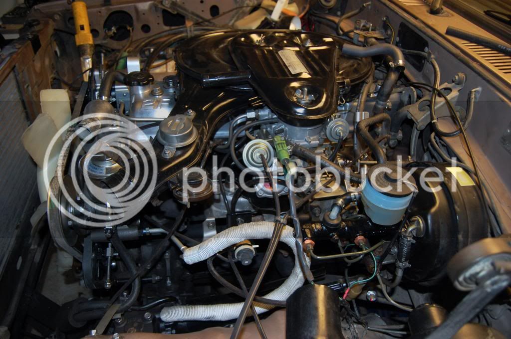

Also plugged up the EGR exhaust pipe. Again not having a welder proved an issue again. I dug around in my bolts, scrap, and whatnot and found a stainless fitting with a threaded hole in the top. It was way too long, but we cut it down to a good length and the diameter was just right. I found a plug that threaded in the hole perfectly. We pounded that stainless fitting in nice and snug. I don't see it coming out. I used red loctite and installed the plug. Just to be safe, ran a bead of JB weld around the joint. Now I believe it is good to go!

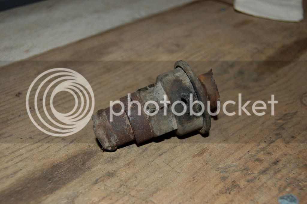

Here is the old check valve I cut off the EGR. Lookie what I found on the back side. Hmmm… problem??

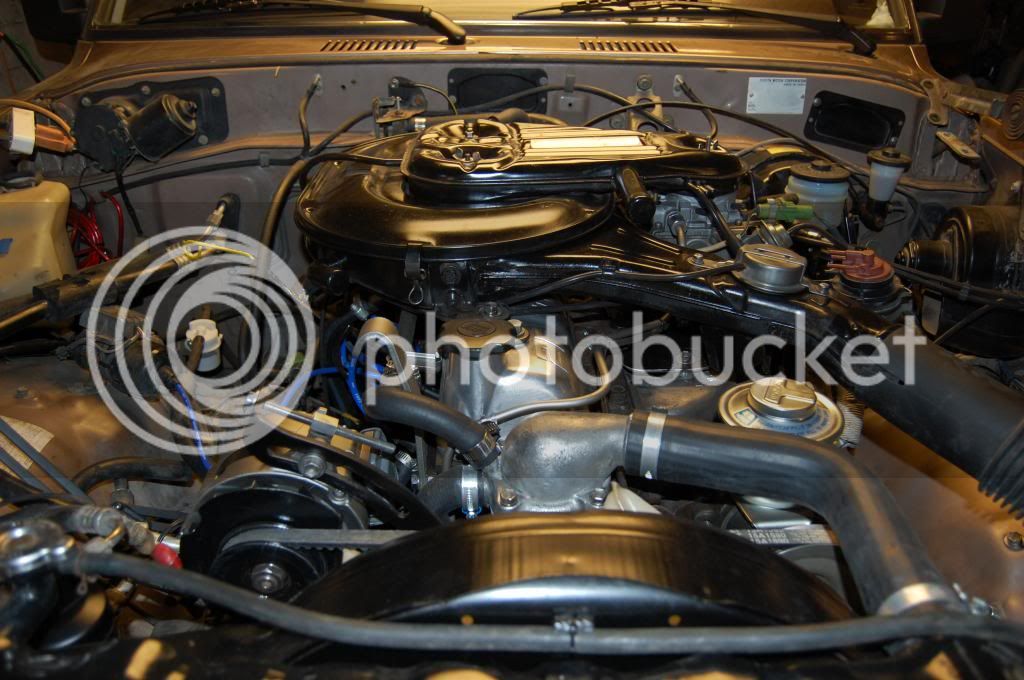

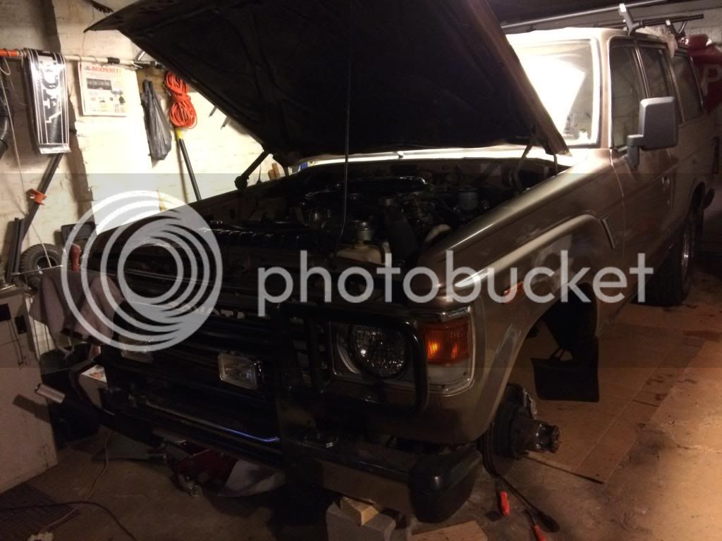

Ahh Look at that engine bay coming together. Few more days that productive, and we'll just about be there! Thanks pops!

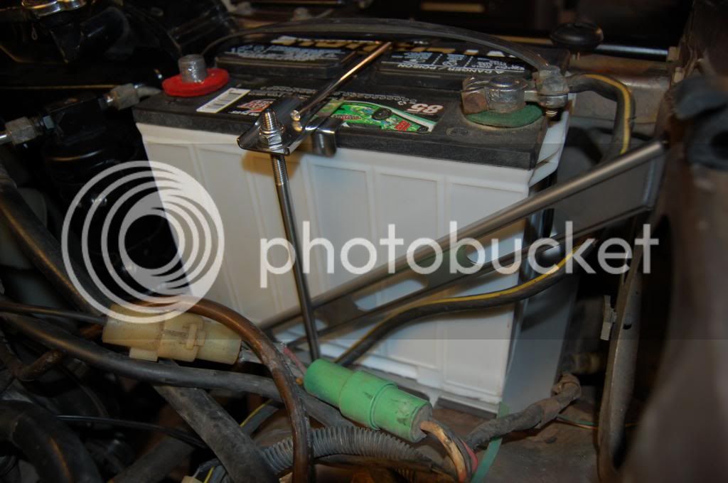

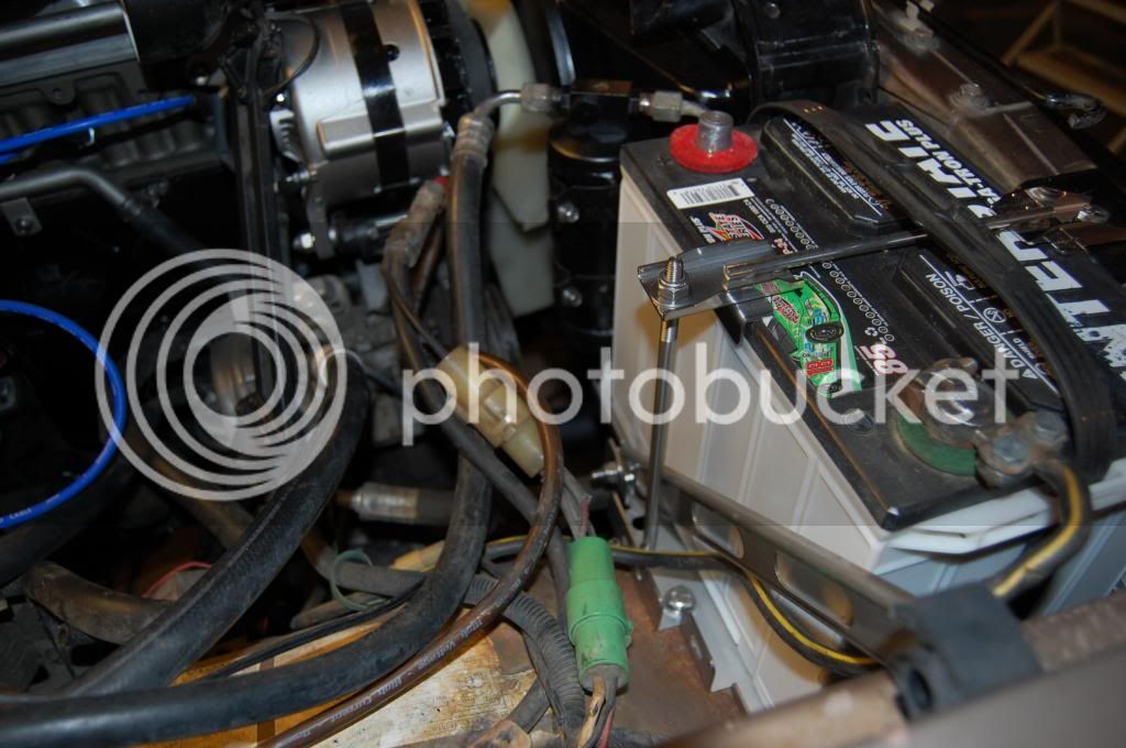

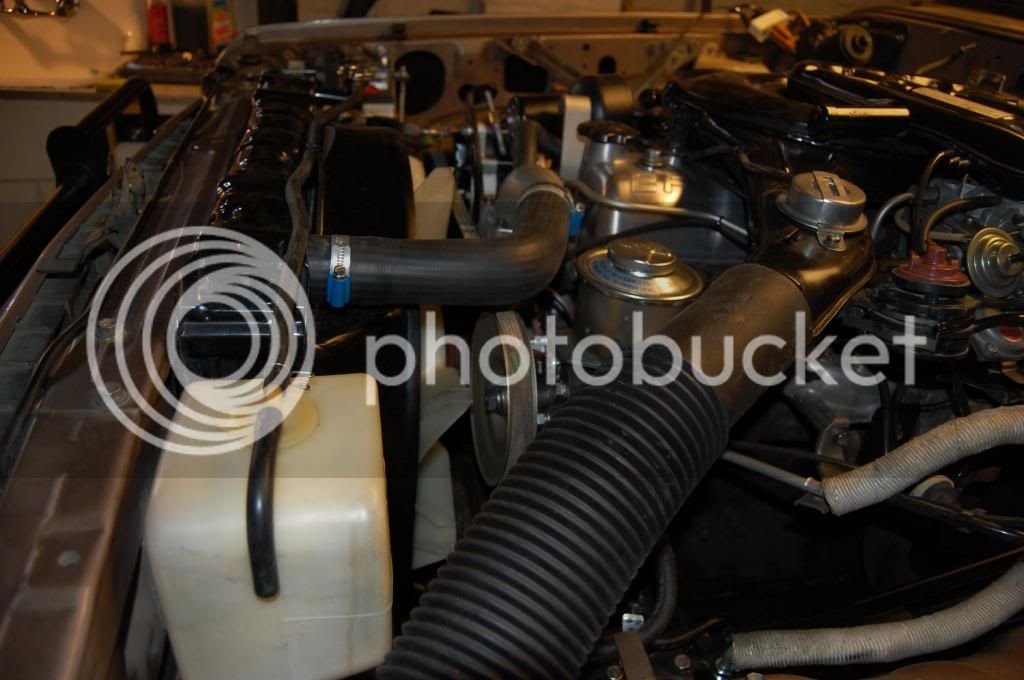

On a lighter note... Radiator, distributor, and that beautiful battery tray went in yesterday! Fingers crossed that my timing will be right. Nothing moved since removal and I had everything marked.
More pic time. There is the radiator done, the battery tray, and the round eyes now that grill is back together.

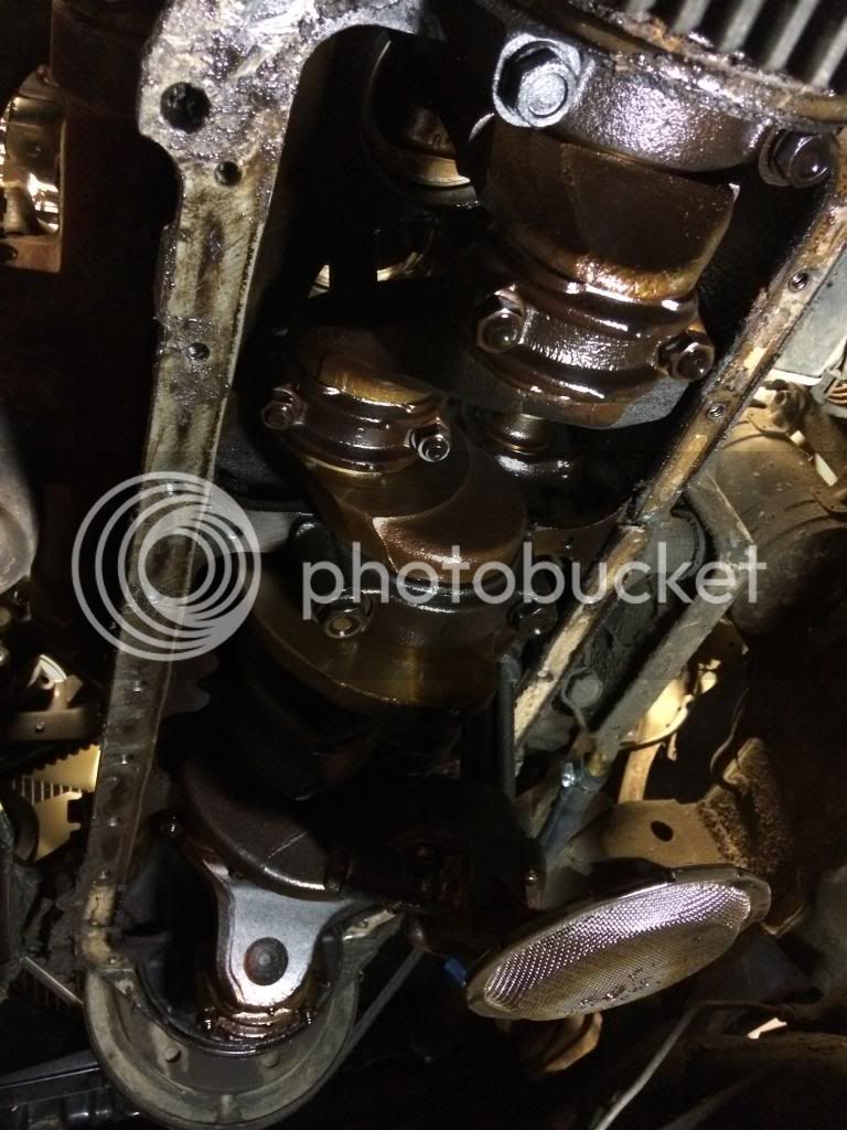

Oil pan is finally off, feel like we are moving forward again. I'll try to get that scraped down and cleaned up for re-install next week. Very little sludge/metal in the pan I was happy with how clean it was. Especially for 248,000 miles.

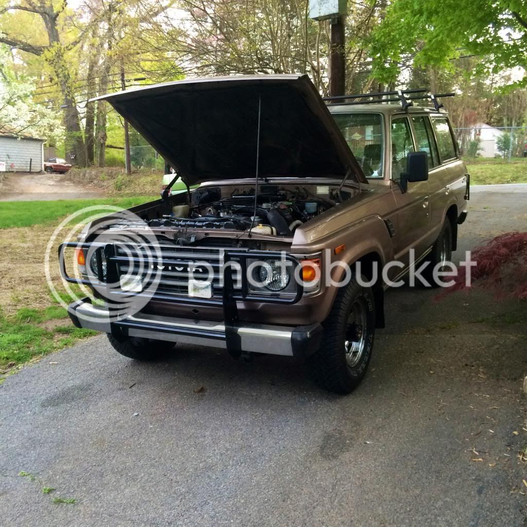

Also put the hood back on! I can't wait to fire thais baby up again!!

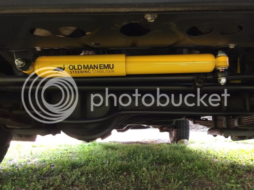

Glory Day! It was just the EGR block off plate as I had suspected. Tightened that baby up, and no more noise. I put the OME steering stabilizer on this afternoon. Man, what a PITA to get those bolts out. I happened to be in the auto parts store last week, buying coolant, and noticed a puller on the sale rack for $6. Knowing I had this job coming up, I snatched it up. Glad I did too. This job would have been impossible without it! I tried the pickle fork first, no luck, sledge hammer, no luck. Puller did the job. Really had to torque down on it though.

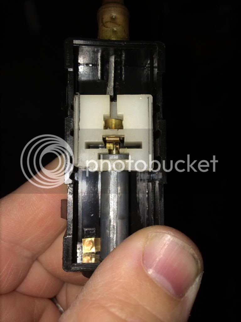

Went to start the Cruiser and the choke knob came out with no tension on it. I looked under the hood but saw nothing out of the ordinary. Then I tore into it under the dash and found the swaged ferrule had come off the end of the cable. That's kinda unusual. I guess I wore it out when my truck wouldn't idol without pulling out the choke so I was constantly pulling it out every time I stopped. Glad they are still available. New one on order! I can add choke cable to the list of new items not to have to worry about. :)
