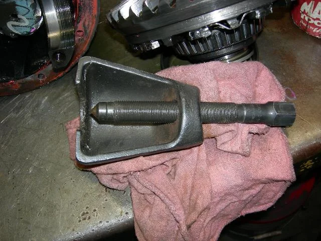

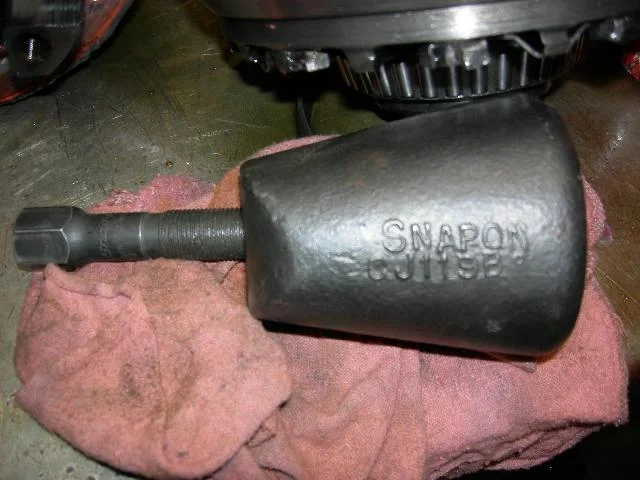

X2 - i don't own one, but i borrow one from a mechanic friend.. Works every time in about 1 minute.. no pounding, no undue stress on the rest of the box..
Snap On CJ119B
Everything else is a waste of time and money.
