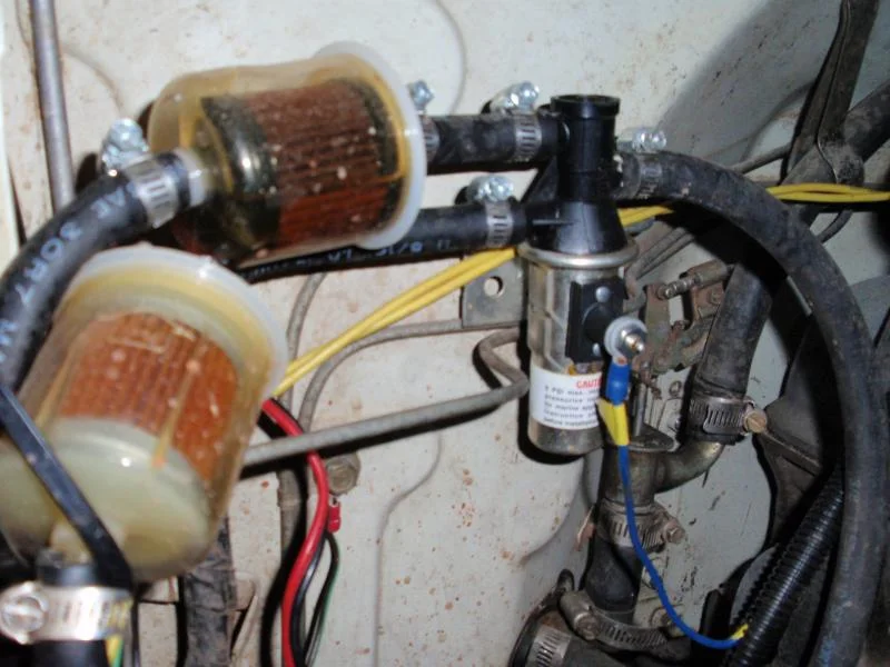

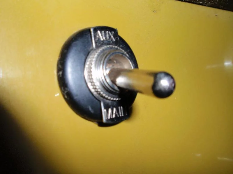

Here are the parts I used for my aux tank. With this set-up I am using my stock gauge for both tanks. The dash switch operates the fuel valve and also reads the appropriate fuel sending unit. The positional switch plate "aux/main" was that has the Hope this helps.
So I think the valve ended up being the FV1 or FV-1. Purchased on line at Rockauto.com. ($40.79)
The part FV2 or FV-2 is the switch plate. ($1.84) Type these part numbers into the search link below. Try without the dash.

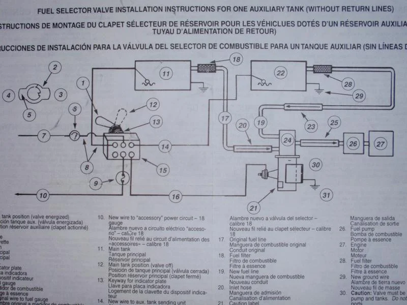

Below is the schematic for wiring and fuel lines.

Isn't there a possible problem with the two-to-one (three way) fuel valve if you have the return line(s) hooked up. Basically, with that valve you're only switching the input to the pump and the excess will always be sent to the same tank. Since this is usually the tank under the seat, when pulling from the rear tank the under seat tank will overfill. That is why you need a 'six way switch' that switches both the input and return lines.
I wasn't aware that a 3 way fuel valve could be used with the return lines hooked up. I was under the impression that would have to be a 6 way valve.
It can't be used for the reason stated. You could actually hook it up, but the one tank getting all of the return flow will eventually overfill.
From what I understand, most of the MAF & Confer tanks were set up without a return line. Often they were set up with a transfer pump to refill the factory tank. This simplified the return, and fuel sender issue. You'd know you could "refill" the factory tank 1.5 times (more or less).
The Qjet I'm running doesn't have a return line. Rather than an electric valve, I've got a brass three way fuel valve that I picked up at one ofthe local marine shops. The manual valve should be simple and reliable (and not cheap plastic). I'll also need a switch to select which tank the guage is reading. Perhaps not as user friendly, but it should be very reliable.
My 1978-mfg ConFerr tank has a return port fitting, and I used the 6-way Pollack valve and a DPDT switch to plumb it. This tank was dealer-installed on a '78 FJ40.
I installed a Sun-Tune (cheapie) fuel sender and gauge (GM-style) near the edge of the tank so that the float was near the middle of the tank - but watch for baffles, etc. I have a '73 Ford Bronco fuel selector switch mounted on the dash (nice retro look) that flips the valve one way or the other. This setup has worked perfectly since 1990, so I cannot complain. I agree that you need a 6-way valve to properly route the return fuel to the correct tank, if you have a return type fuel system.
I set up my system so that if the power failed to the Pollack valve, the system would default to the stock fuel tank. I always use my aux tank first, and then switch to the main.
Just my .02 on this. A 6 way valve requires more plumbing and is more expensive, but results an idiot proof system, which benefits me as a I get older ;-)
