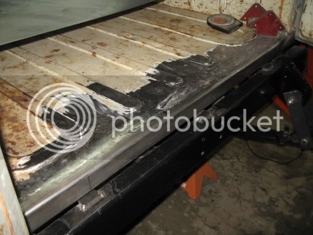

Thank Corey. You conveyed what I was trying to say very well. I bought the cover piece for $40 and am goin to make the under sill myself out of Box steel. It will add weight but will also add lots of structure support.

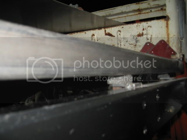

I dont know if my work will help you at all but some others were nice enough to paste some links back to theirs that were a lot of help with mine!! I couldnt have asked for a nicer fit with mine. the added 2 inch 1/4 inch strap tied the whole thing together and minimized space for new mud to hold water. The actual sill was CCOT because nothing against them but the ebay ones that i saw didnt have the factory bends or the indention for rear ambulance door latch catch. Oh and the 2 inch strap was snug to the sill so it will allow a solid place to drill and tap to remount the door latch. I had just better hit it on the head the first time around. :D
