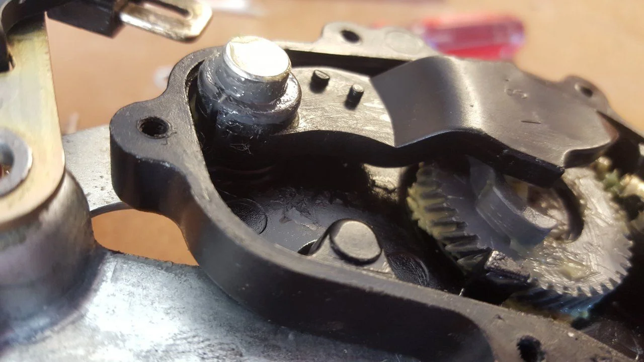

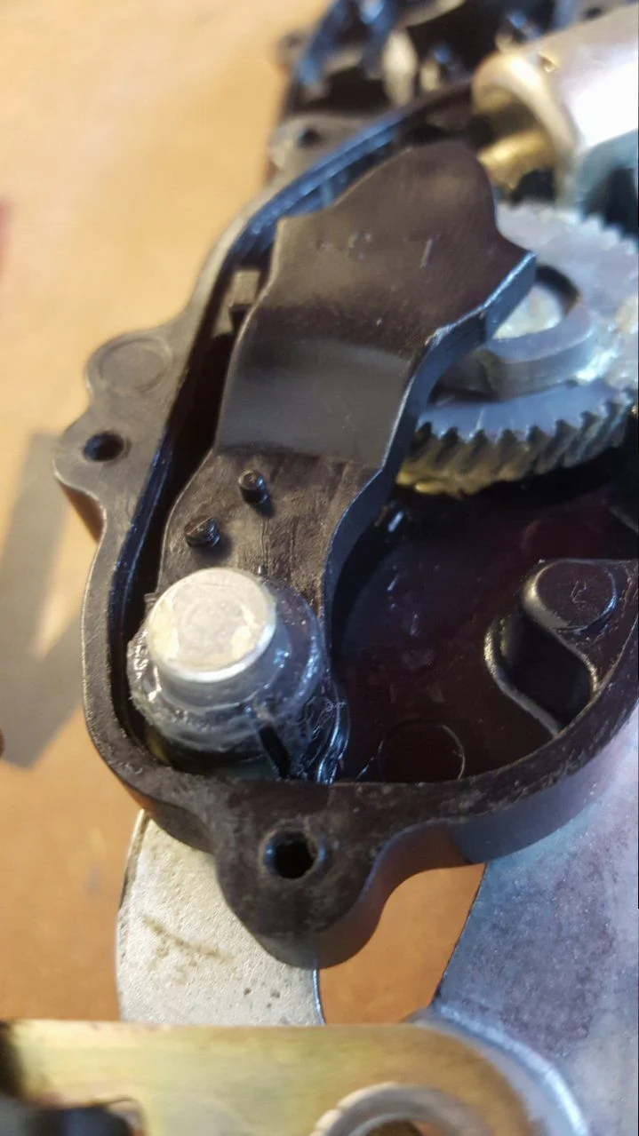

Quick side note for those working an actuator problem. Thought I had a bad motor until I got the actuator apart and found that the small actuator arm was cracked. A small drop of JB weld to secure the arm to the post and all was good. Re-lubed the whole mechanism and reinstalled. Good thing to check before assuming a bad motor or buying a whole new actuator
