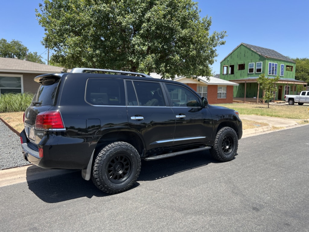

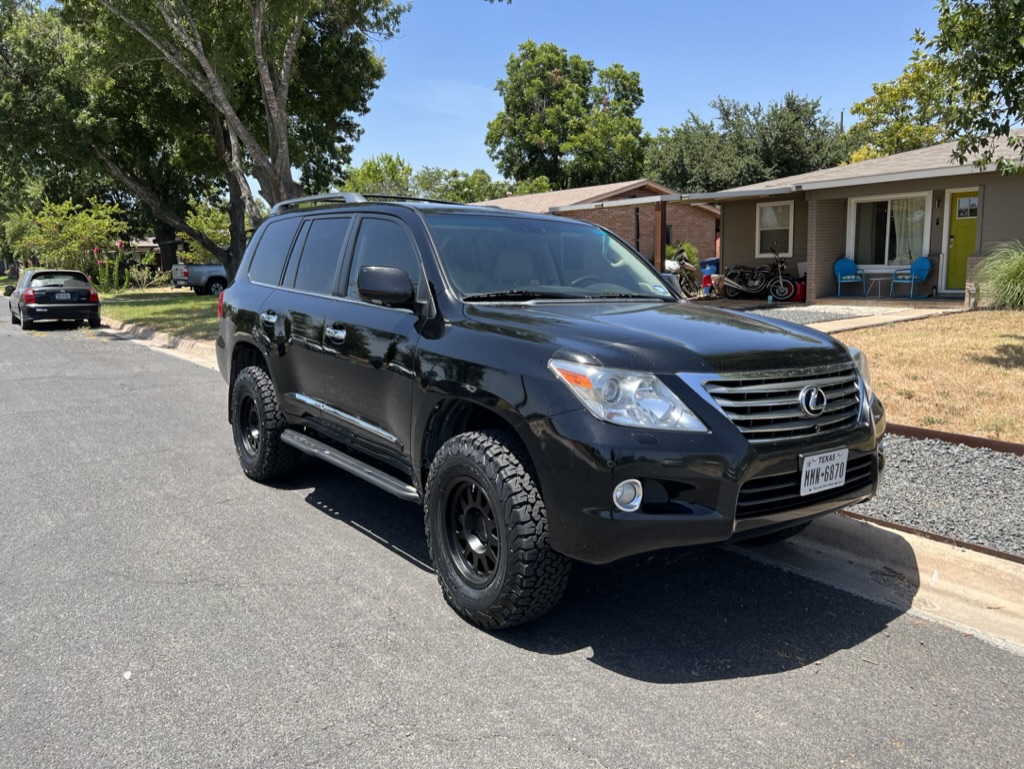

So the stock wheels had an offset that made it more inset? I always thought positive offsets mean the wheels stick out more, but this thread has taught me that it's the opposite. Here are the wheels I got. 704 | Matte Black - https://www.methodracewheels.com/products/mr704-matte-black?variant=31479072358461
I don't really mind the offset honestly, I just wish it had more of a lift, but it sounds like a senor lift should get me pretty close, I loved how it looks with it on high mode.
