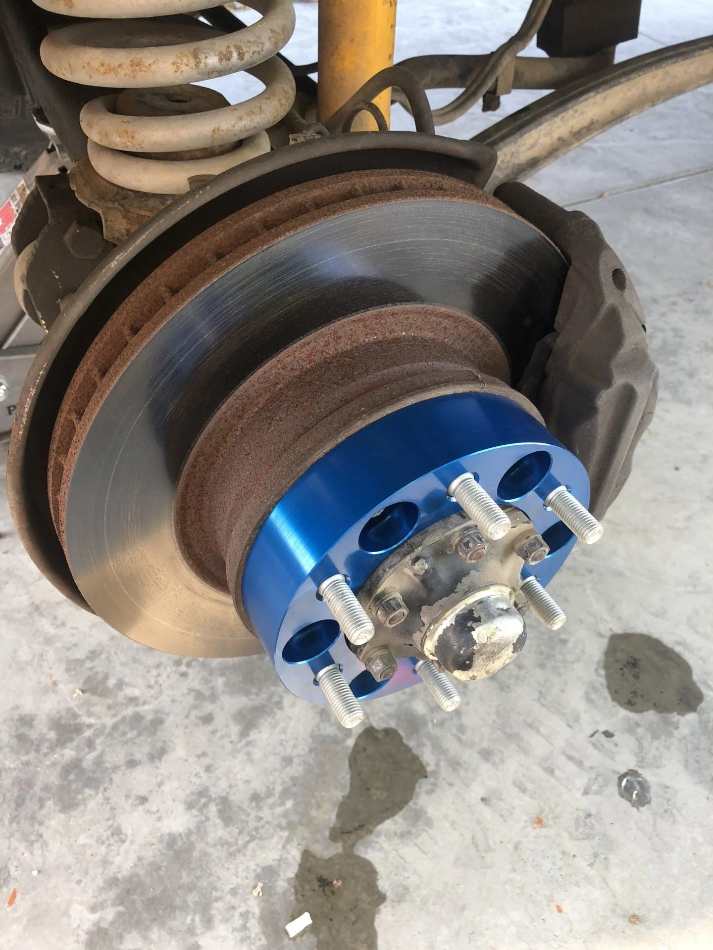

Not if you buy 1.5” Spidertrax spacers from Slee.
That’s what I did when mounting 17” early Sequioa/Tundra wheels.

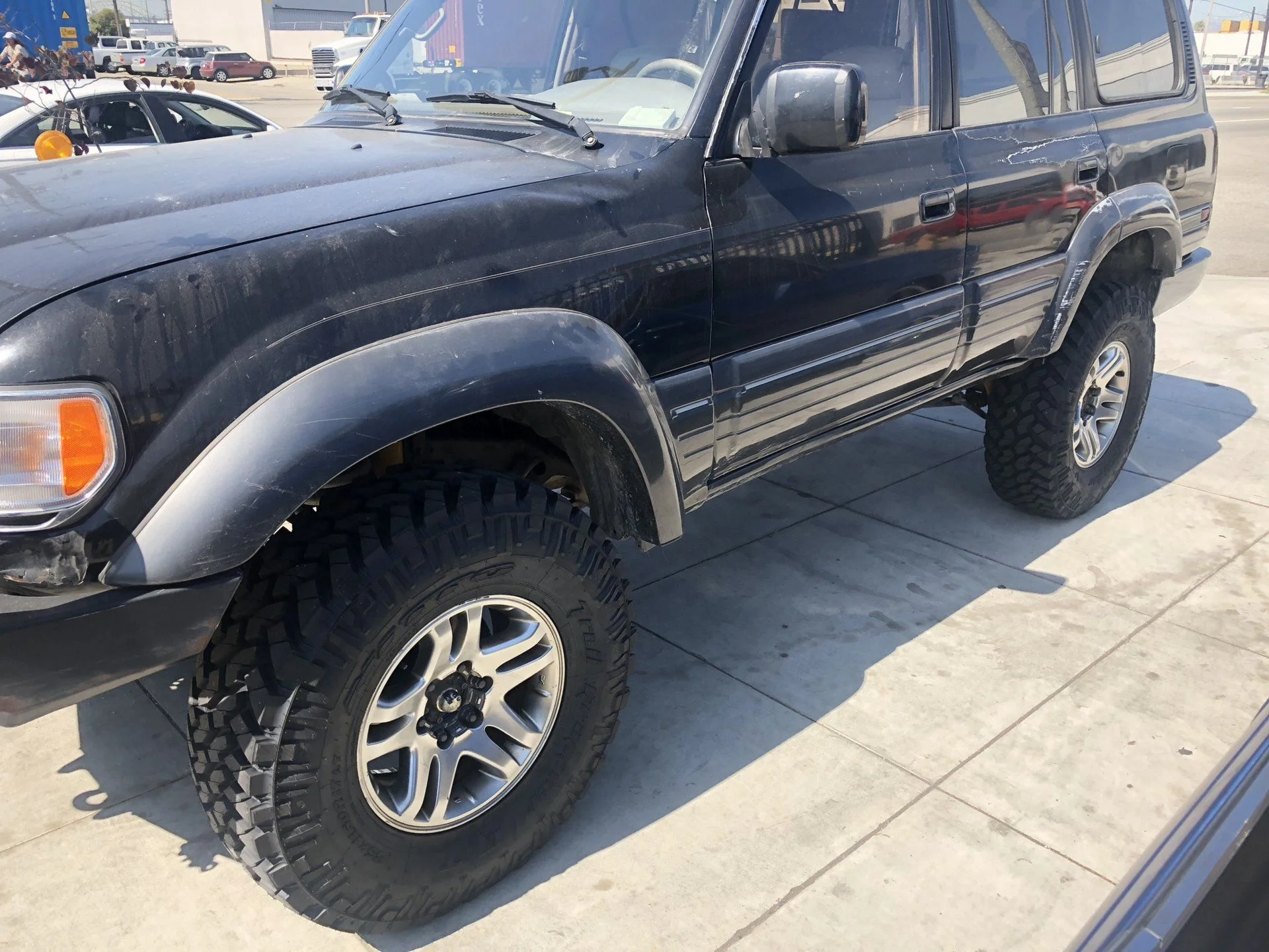

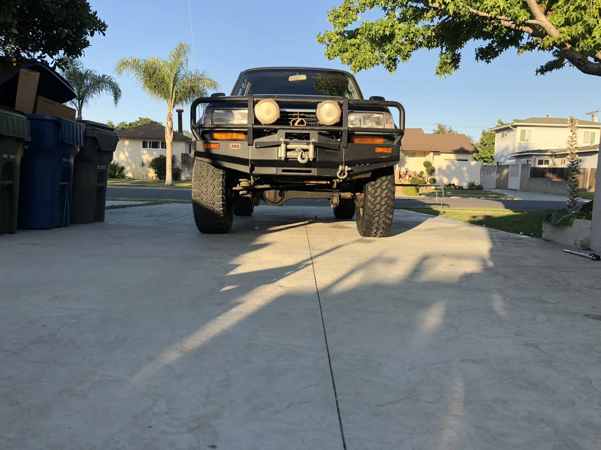

Also added 1.5" Spidertrax spacers to increase my stance. Have some minor rubbing issues to deal with, but the widen stance will increase stability during wheeling.
What tires & size are those?
I wanted skinnier tires. The only 35” tire I could find narrower than 12.5” were my Nitto TrailGrappler M/T’s.
In my forward pic, the Nitto’s are on the driver side & old 315/75/r16’s still on passenger side.
