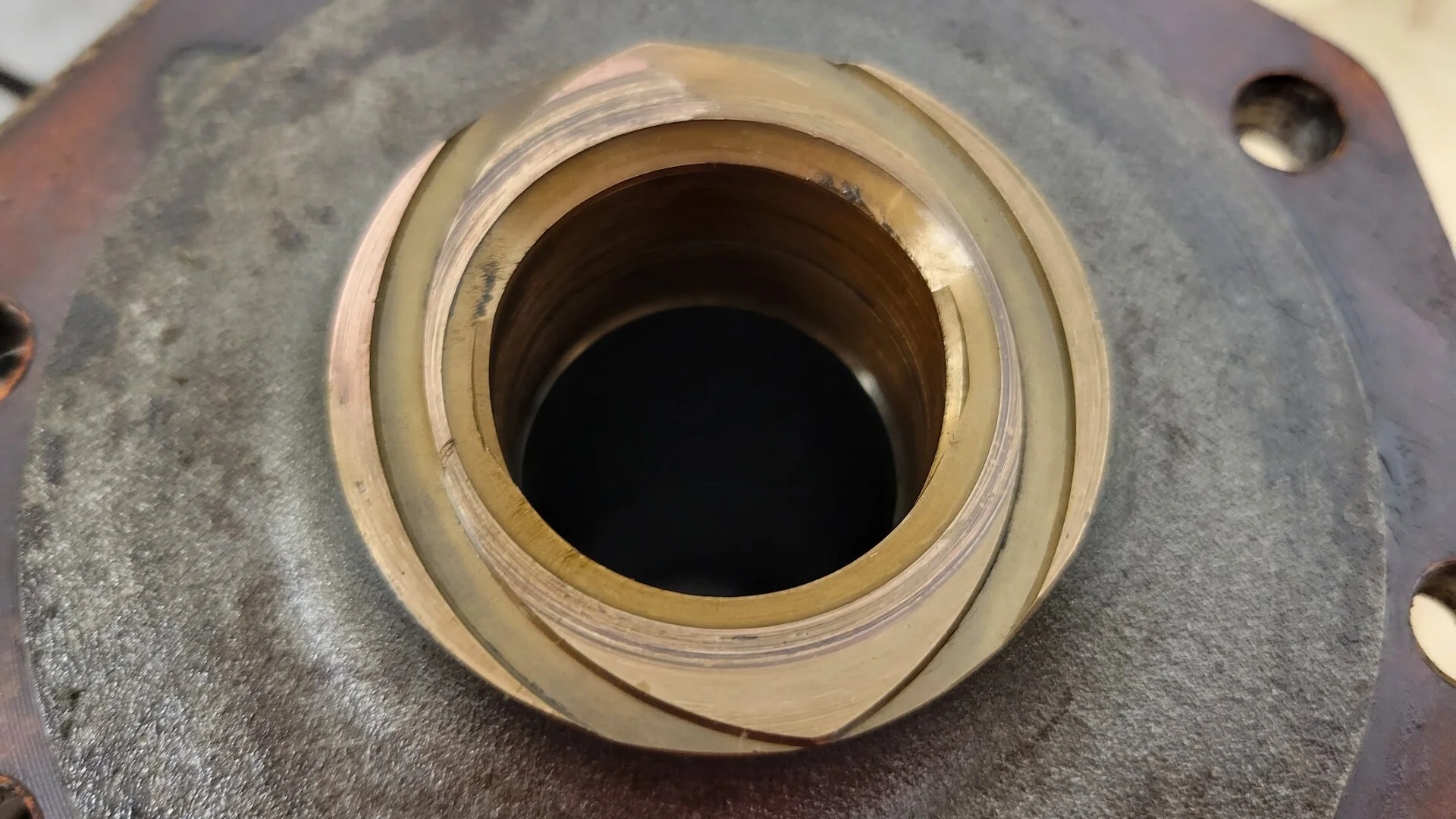

It could possibly be an issue with the bushing/bearing inside the spindle that the outer stub shaft centers in. If you have it all back together now, you could pull the front drive shaft and both drive flanges to keep from turning the front axles as a way to verify this.

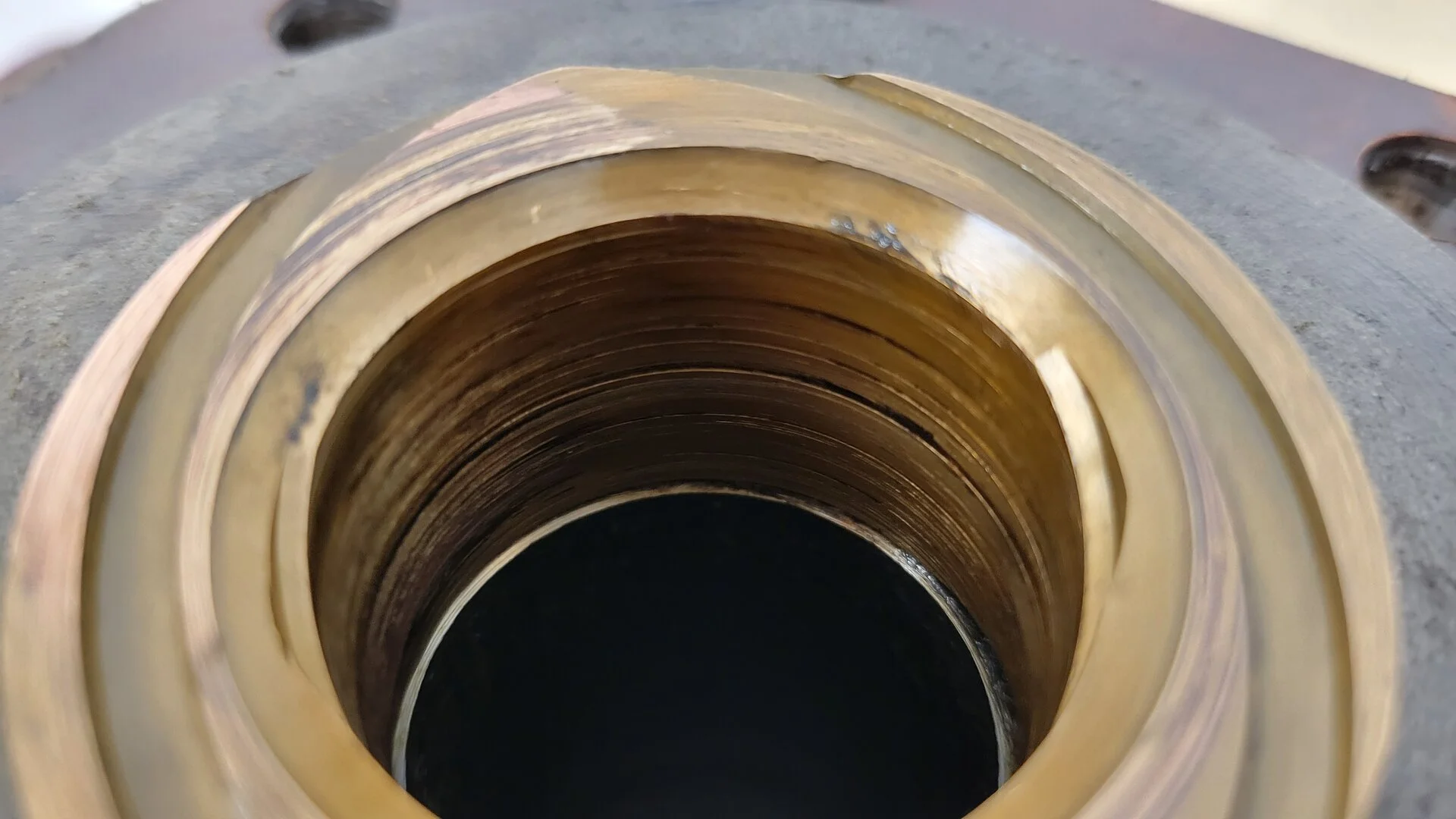

I think @baldilocks is calling it correctly.
Spindle bushing inside the knuckle cavity. If it wasn't actually greased, filling the birf cavity doesn't always fix it since it must be pushed in there.
There is a tool that can be screwed over the end of the spindle and grease it from the outside, but I don't recall who makes it.
Have to pull off the spindle at this point.
What did the inside of the races look like when you pulled the bearings?
Dry spindle bushing.
Toast! Do you have a line on a replacement part along you planned route?
If the wheel bearing surfaces are scored, replace the spindle. 43401-60081. The new version of the spindle has a needle bearing instead of the bushing.
Cruiser Outfitters should have one in stock.
Do also replace the wheel bearings and races along with the spindle. The new spindle will be happier for a lot longer.
