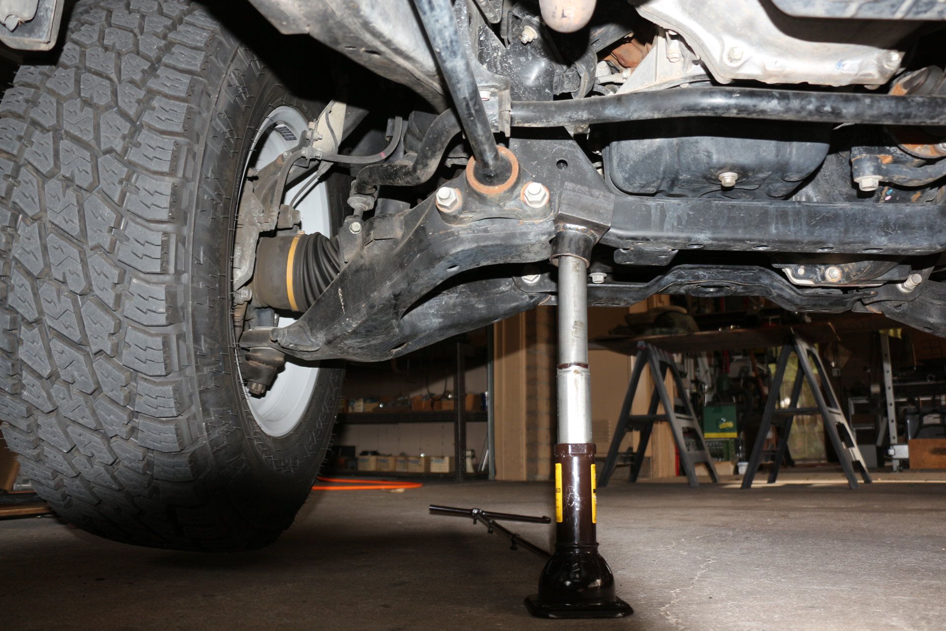

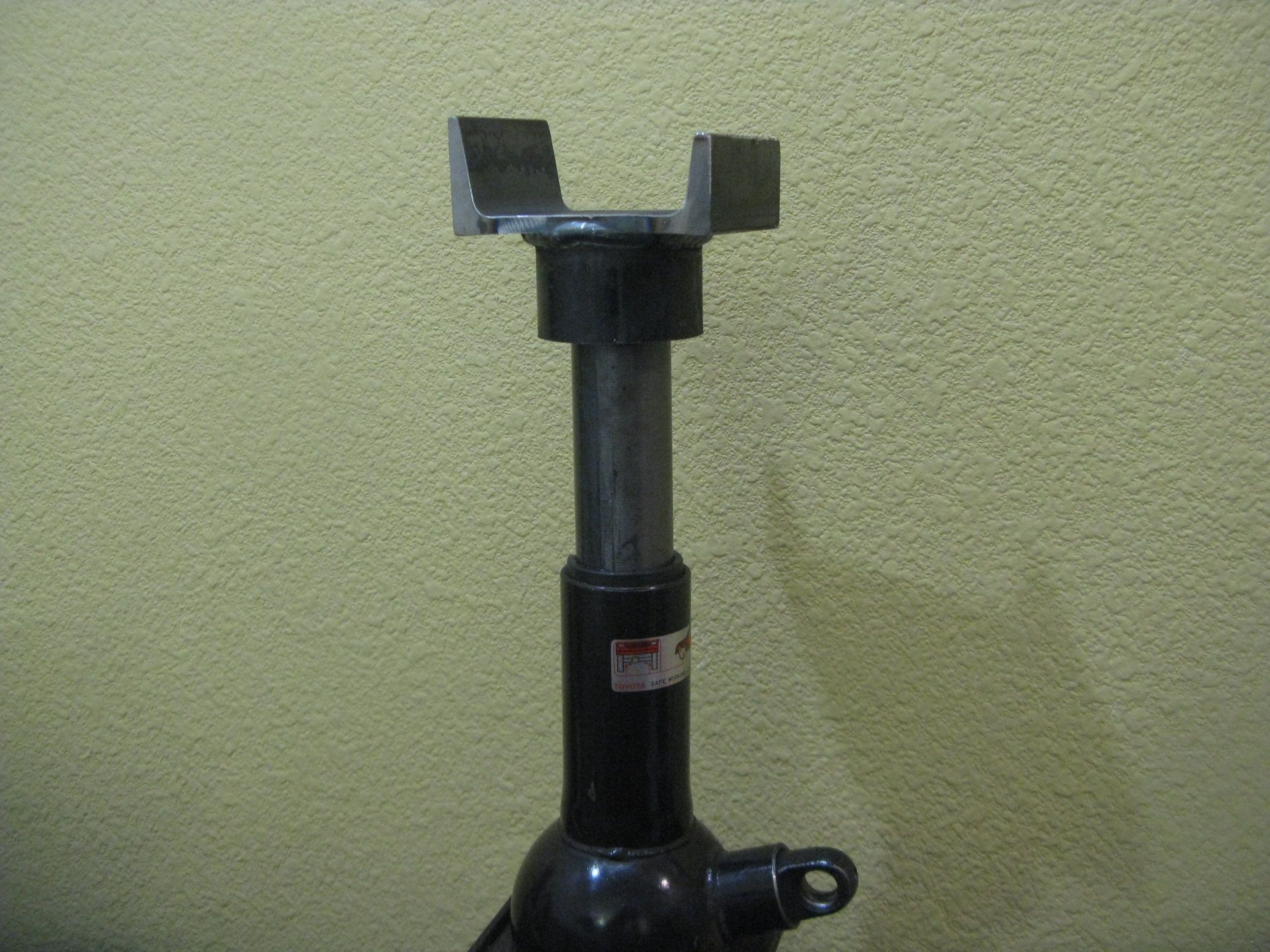

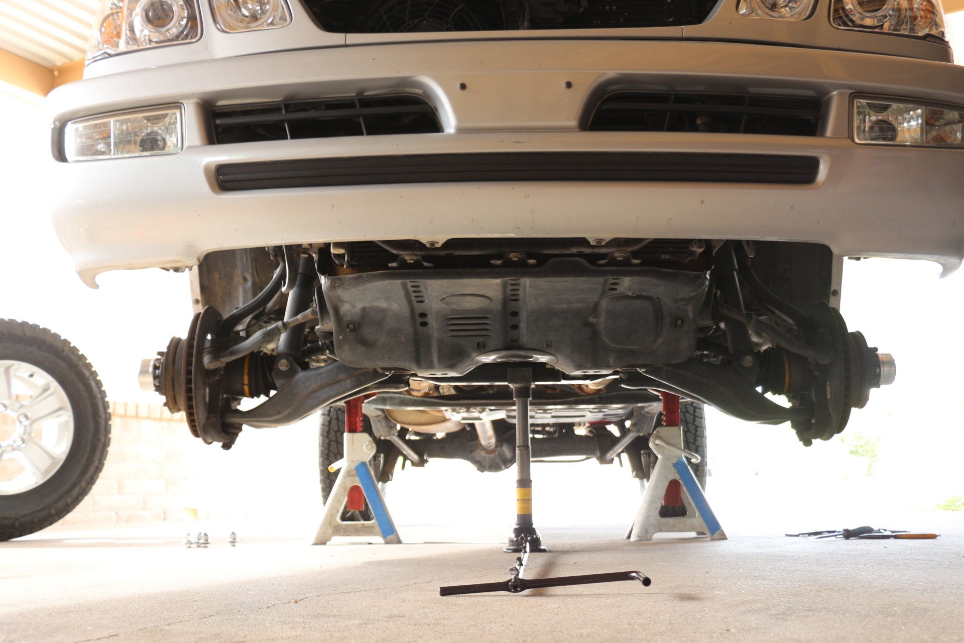

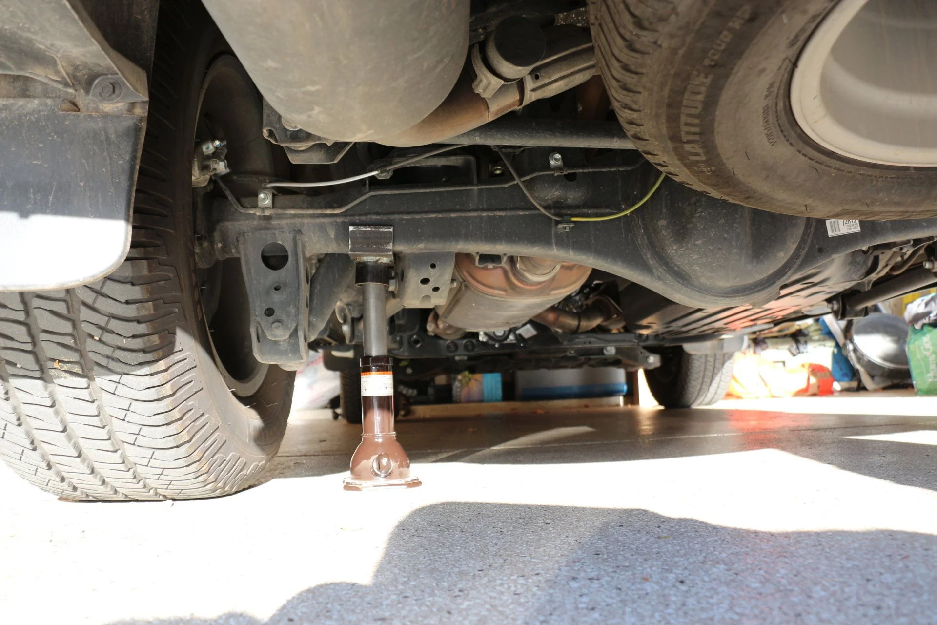

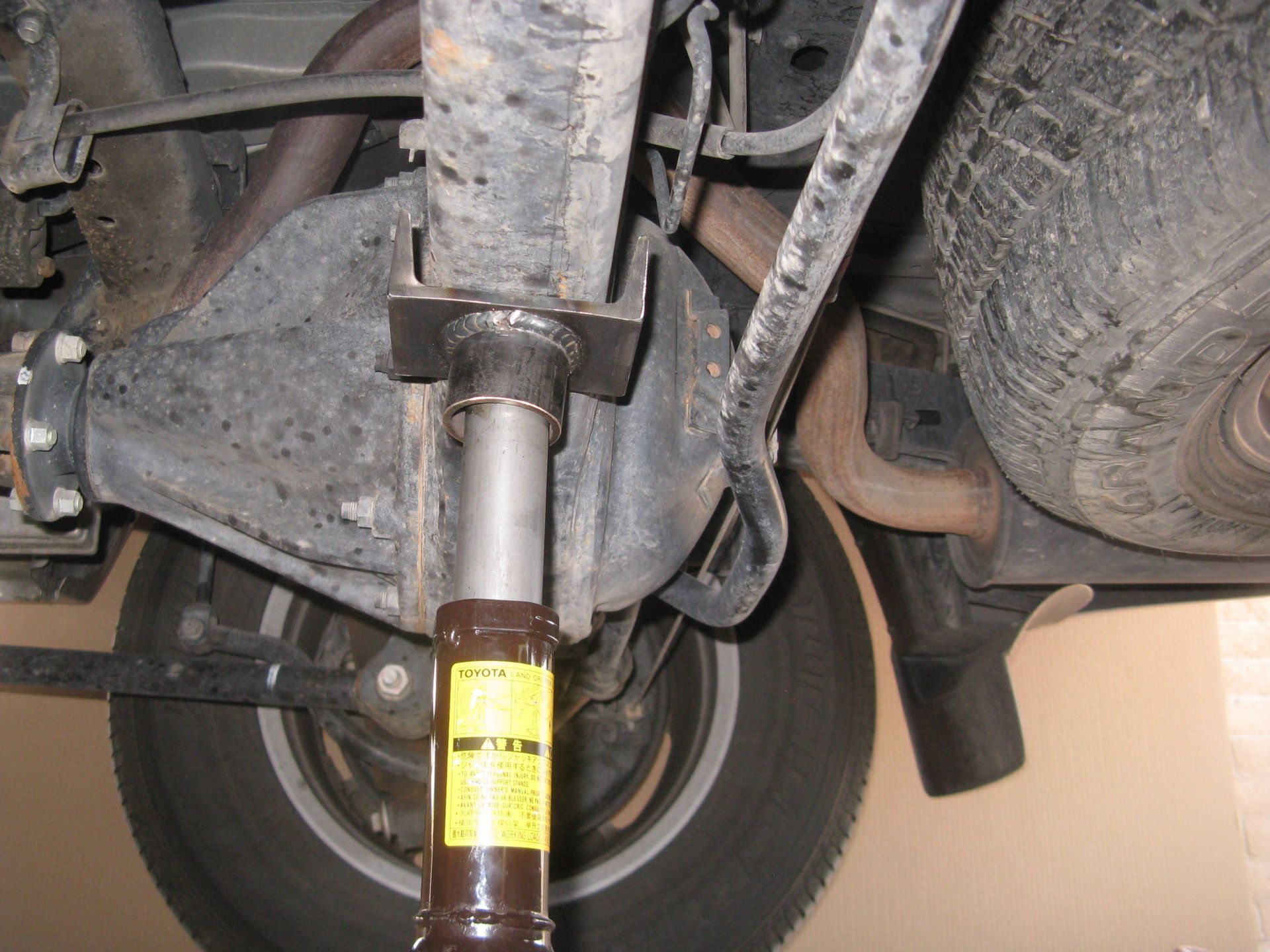

Our jack adapter and a factory jack (80, 100, 120 series) can change a 37" tire no problem.

When servicing or changing a tire you want to lift the minimum so your friend is correct lift at the axle. Our adapter keep you much safer by securing the jack eliminating sliding off. :eek: The adapter is slightly oversized to let it pivot while keeping the jack 100% vertical.

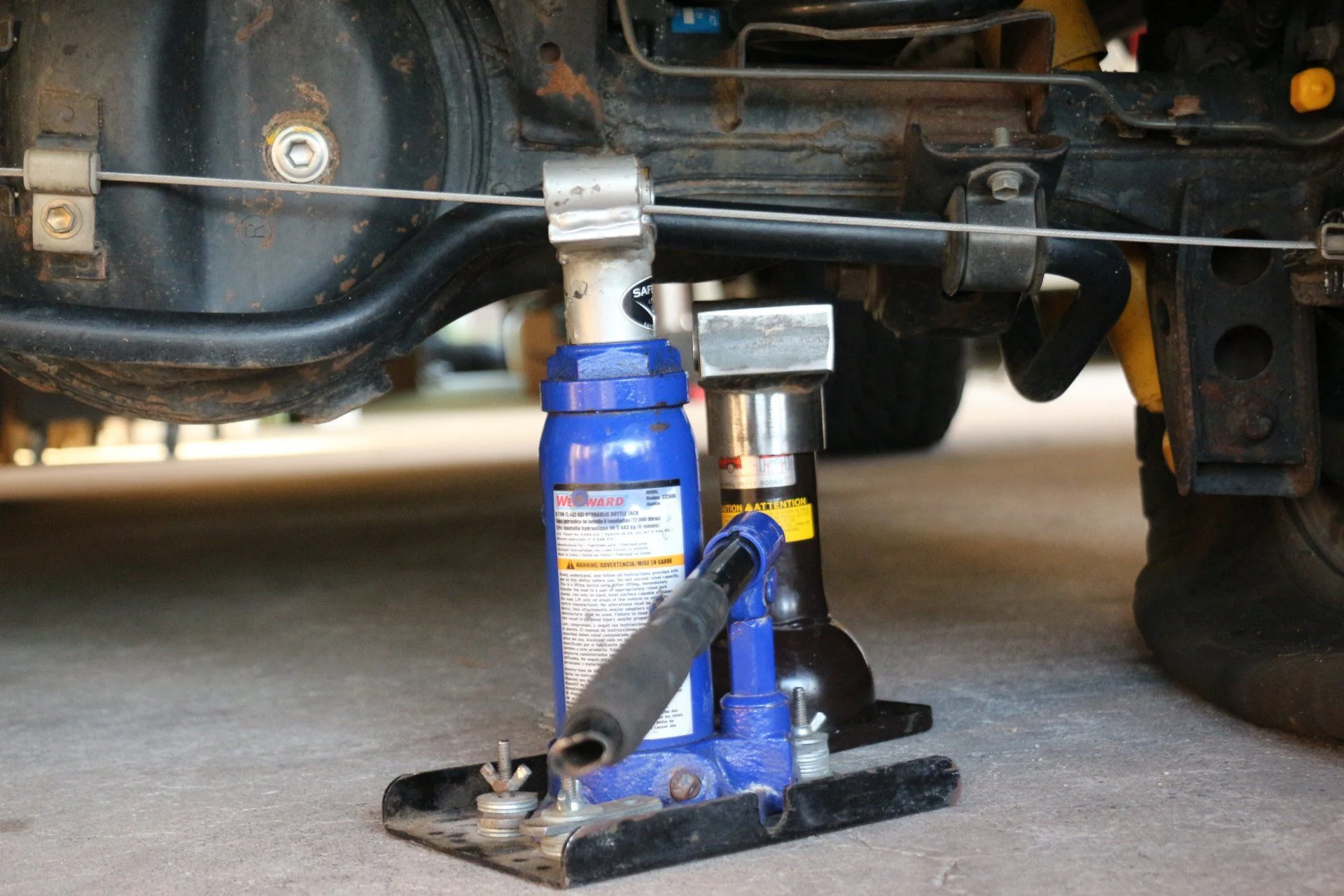

@LandCruiserPhil the cradle is a great solution, I bought one last year and use it in the garage all of the time. The only other thing needed is a base to use the factory bottle jack offroad, either make your own or buy the HiLift base.
IMHO the best part of a HiLift is the handle - so many uses! The jack itself drives me nuts and I try to never use it. Paying $800+ or any number of hundreds for a jack is insane, unless you're racing or have rolls of toilet paper made of $50's. The factory bottle jack has never let me down, and with the cradle is incredibly useful.
