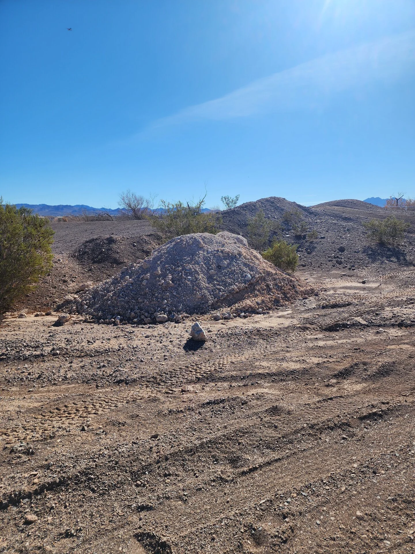

Was testing flex in my rear passenger suspension after installing the Delta panhard bracket..just wanted to see how much clearance I have at full flex
Anyway was reversing onto a hill and the truck just wouldn't go past a certain height..it ls like the reverse gearing only has so much power and cuts out..it was making this sound..see video
is that normal? doesn't seem like it..I have no issues with reversing..just couldn't get up that mound..
