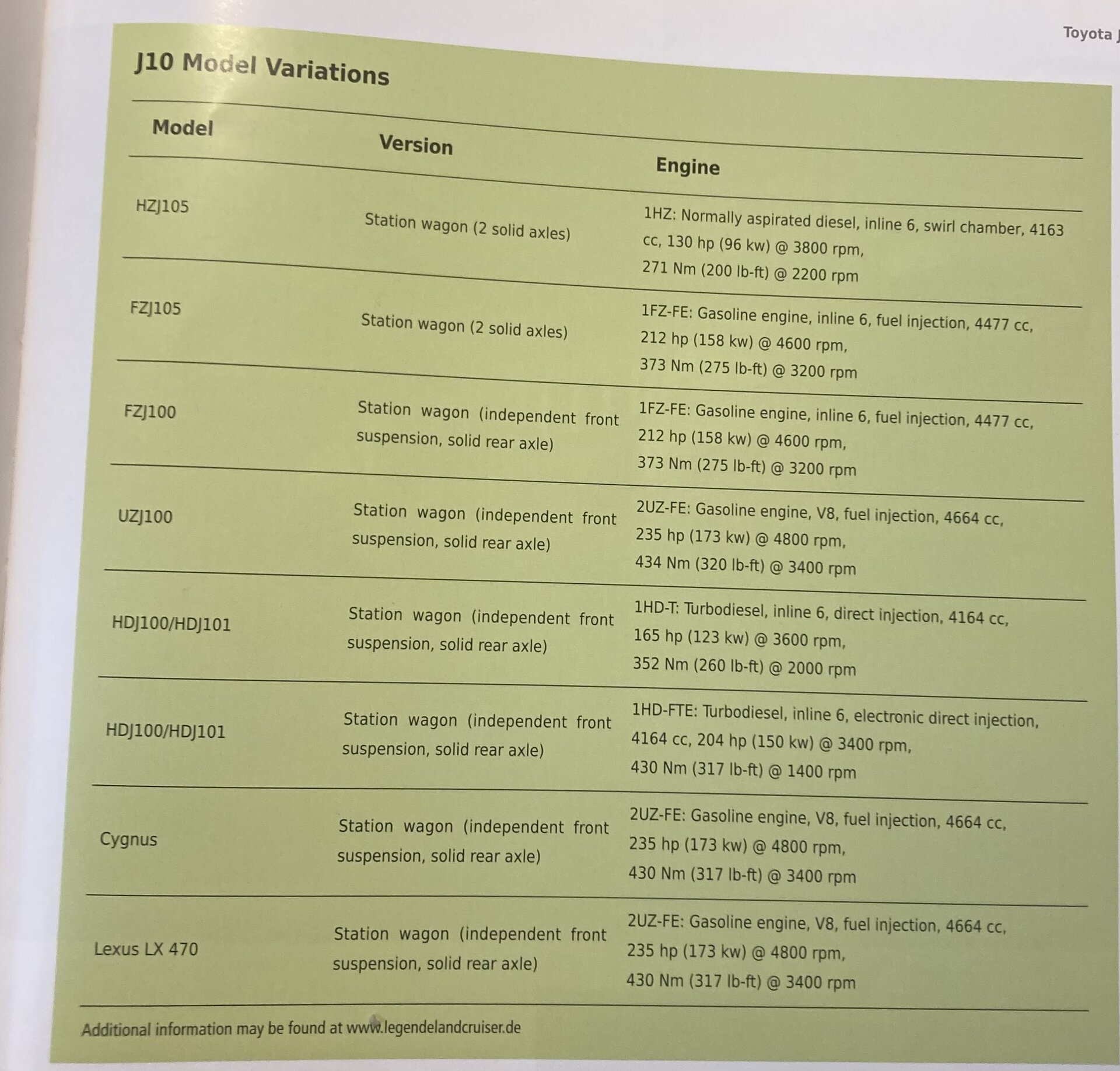

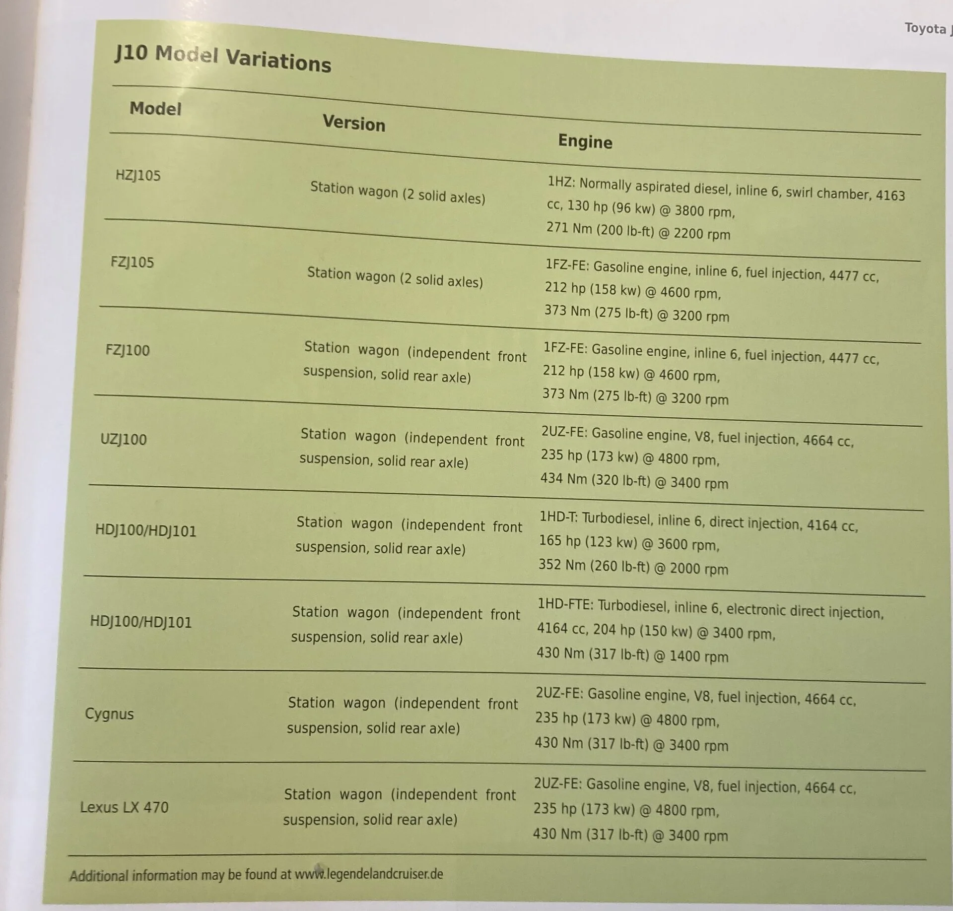

Is there a model with 4.7 and solid front axle? If not, what about turbo diesel and solid front axle?
EDIT: Forgot I had this:
my dream 100. I bought a 98 which makes this impossible.
Rear E locker w/ 4.30 gears
5 speed auto
VVTI
Non nav
No 100 Series came from the factory with a solid front axle and the 2UZ (4.7). The only "solid front axle" 100 Series is the 105, which is basically a 100 Series body on an 80 Series frame/drivetrain, but the engine options are limited to the 1FZ (petrol) and the 1HZ (diesel, but non-turbo). If you want a turbodiesel and a solid front axle, the options are (I believe) the previous gen HDJ80/81s (1HD variants), the HJ61 (12HT), and then various 70 Series with the 1HD, or the 1VD starting in 2007.
