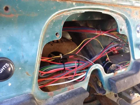

I kept the factory cluster plug and headlight switch

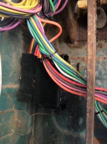

This is we're I mounted fuse block it's on the mount for ECM witch is no longer used

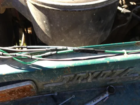

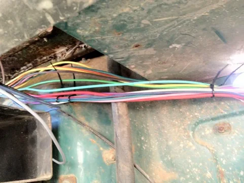

I soldiered and heat srank all connections

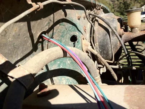

As you can see I ran tach oil temp and cho through the center firewall hole

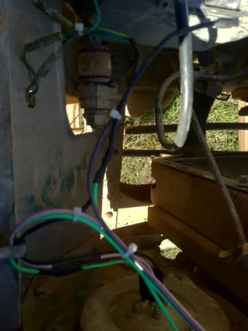

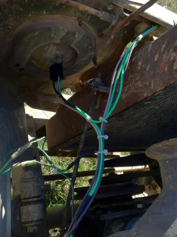

this is the right rear tail and tranny harness and the right side engine harness

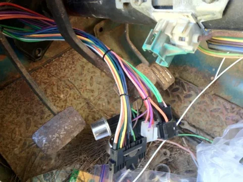

Gm column and plugs with flashers and horn relay
It's just really important to keep every thing together and organized
