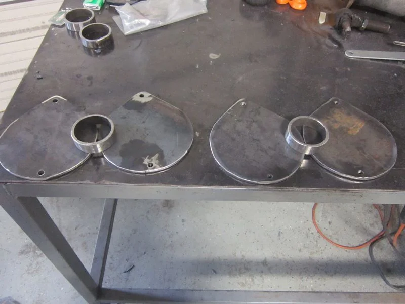

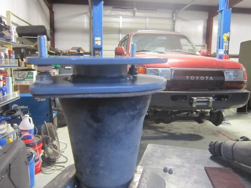

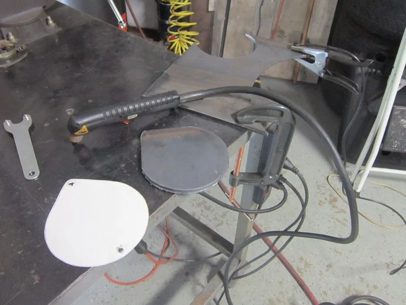

I built some 30mm front coil spacers for the 80.
Cost: A few hours.

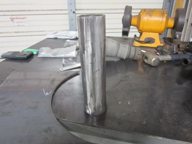

Used some 1/4" flat plate and a piece of old axle tubing that I had laying around.
Cleaned the tube up then cut to size.
Made a template and cut the plates out.

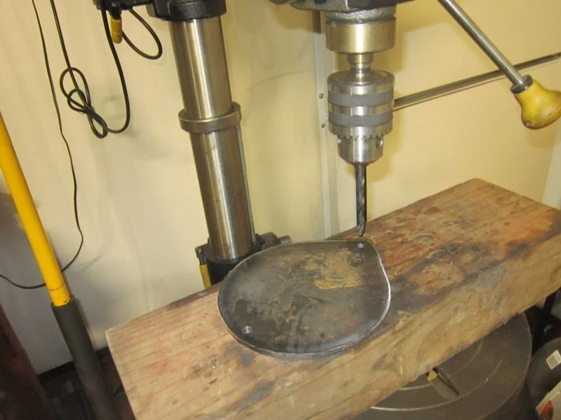

Drilled holes for the bottom plates.
Drilled and taped for the top plates.
Ready to be welded and painted.

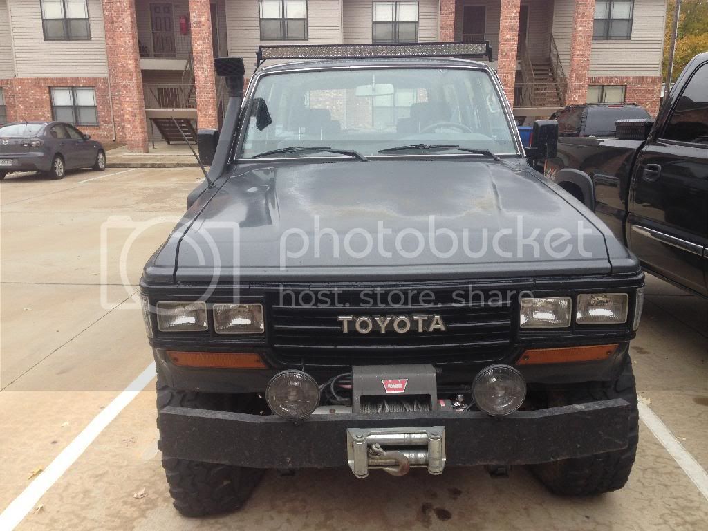

I started a new project called "Light Up The Moon".
Got me a new 40" dbl row light bar

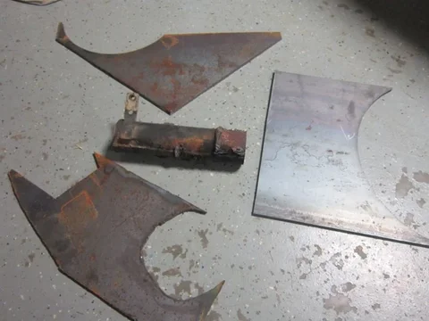

Had some light brackets made
Mocked up.. Still plenty of work to be done, but I'm liking how low this thing is gonna sit.
Were they out of the china gold color? On a serious note, were did you pick up the bar?
