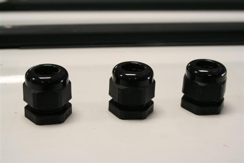

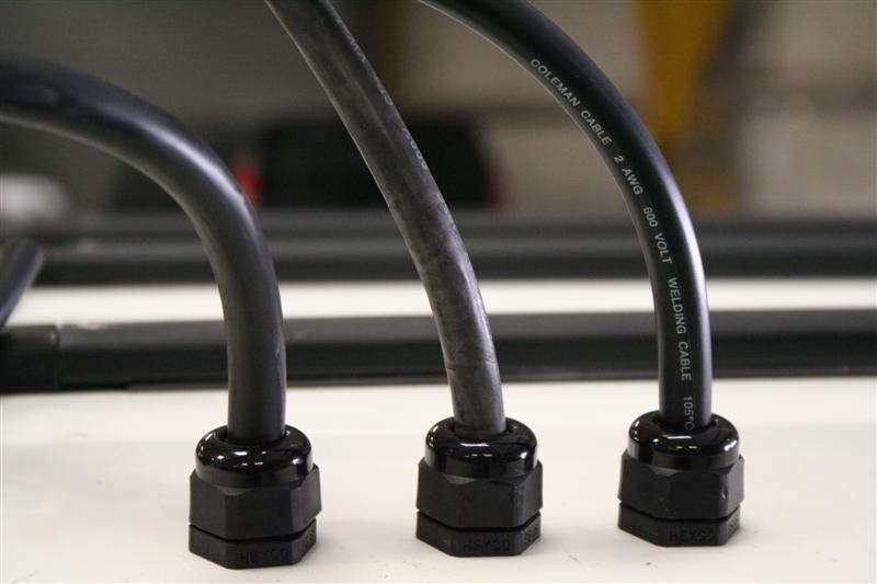

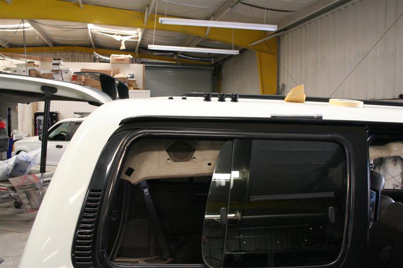

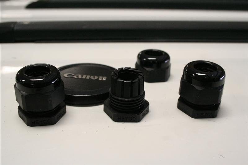

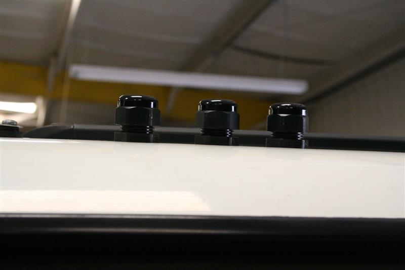

are you talking running wires through the roof? i don't run grommets..don't trust them to keep moisture out. i use a metripack fitting made for running through panels. no moisture on either vehicle and have been using it for years
Sweet! Thanks guys! That looks a lot simpler than I thought it would be. Now to get the courage to make a hole in a perfectly good cruiser roof. :hillbilly: Maybe next week.
Grab a unibit and start drilling!
Take caution where you drill. The moonroof takes up a heckuva lot of space under the roof. More space than I thought it would.
