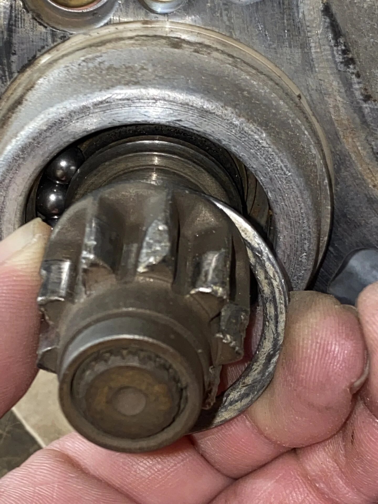

Typically but not always. Start fails to crank now and then on first try, only to turn/work shortly thereafter. This is early warning sign. Which I saw one go for 2 years like that, before dead. This is more times than not, due to contacts and plunger wear.
When they make a groaning sound, which is not typically. It's likely the drive, bearings and or gears. This can damage the flex plate teeth.
This one had remote start. I suspected owner was hitting start after it was running. It gave him issues for 2 years, before dead. Flex plates was damaged, but still usable.
