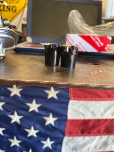

rotor on right that came with the disty

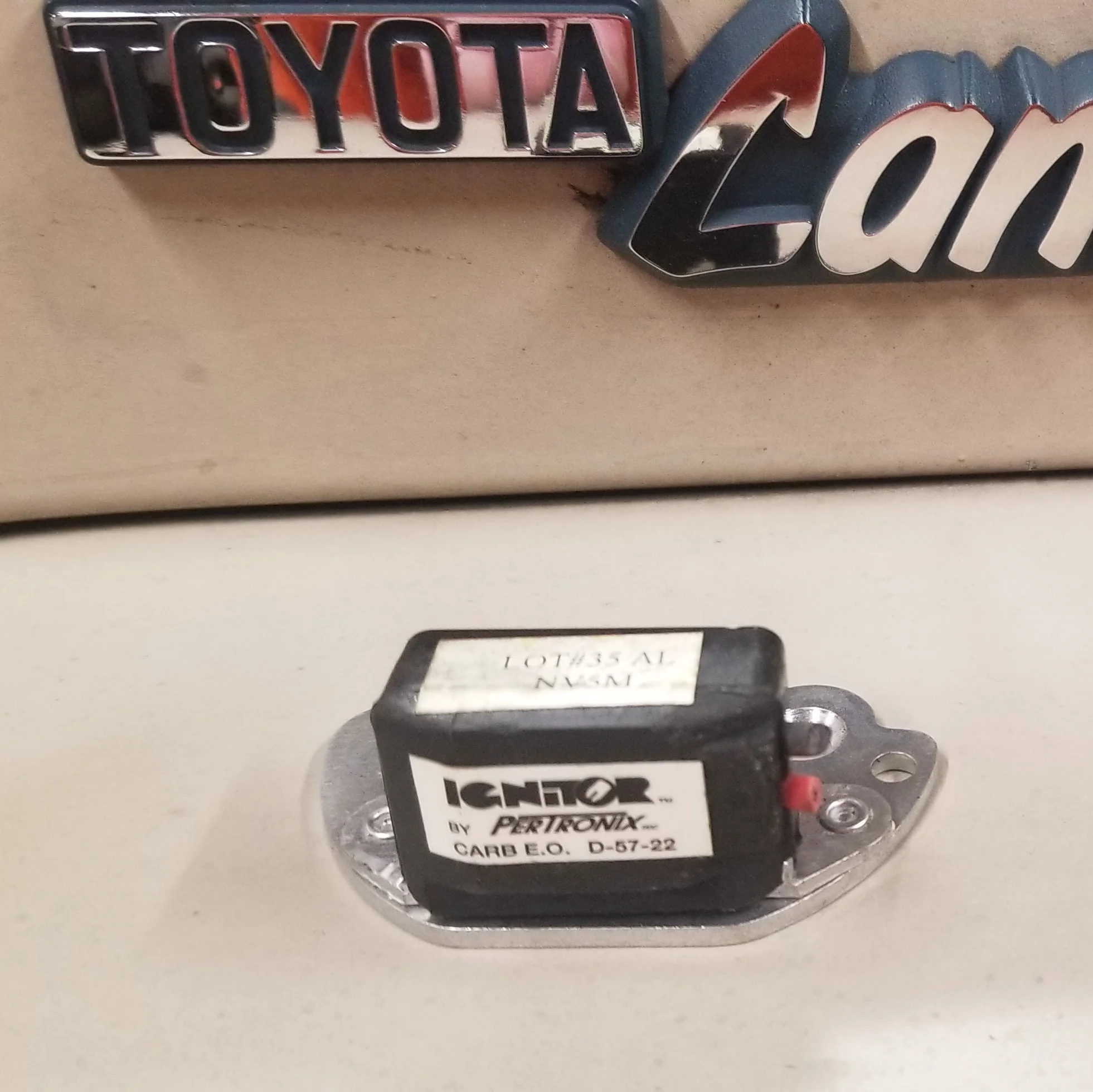

LS = Lobe Sensing

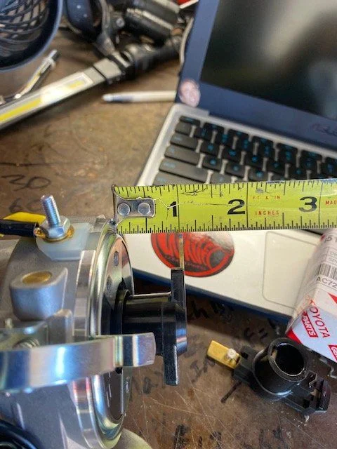

you need to Run the NON-Anti Over Rev Rotor , one on Left
thank you, I read elsewhere to use the rotor on the left was because it did not interfere with the pertronix unit, can you explain WHY to not use the one on the right? at this point just curious and always learning! assuming maybe the extra metal of the one on the right causes issues with the pertronix unit?
the little 2 Antennia things will interfere with the Pertronix kit

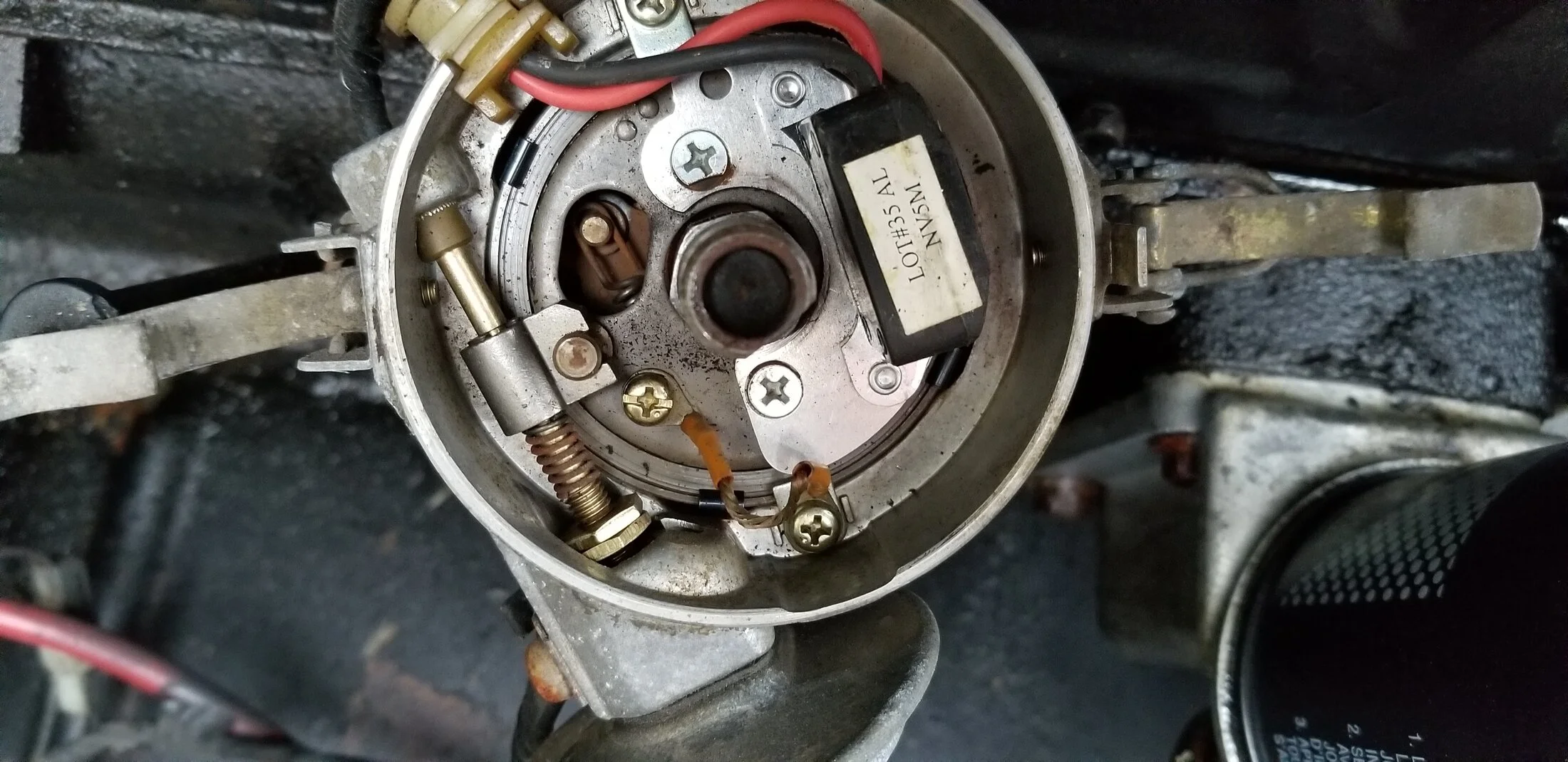

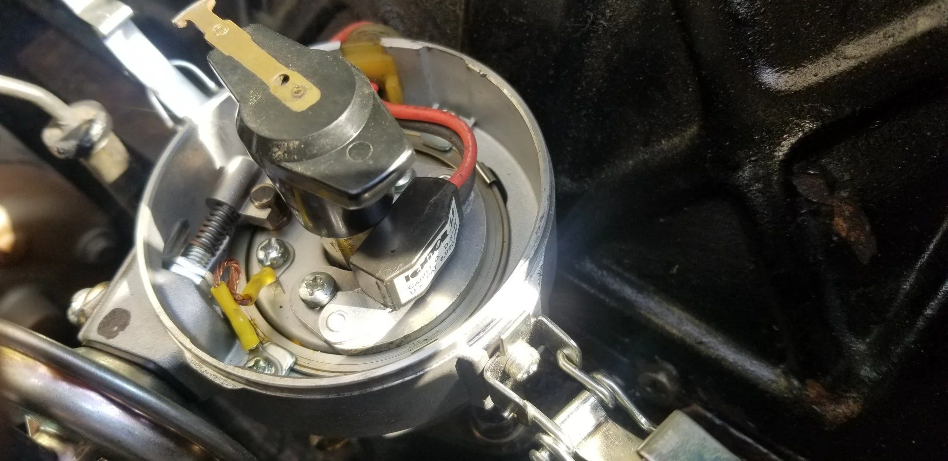

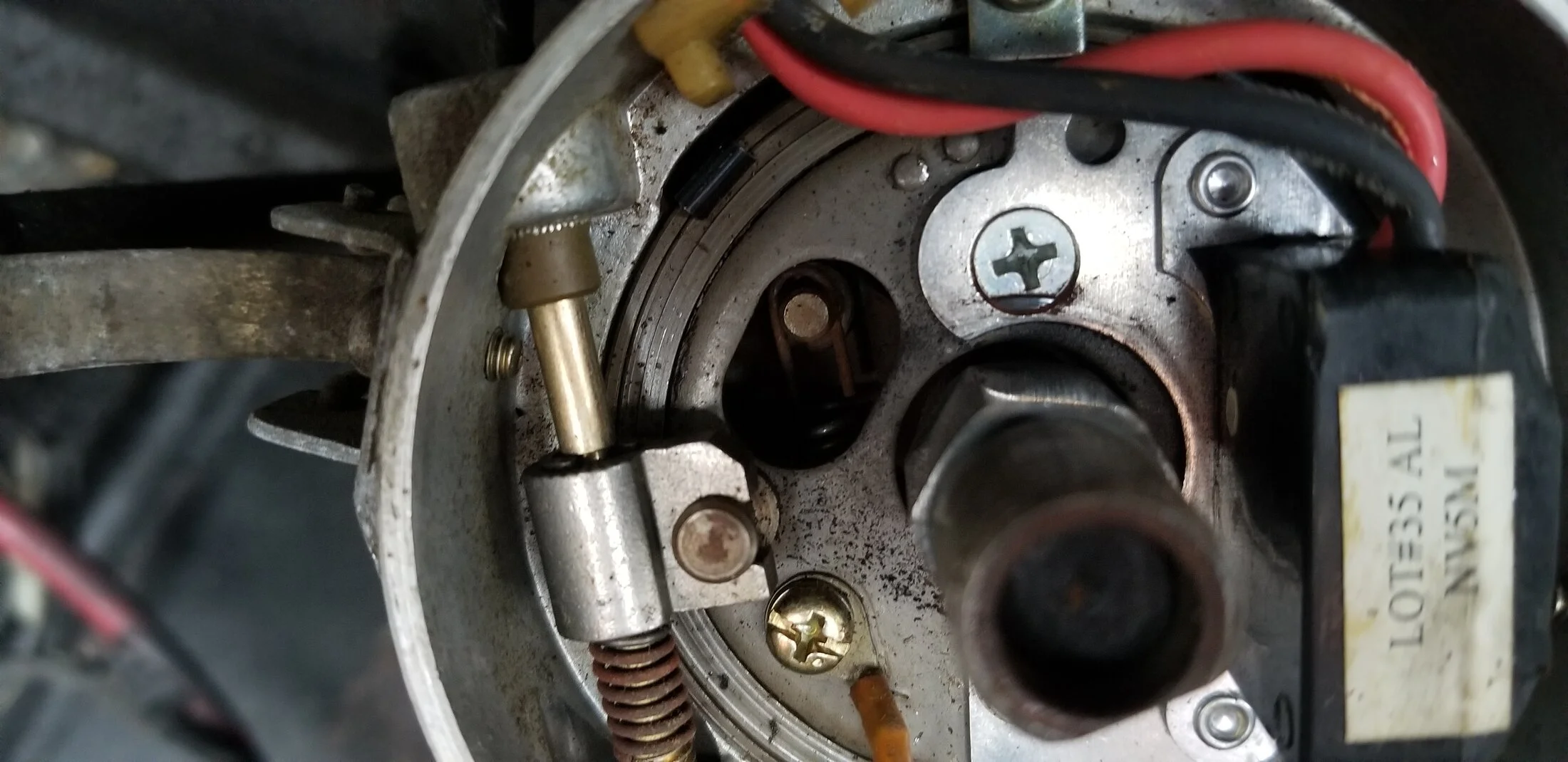

Hi All, well I thought I would update this. I tried the LS pertronix unit in the stock disty and could not get it to work. Something is amiss with the pertronix unit. We are getting weak spark. I pulled the pertronix disty and installed an aftermarket electronic distributor and the engine fired right up. I am going to contact pertronix on monday and speak with them. The other aftermarket electronic distributor comes equipped with the electronic module already in place. So far so good. I am guessing maybe the LS version just won't work with the stock points disty for some reason. I guess it is also possible I got a faulty module?
That is not correct.
It works just fine.
You need to replace the rotor.
I used the specified rotor. I am simply reporting my findings at this point. Pertronix has told me that this module does not work with the distributor number I gave them and it did not work in the distributor from partsouq. They have told me to use the standard 1662 module.
So this goes back to unit probably being defective.
The LS works just fine in mine.
The LS stands for Lobe Sensing
I bought the first pertronix for the new 61180 dizzy many years ago when racer started offering it
The center magnet disc in the old kit part # wore a hole groove deep in. The center under it
I worked with a tech at pertronix to find a solution
They mailed me several different kits
Only the LS lobe sensing kit with NO center magnet disc worked as it should they also coughed up for a new replacement 61180 without being asked in any way
Also wrote me a check for the original non-LS kit
See the 61180 is a MED cap dizzy and the old kit was based off a USA spec med cap like on a 77-78 FJ40
That’s a class act company and I believe in the pertronix brand name 💯 %

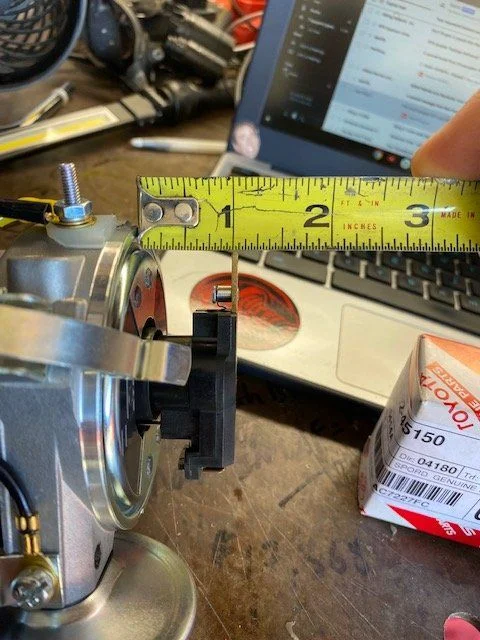

19102-45150, retail $14.30. Same rotor for US market 2F distributors from 1/75 through 8/80. Also works with non-US 19100-61080 and even the non-US 3F 19100-61180.
