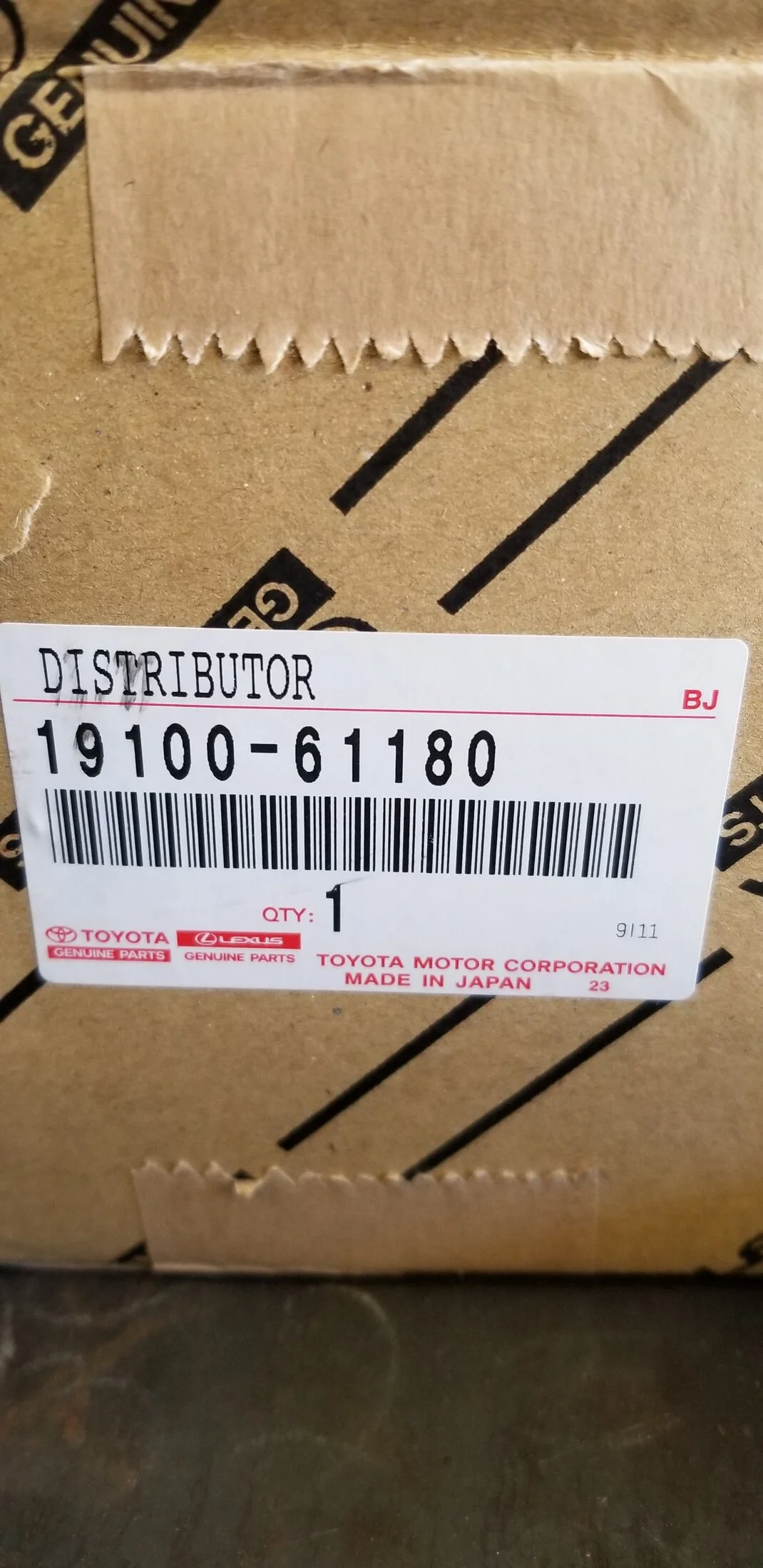

I just got off the phone with a tech at Pertronix and he claimed he had no listing for the 19100-61080 distributor using that part number other than the standard 1662 ignitor, and he wouldn't guarantee fitment with even that number. He claimed he needed the actual distributor number, and not the Toyota part number. I gave him the Denso number (029100-7562) on the sticker on the distributor and he said he had no listing at all for that number. He was not very friendly about it.

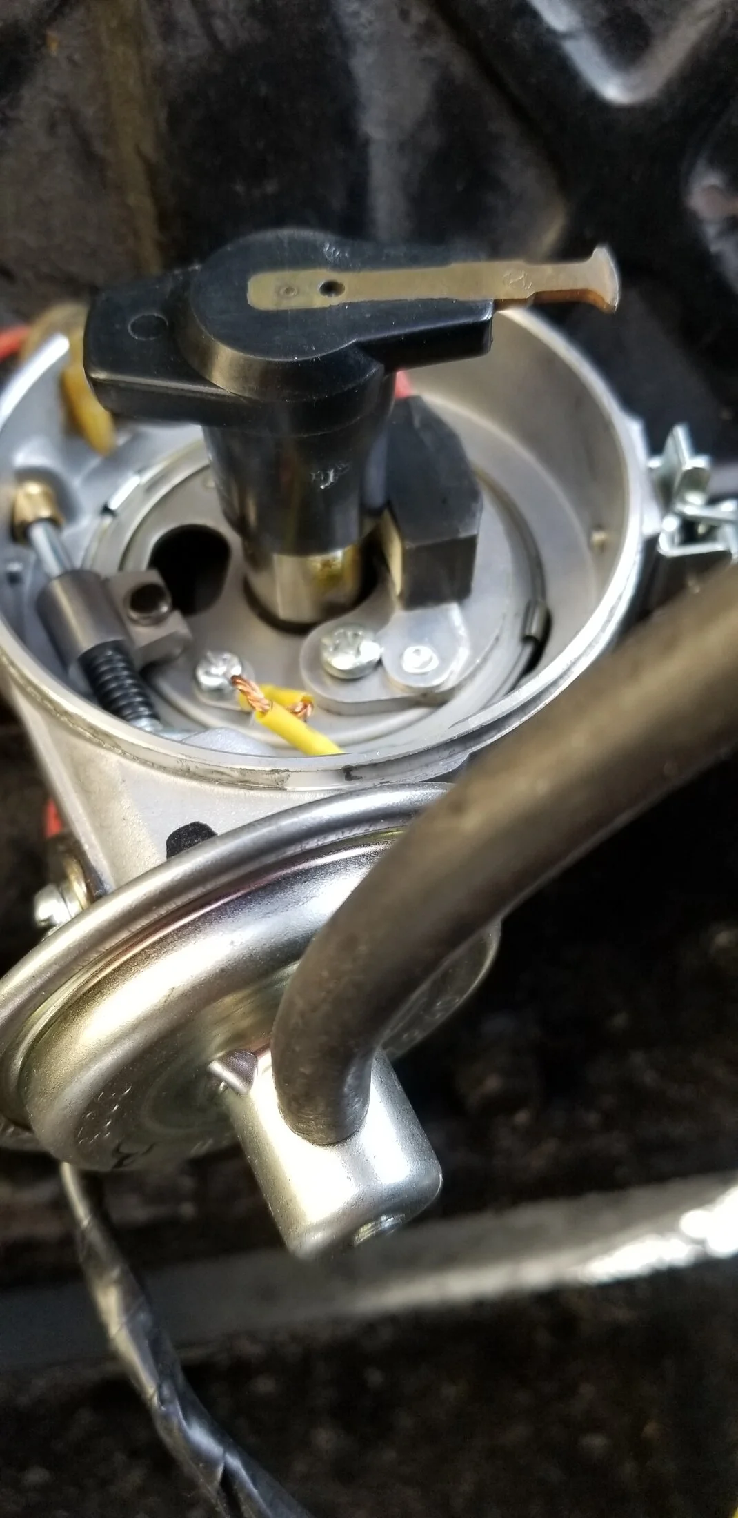

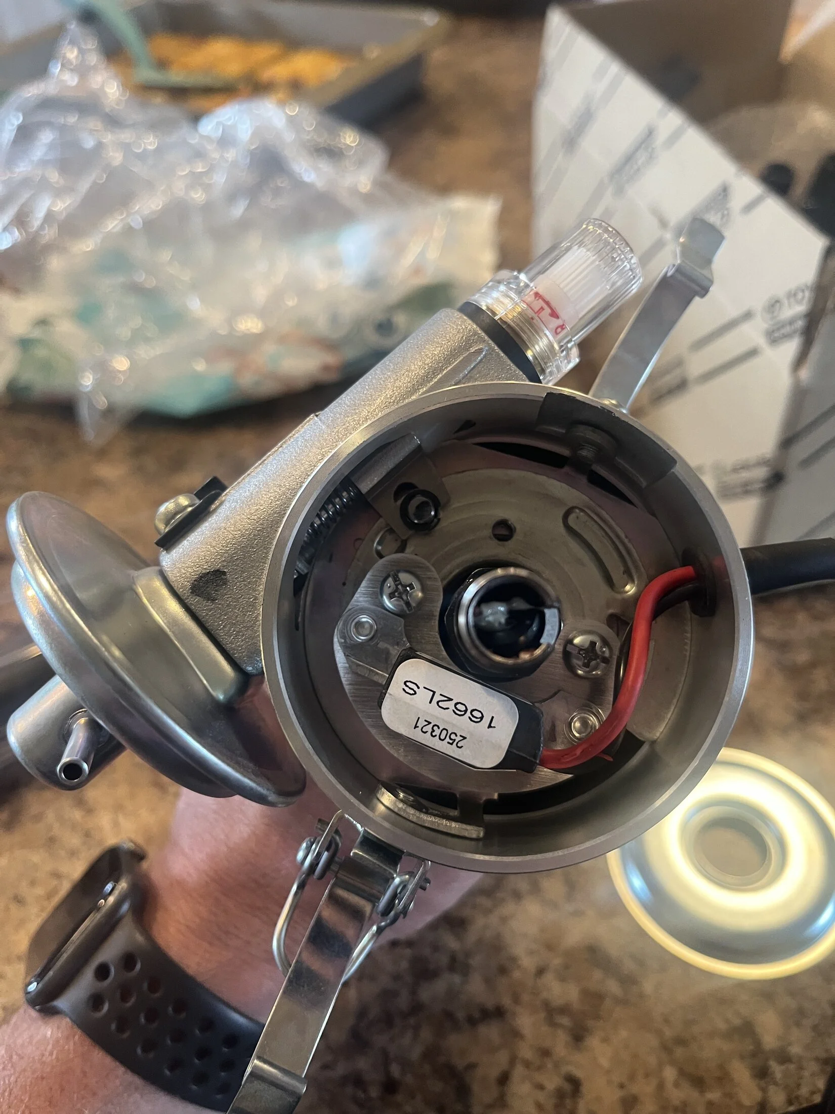

Just a follow up with this, purchase the non us vacuum advance distributor from city racer and Pertronix ls kit, and everything worked perfectly, so simple, my cruiser had a vac retard unit and older Perteonix unit so I didn’t have an igniter, Pertronix was wired directly to coil, so I didn’t the same with the new units and it fires right up and runs so much better with the vac advance. Highly recommend.

Updating for anyone in the future: 1662LS is a first edition and 91662LS is a newer/second edition. 1662LS has fixed dwell and like points if you leave the ignition in the on position it will burn up the module as if it were points. The newer Ignitor II has adaptive dwell and has a safety feature that prevents the burn issue if the ignition is left on. The tech recommended that I go with the 91662LS so that's what I'm doing. Will report back with results once installed. :beer::beer:
