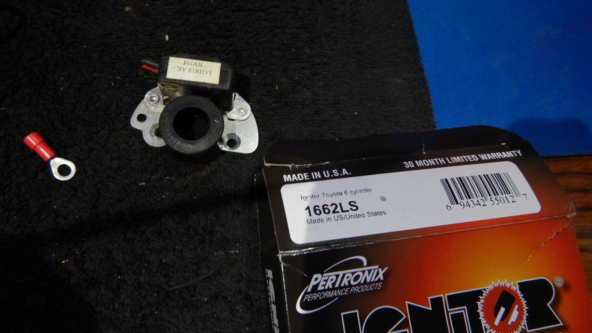

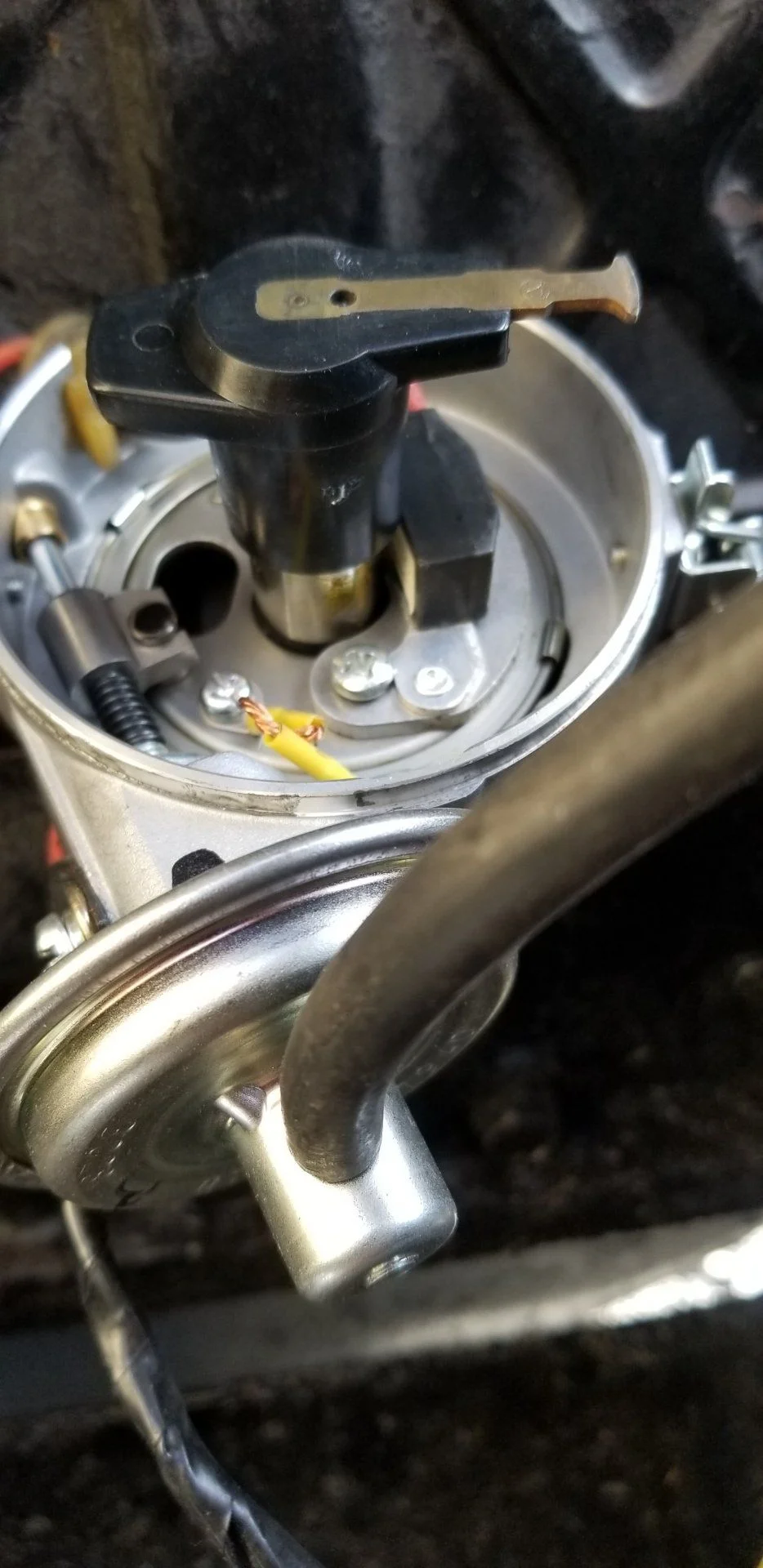

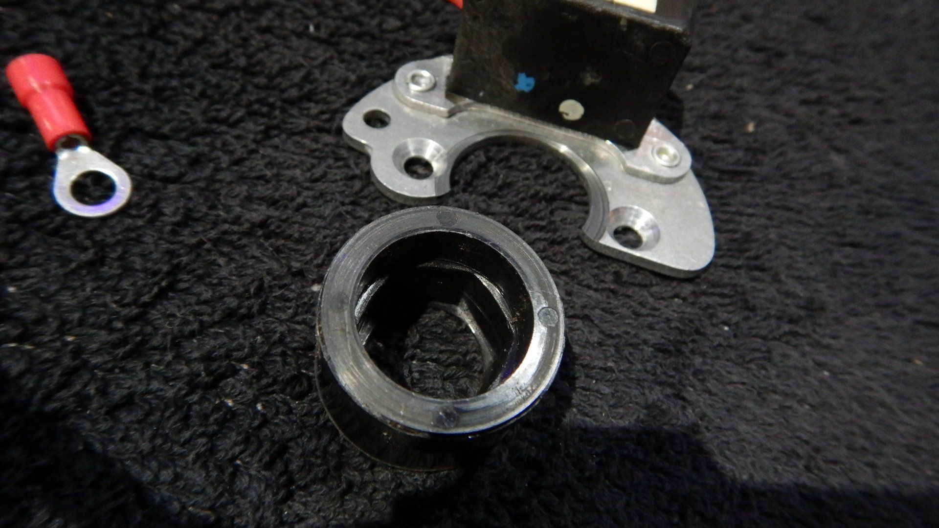

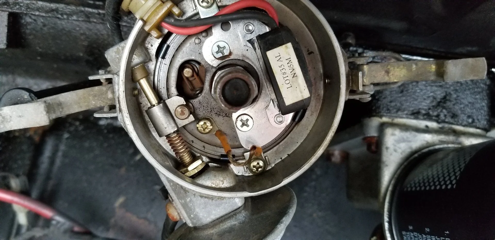

View attachment 1870633 View attachment 1870634 View attachment 1870635

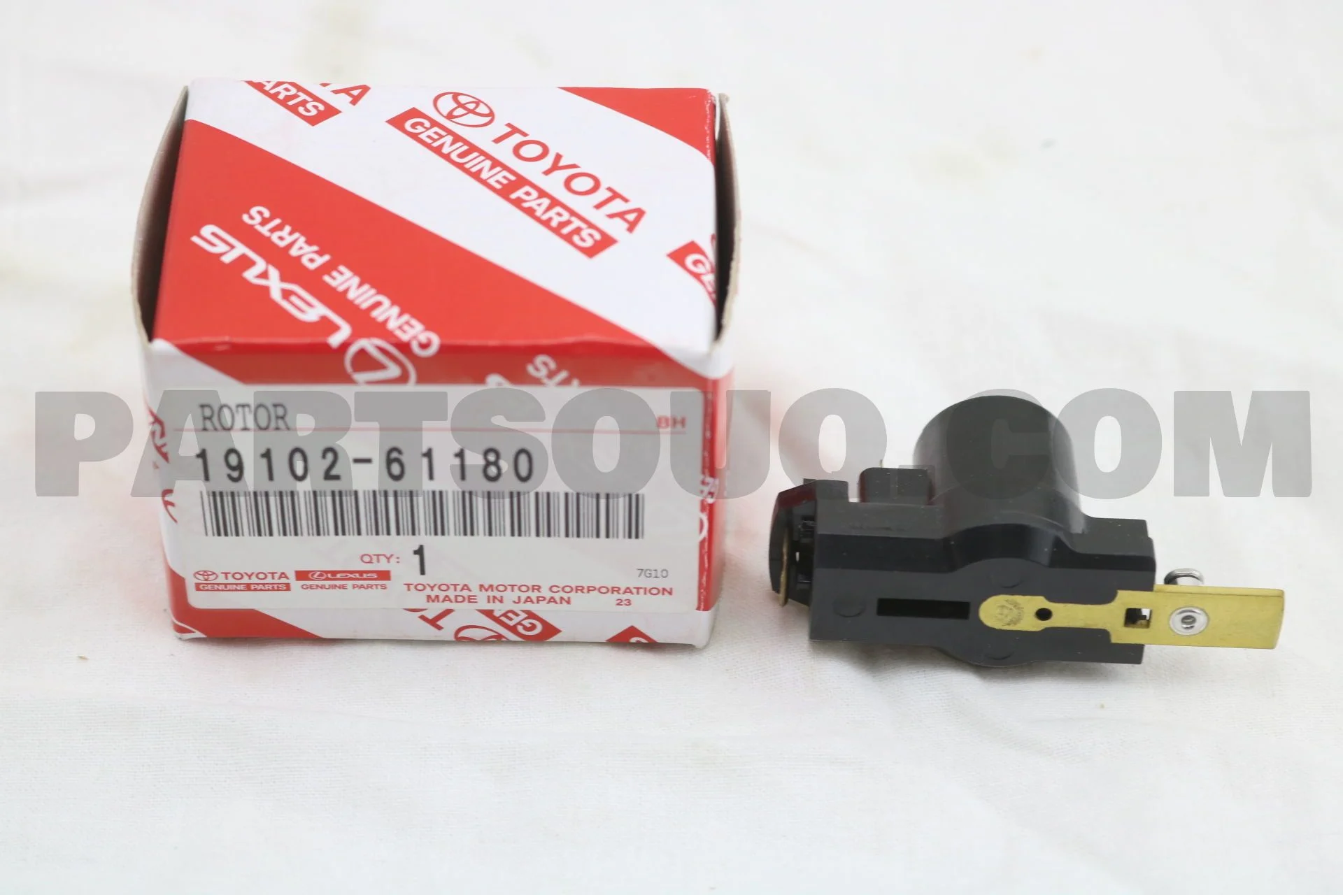

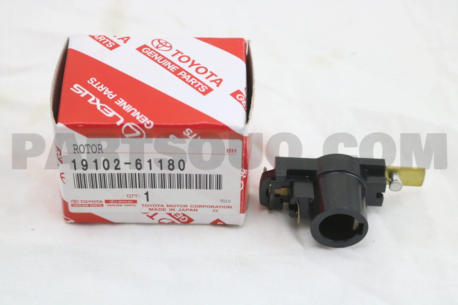

I have a 61180 dizzy, with a 19102-61180 rotor link with image below). With this combo the best would be the LS version as I understood.
1910261180 Toyota ROTOR SUB-ASSY, DISTRIBUTOR Price: 25.87$, Weight: 0.038kg - PartSouq - Auto Parts Around the World
