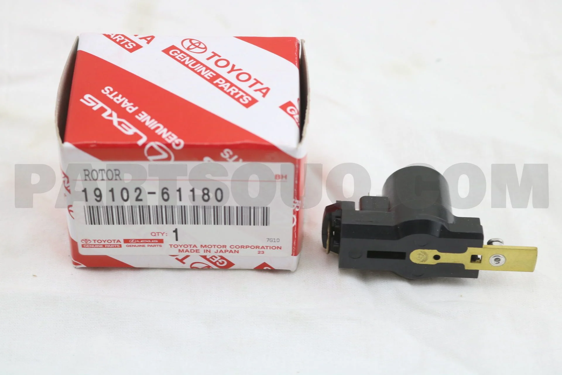

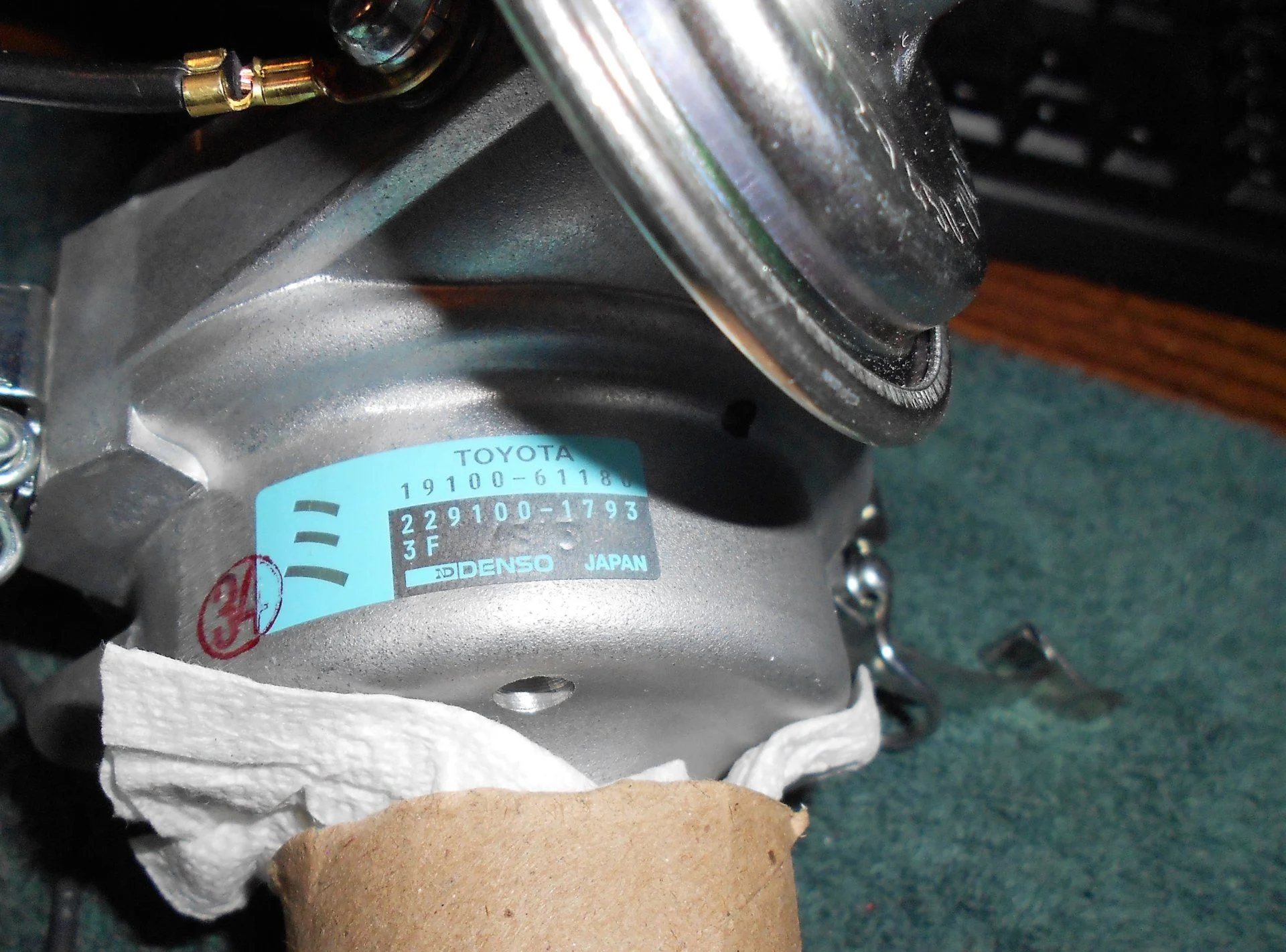

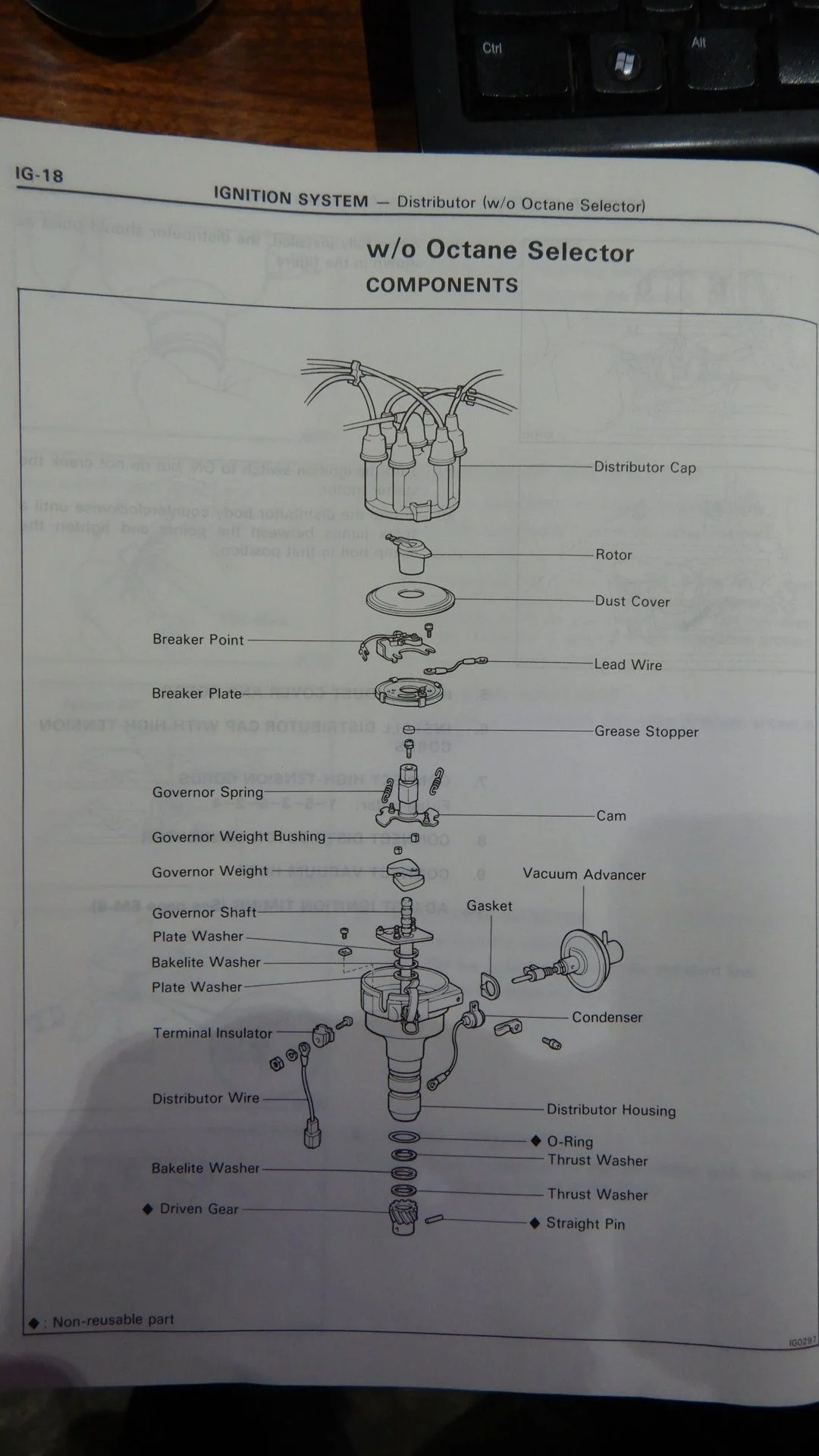

The 3F dizzy (19100-61180) I have has the small rotor, the rotor part number is not available anymore (except from two websites with outrageous prices).
So does anyone know another car that has a similar dizzy and rotor (and the cover under the rotor, see image), either a Toyota car or otherwise.
Thank you all.
i used a 19102-45150 based on what @Splangy is talking about,
on my 19100-61180 Distributor , it does lack the anti over rev little feelers features , but i did not notice any difference

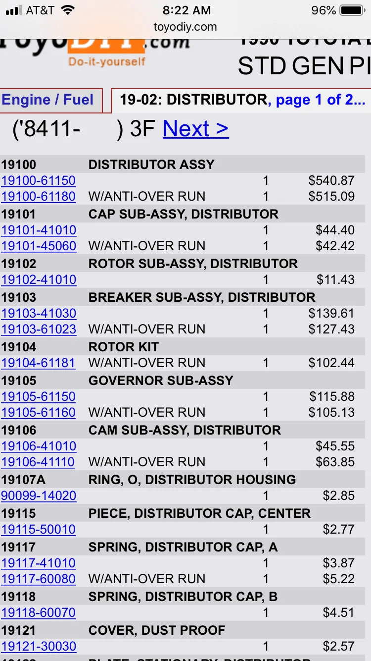

I realize you're in SA, but is there a reason you wanted that Rev-limiter version of the rotor ?
I wonder what the rev-limit is ? @RAGINGMATT any idea?
But nice to find an exact replacement.

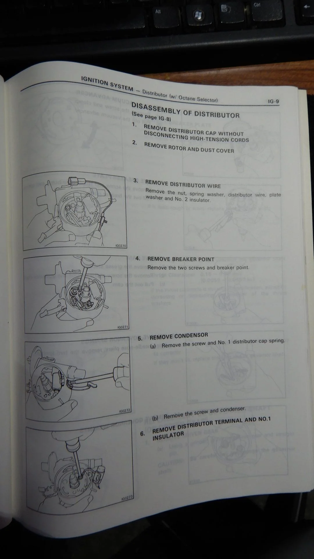

How i understand the anti over rev. feature option to be :
it's for when your going down a steep hill for example , it will cut OFF the spark to the plugs , so u dont get going too fast or get too many exceeding RPM's of the engine spec's on the 3F in a 70 series for example
at least thats how understand it after reading My 1984 3F FSM i got a while back
yes , i said 1984 3F engine FSM OEM Toyota .....................;)
simply an Amazing Book !

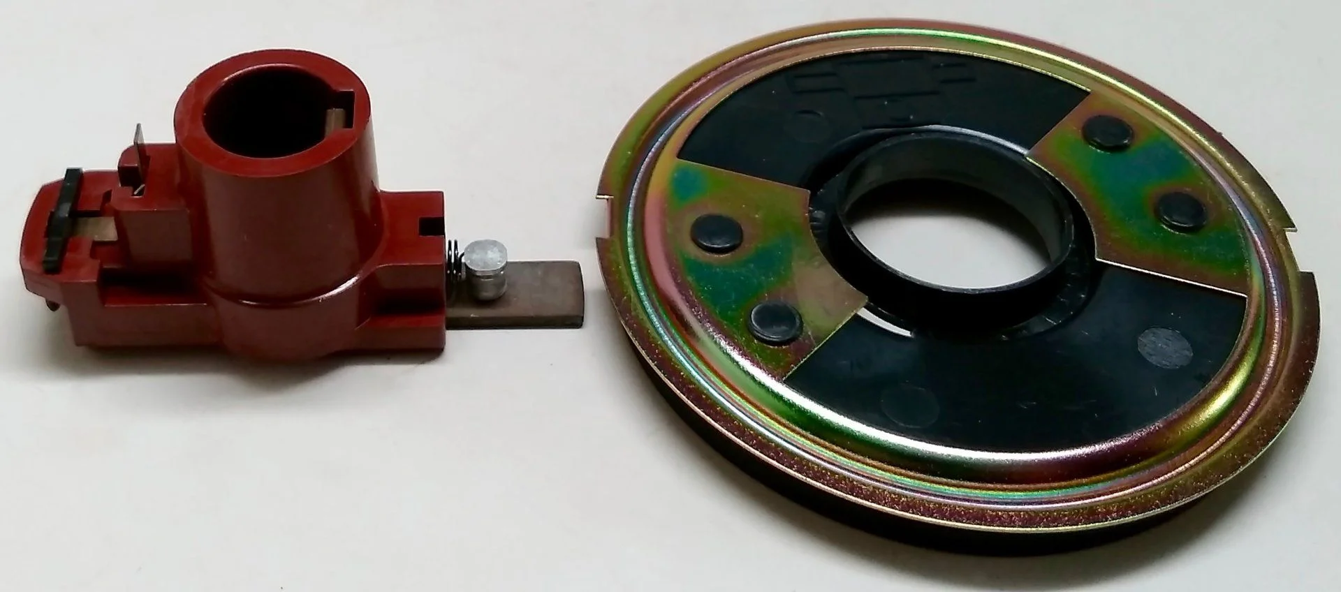

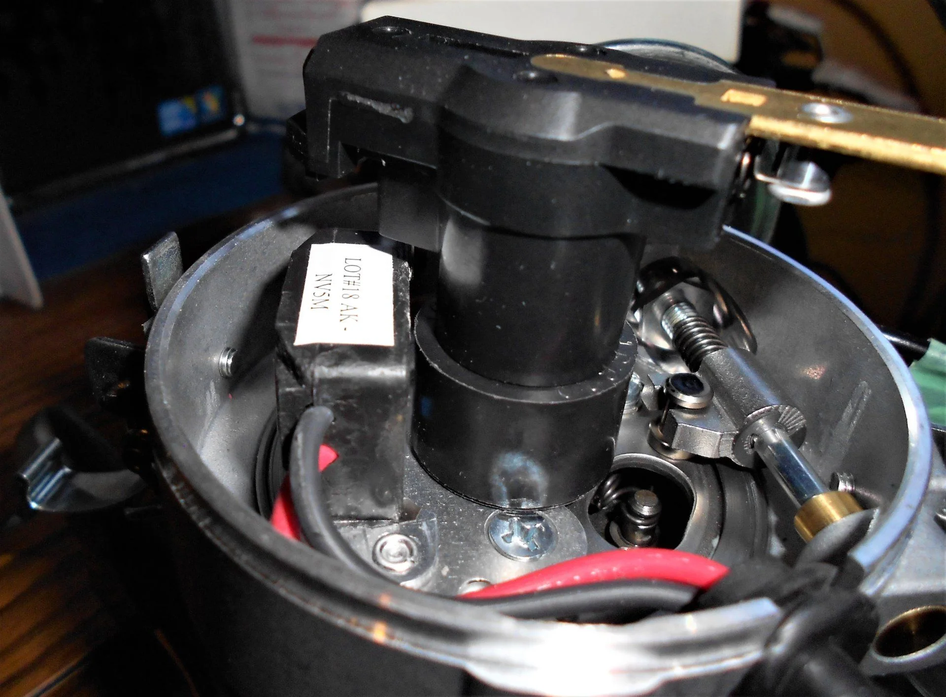

Why does this look so much different from the rotor in my distributor?? Mine's totally stock on a non-California 3FE.

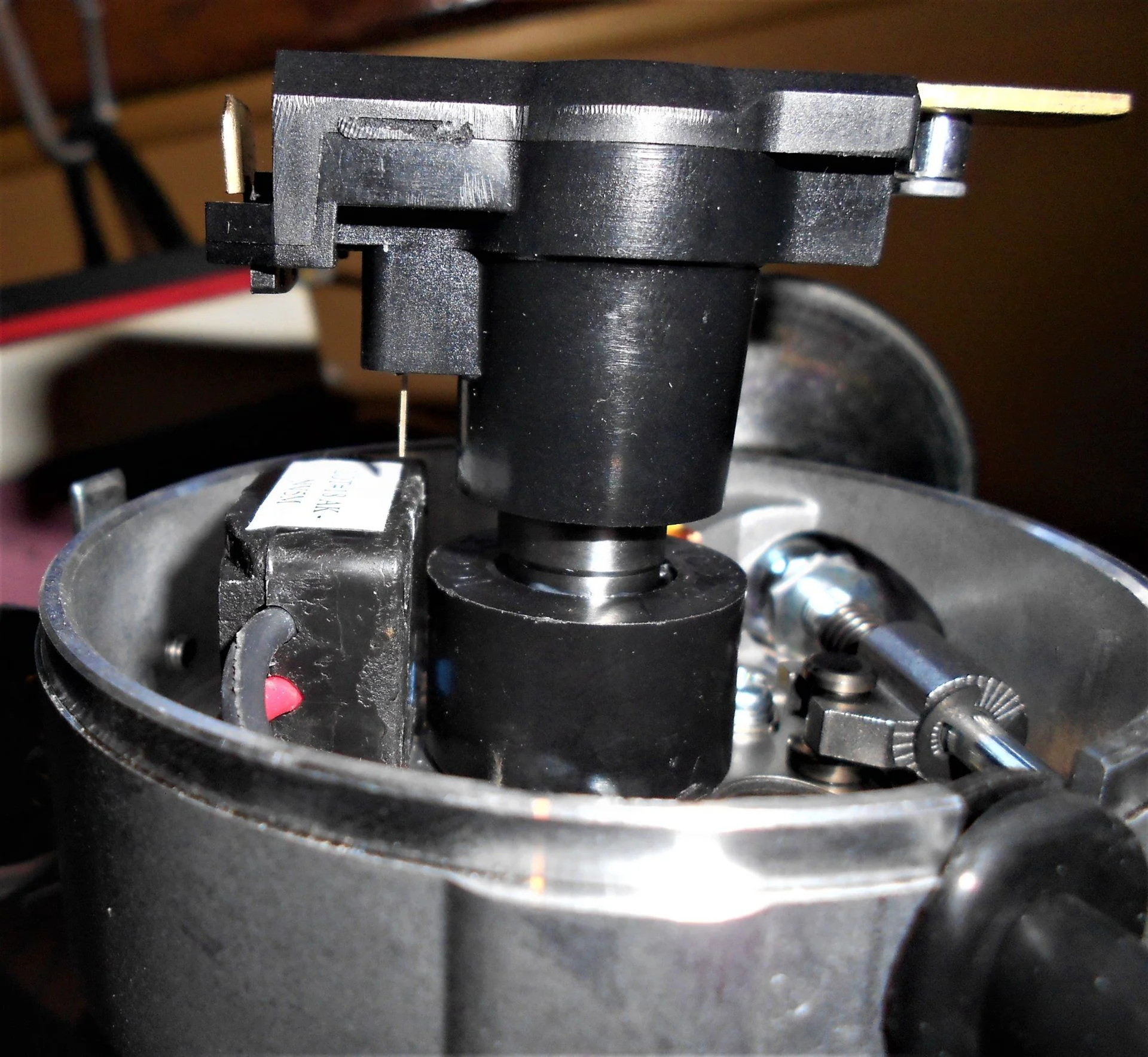

This is why a substituted Rotor becomes required , while installing Pertronix Kit into the 19100-61180 , i ran into a interference issue
between it and the new Igniter assy. box .
the Updated OEM Toyota Rotor solved the problem in short order

I believe the rotor that comes with the 19100-61180 distributor is 19102-45150.
What updated rotor did you put in? You have interference issue with the 91622LS kit?

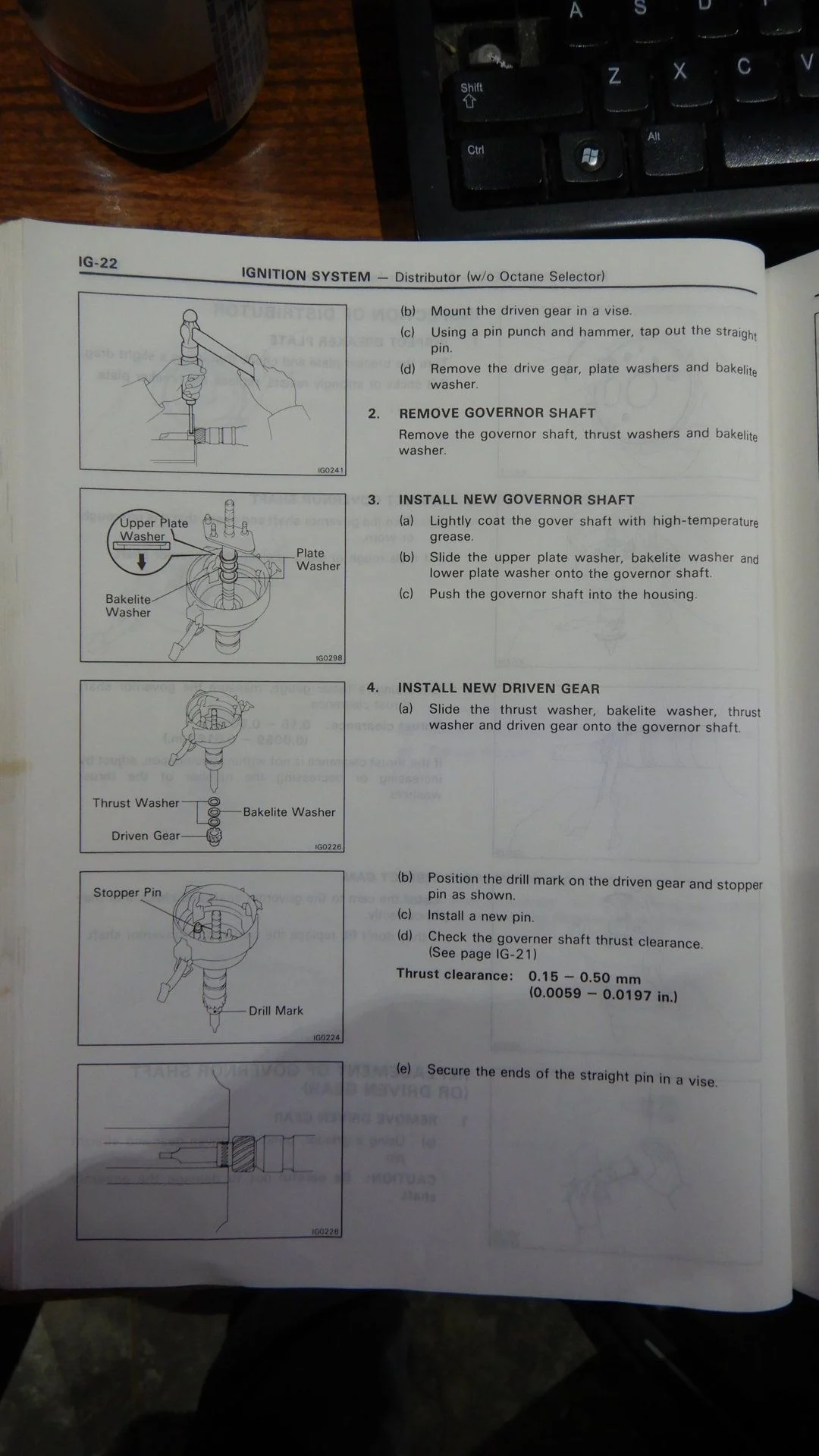

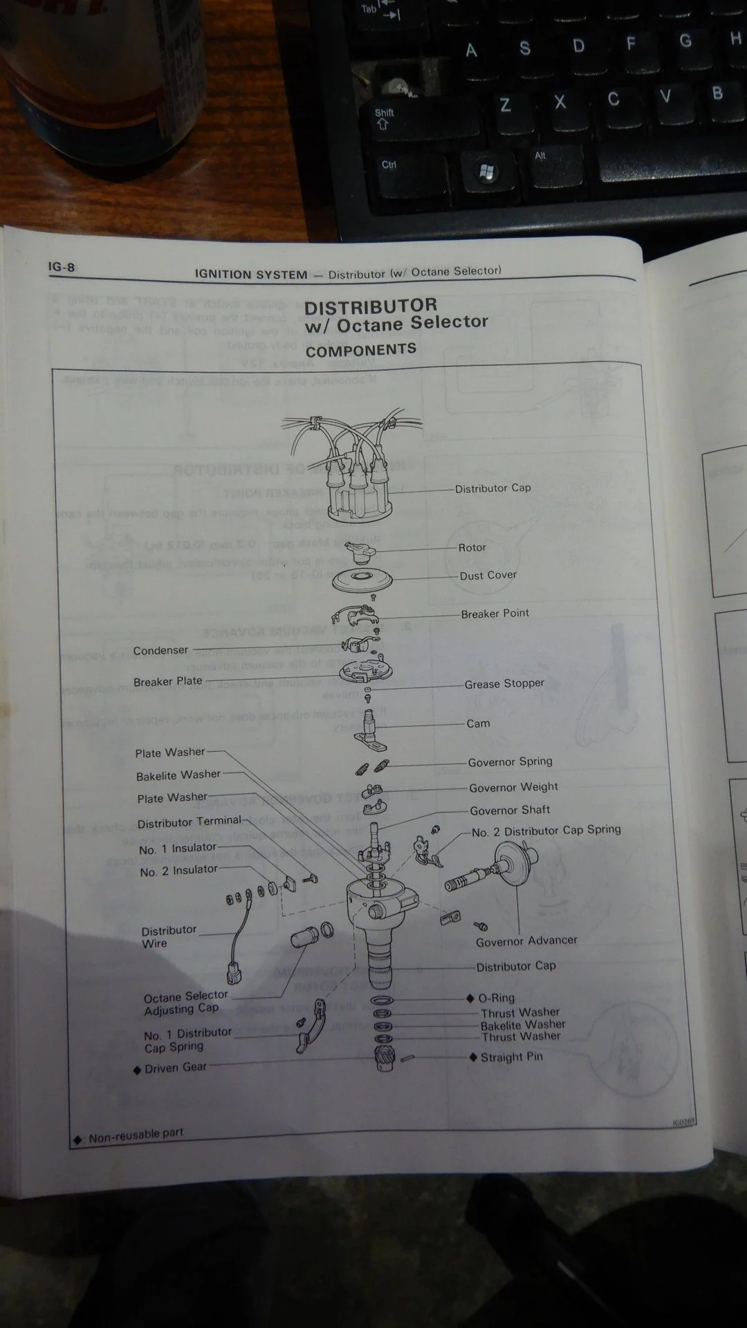

So not to derail the main topic here. What is the difference between the US Spec distributor and the carb 3F version used in other countries? Am I seeing correctly that the 3F ditributor can be adjusted for bad / poor gas in countires where fuel quality is less than ideal?
Lots of interesting info in the pages you posted from that FSM.
Was this Pertronix clearing rotor part # ever disclosed? Is it 19102-45060?
