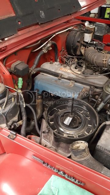

Correct me if needed (or not). The 3B diesel puts out about 90 hp,
How much more do you get with a 3BT? I've always wondered about that cause now I have 165 hp 2F but always wanted a diesel just not sure about the HP drop.

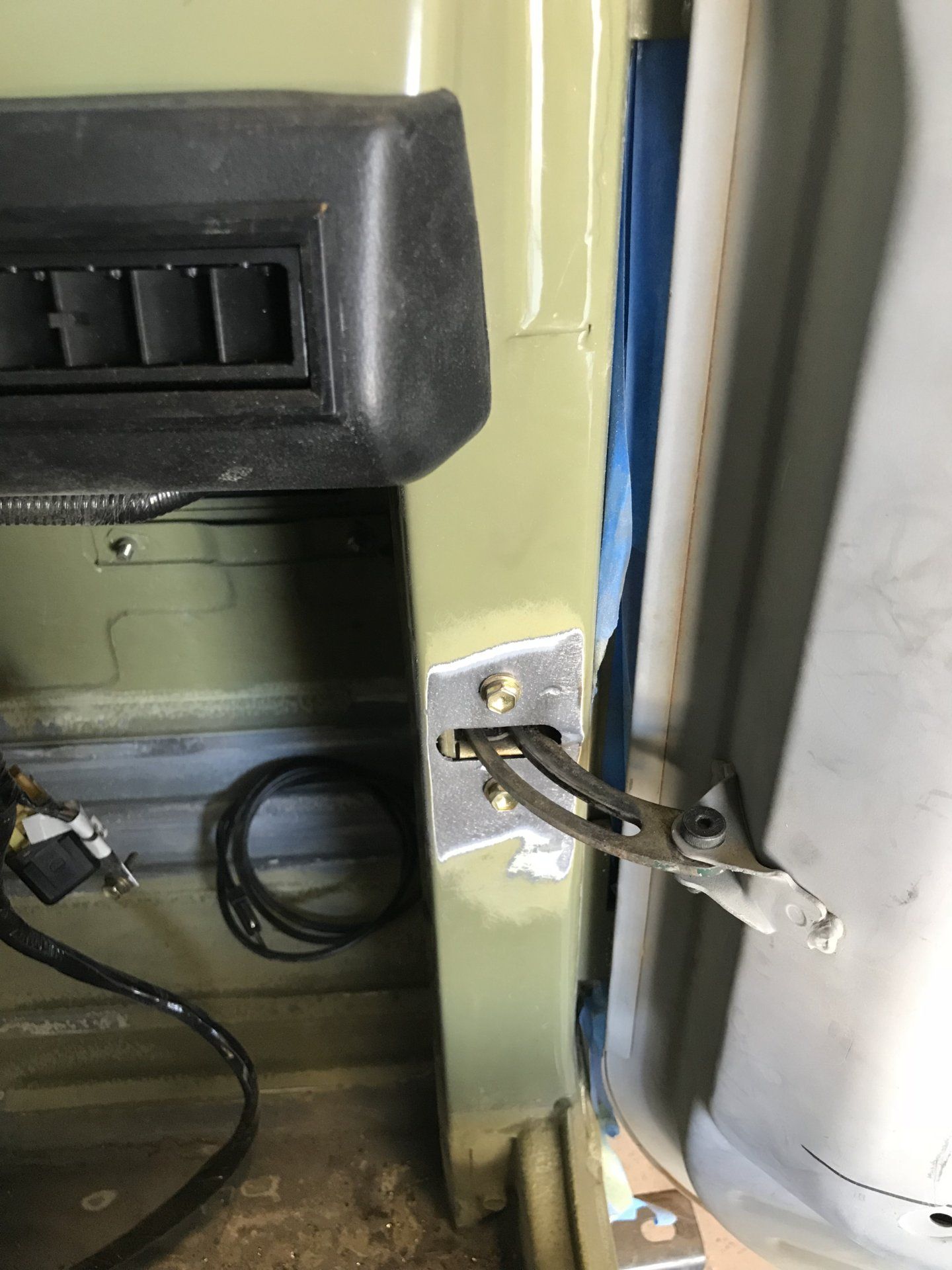

Just got done modifying the tub to accept late-style door stays in anticipation of upgrading to ‘75+ doors this spring.

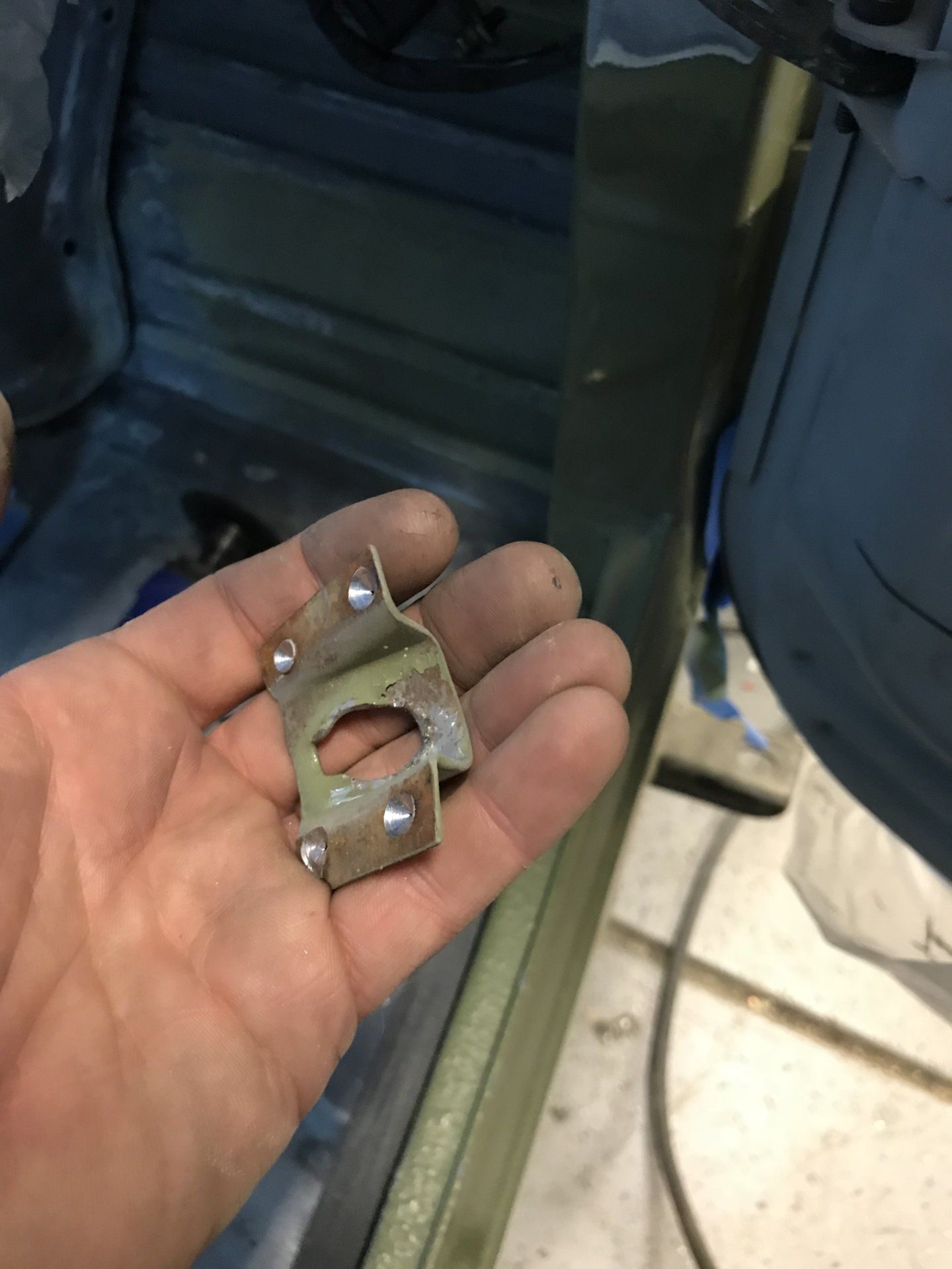

Not the most fun I’ve ever had. I had hoped to just carefully enlarge the hole and drill for the mounting bolts without damaging the paint, but it was not to be. Toyota spot welded angled reinforcing brackets in a very inaccessible spot that had to be removed in order to mount the new stays.
A little MIG action, some grinding, and drilling saw to that.
I’ll have to patch paint (obviously) but I’m nontheless glad to have this item checked off my laundry list.
