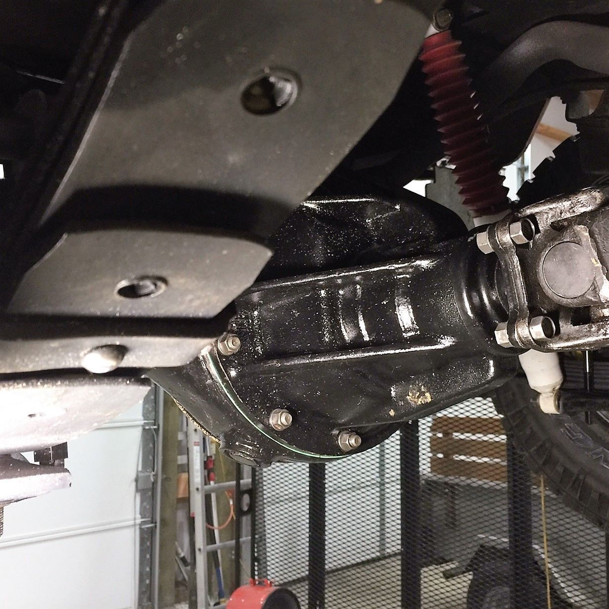

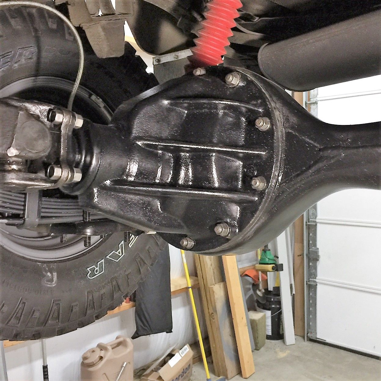

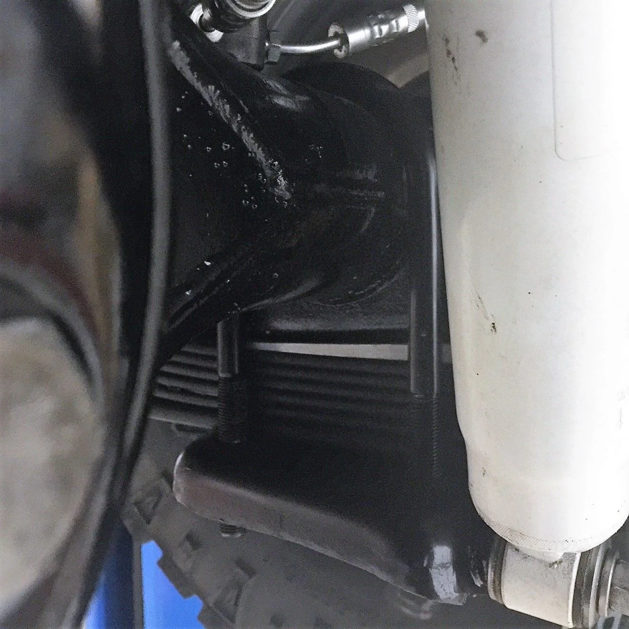

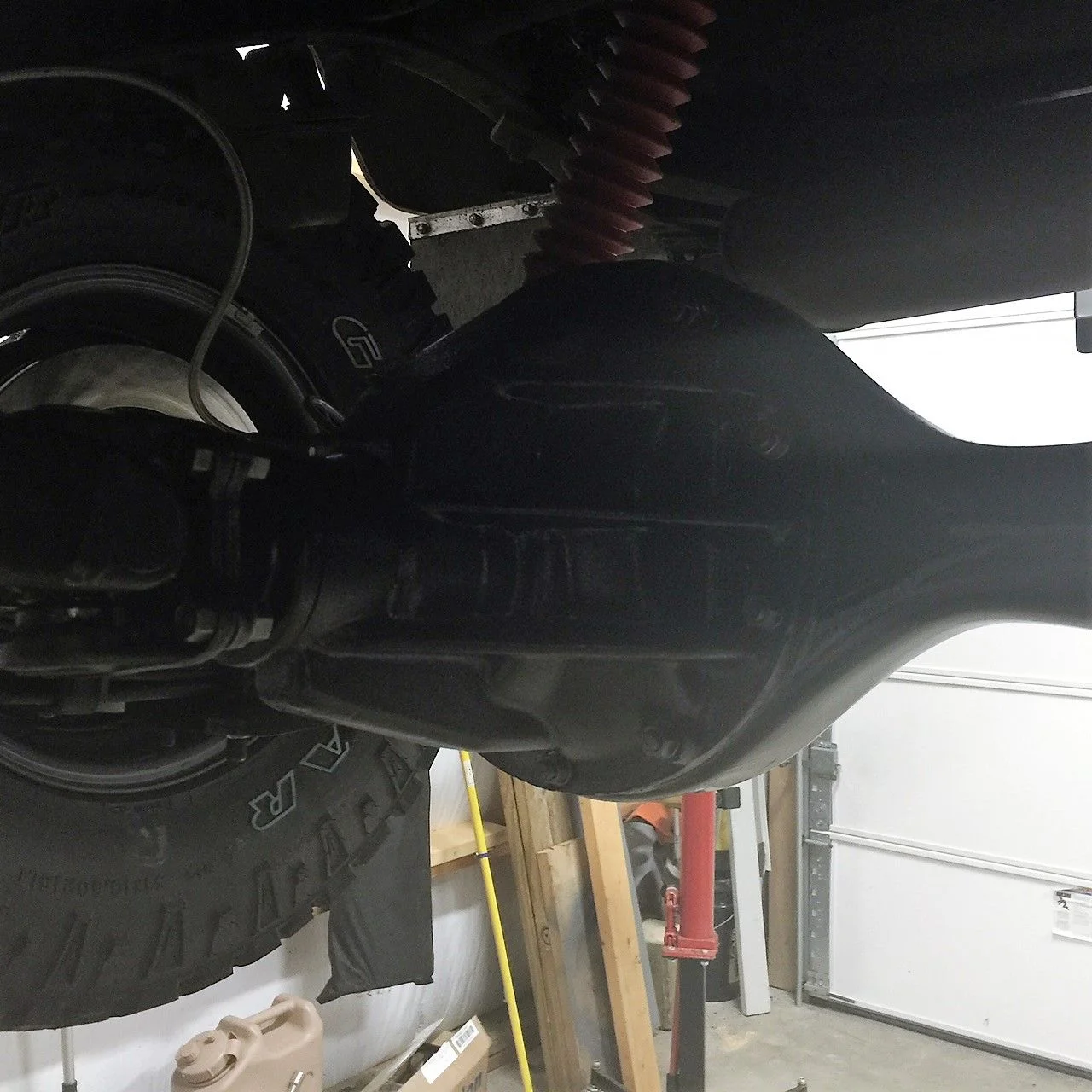

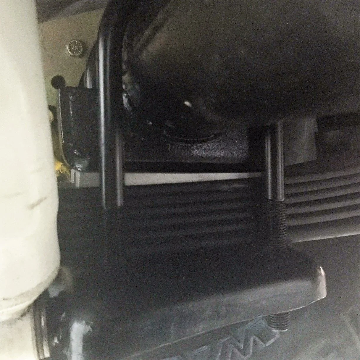

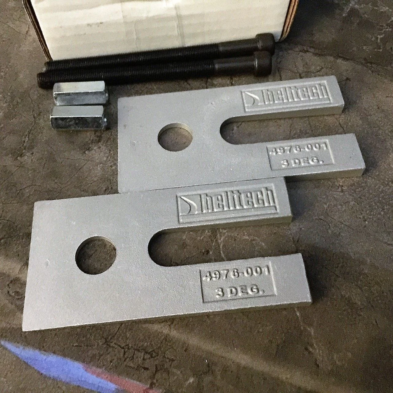

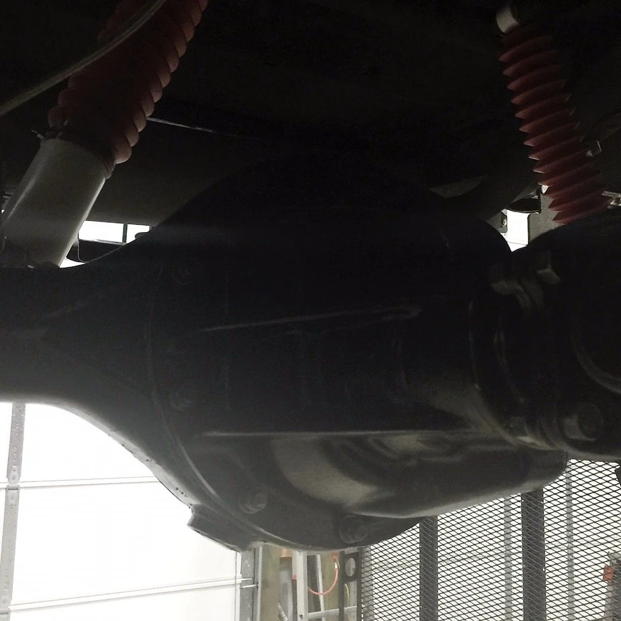

Today I installed the rear spring shims to correct the drive line angles. Used 3* degree Belltech shims and I'm happy to report the drive line angles are once again pretty close to perfect.
Here are a few of before and after pics, used the exact same reference point for taking the before and after pics.
Before
full
After, sorry for the dark exposure
full
Before
full
After
full
full
full
Belltech shims
full
Unfortunately, I ran out of time since familial matters take precedence over work on the 40 and as such will have to re-schedule a test drive at another time/day to measure success or failure of this mod. The primary reason for the road test is to detect audible and mechanical vibration emanating from the pinion drive line area. I've been experiencing an increasing speed sensitive vibration since the OME springs, with a 2.5-inch lift, installation.

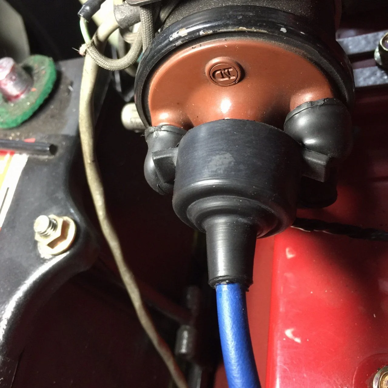

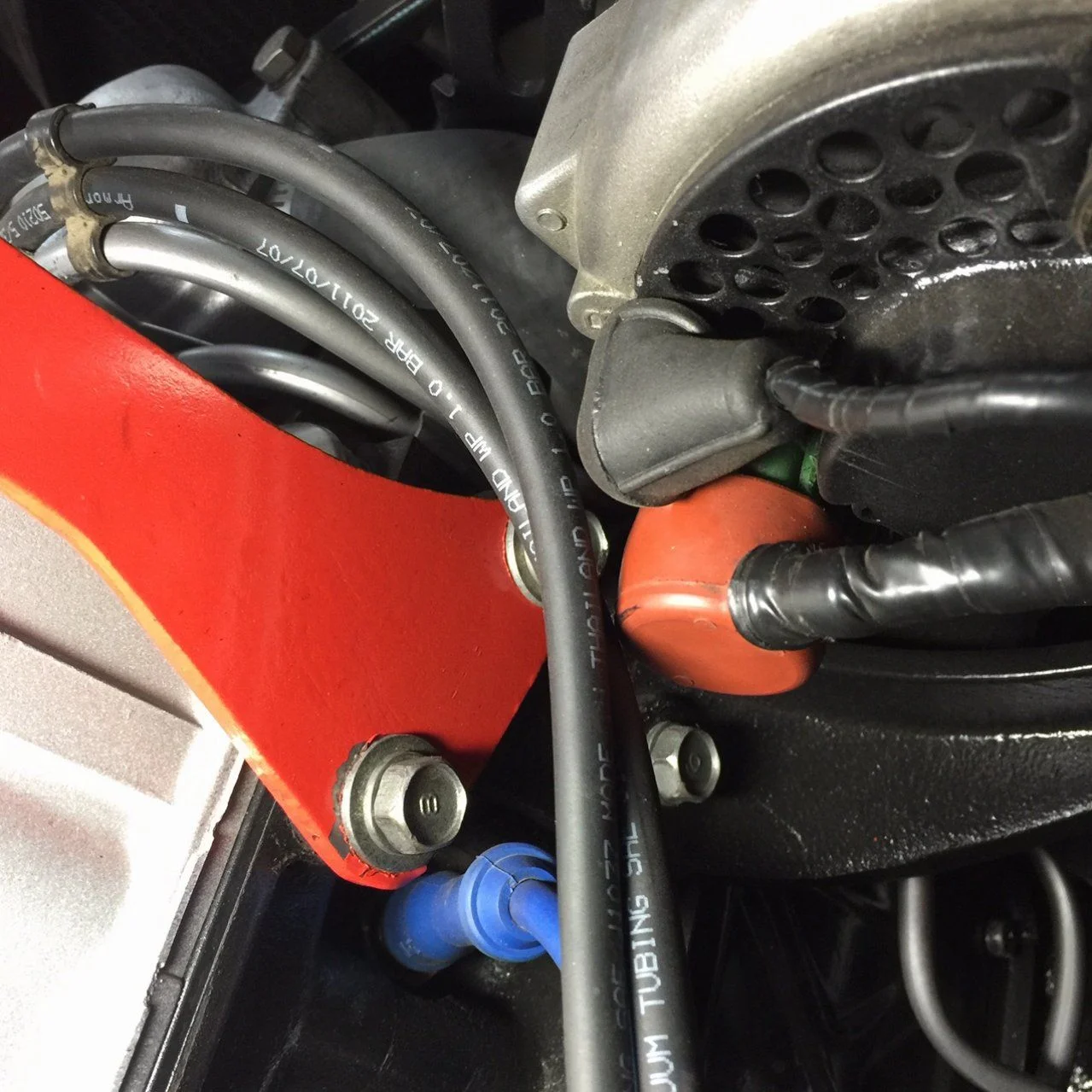

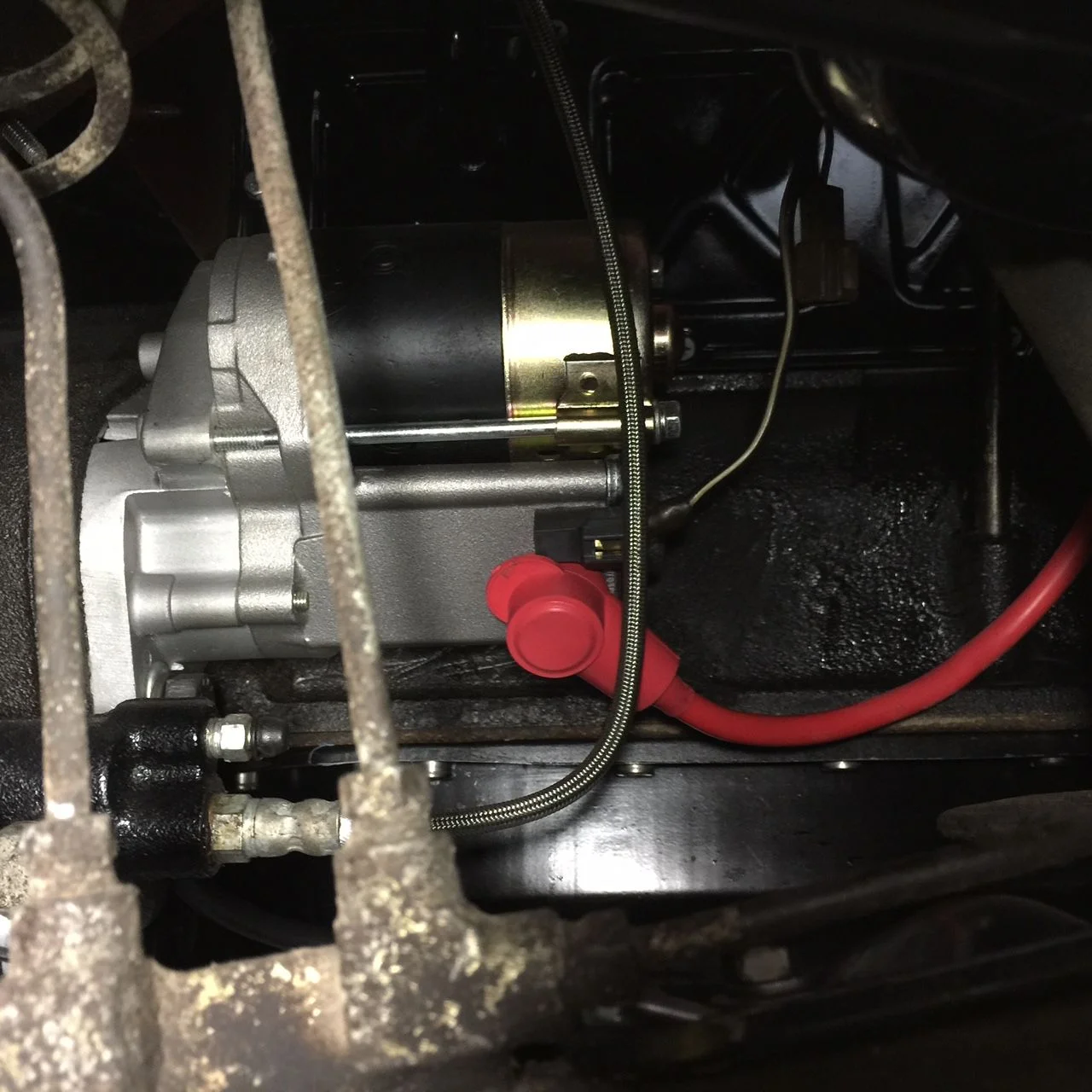

Also installed several electrical boots which I purchased from @Coolerman
full
Ignition coil boots installed

Alternator B+ terminal boot installed
full
Starter +lug boot installed
full
