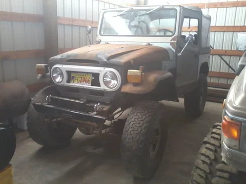

Lengthened my drive shafts, and moved my 40 under it's own power for the first time in over 5 years. crappy flip phone pics attached.
