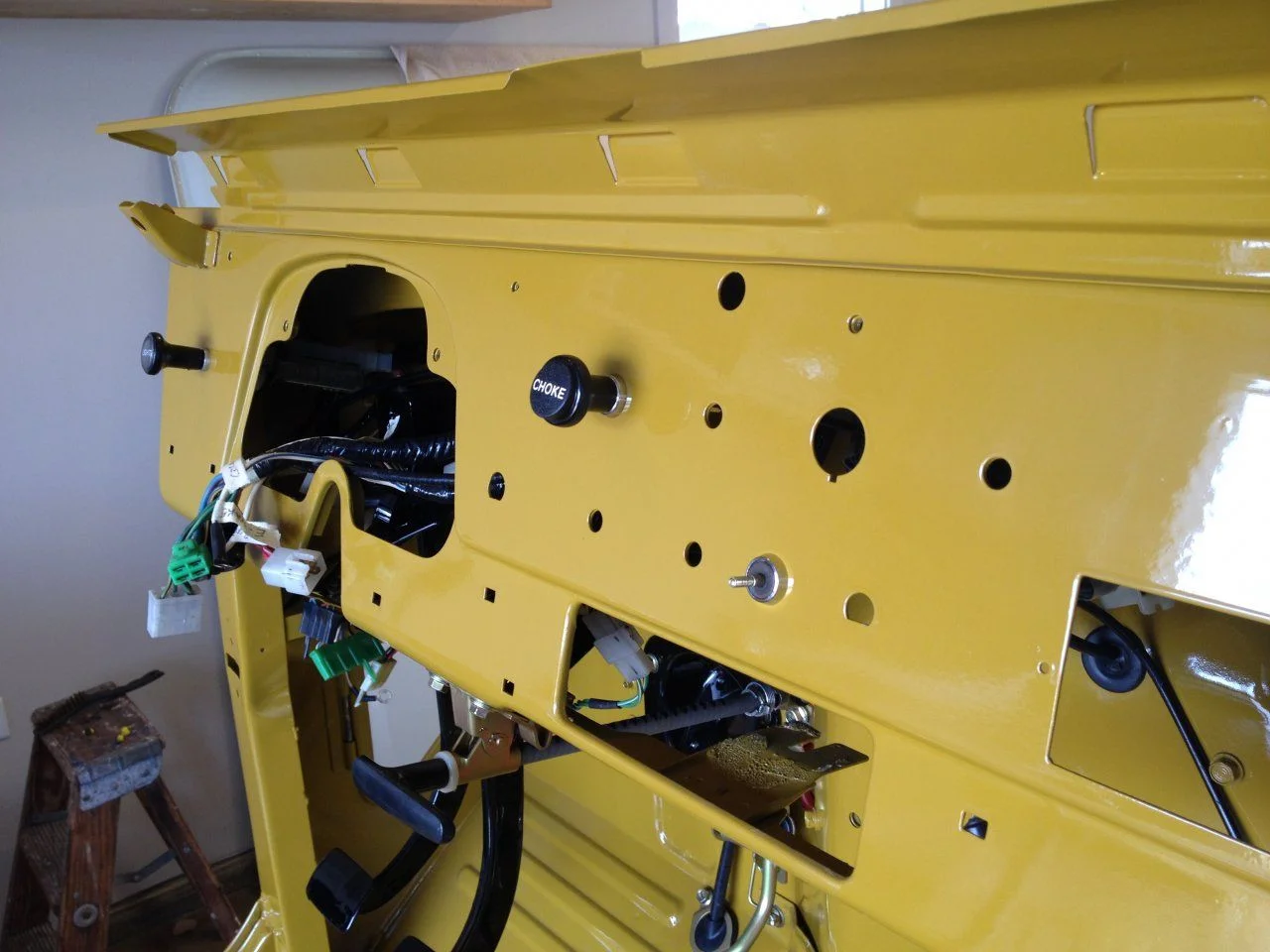

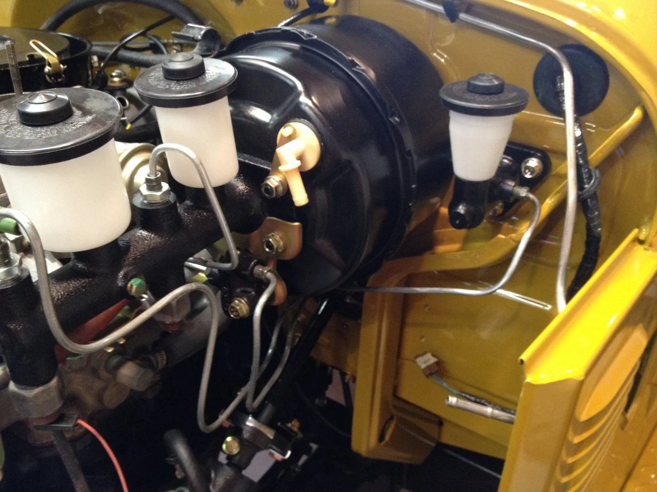

Got my new masters on and plumbed the lines. I ended up spraying the masters with a couple coats of Rustoleum semi-gloss black so the machined areas would not rust.

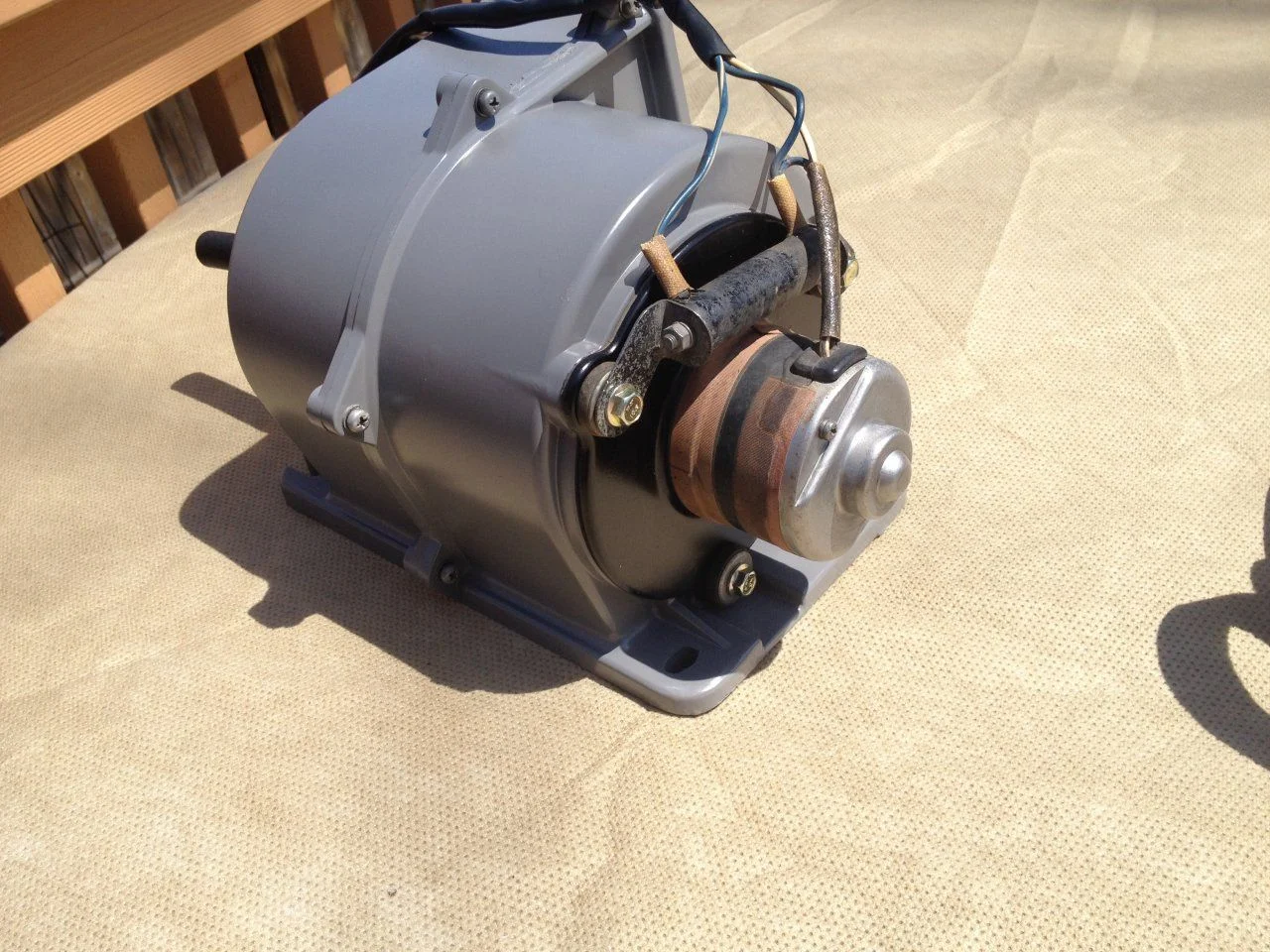

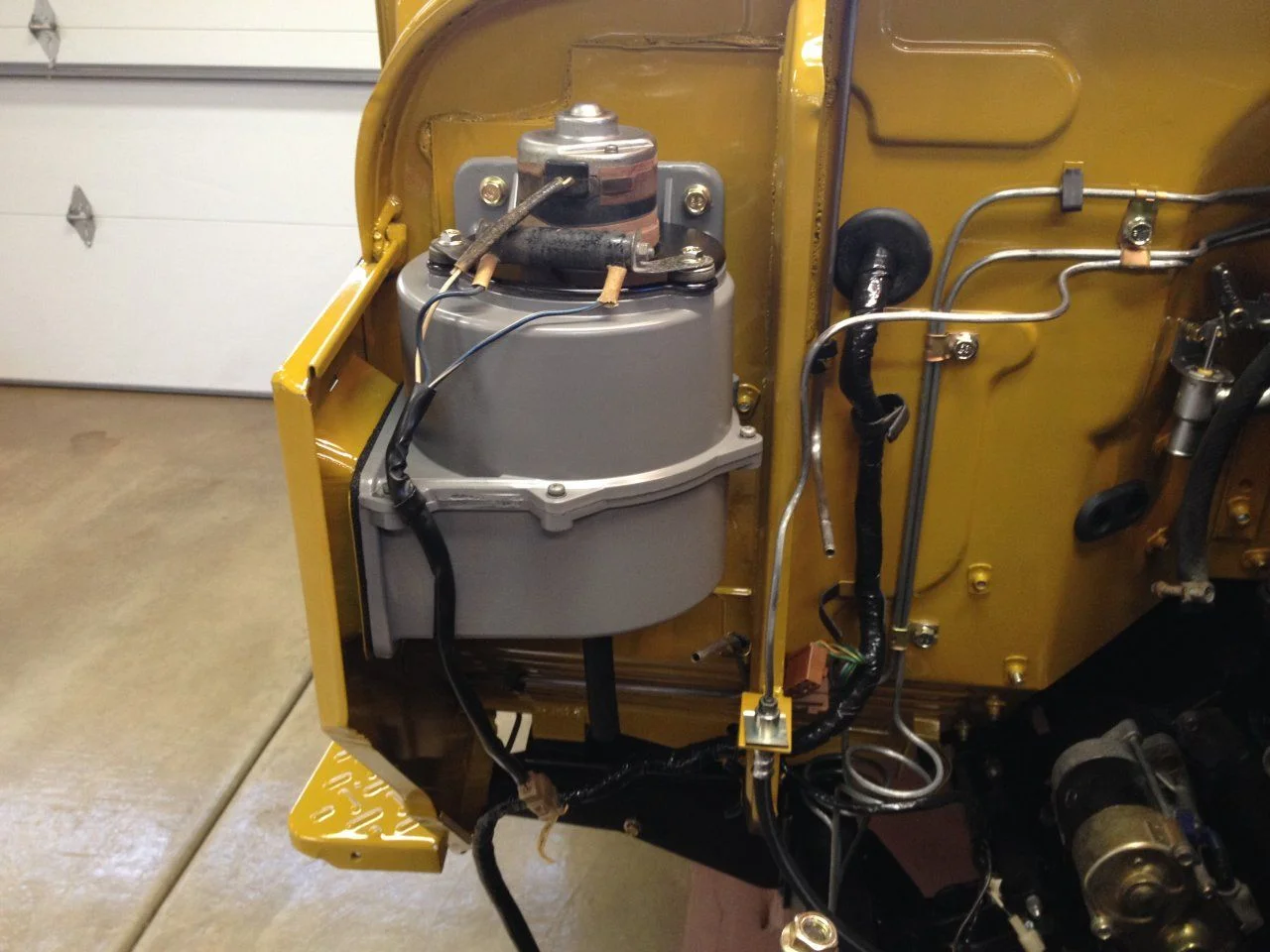

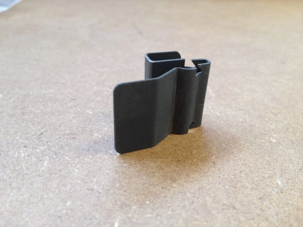

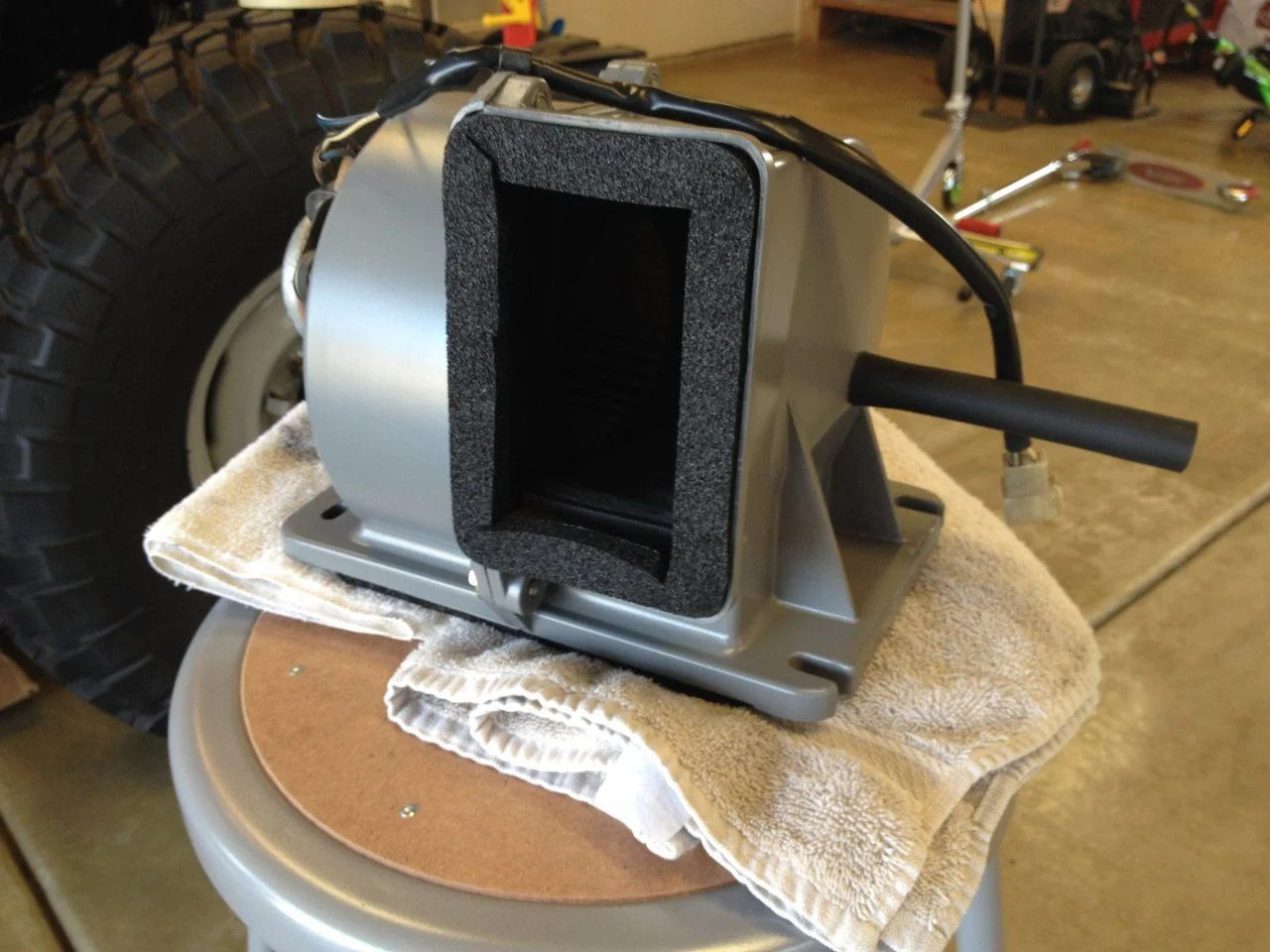

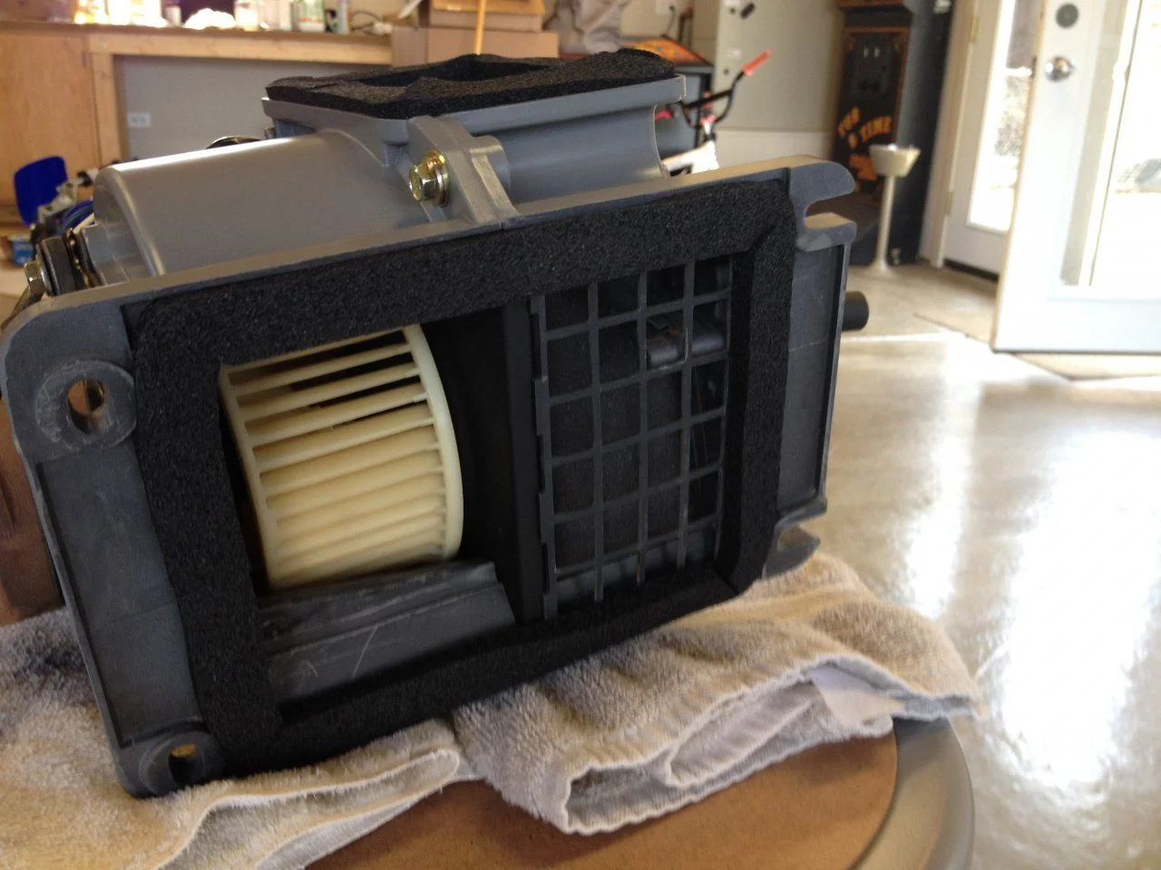

Restored my blower motor using a kit from MetricTLC and installed it. The little clip, I used my rust evaporator and metal treatment on it, turned out nice. I sanded the housing and sprayed it with a Rustoleum plastic paint (granite grey) to give it a uniform color and make it like new again. I spent 30 minutes with some Simple Green and a toothbrush and cleaned the hell out of the inside and the squirrel cage to get the 40 years of crud out of it.

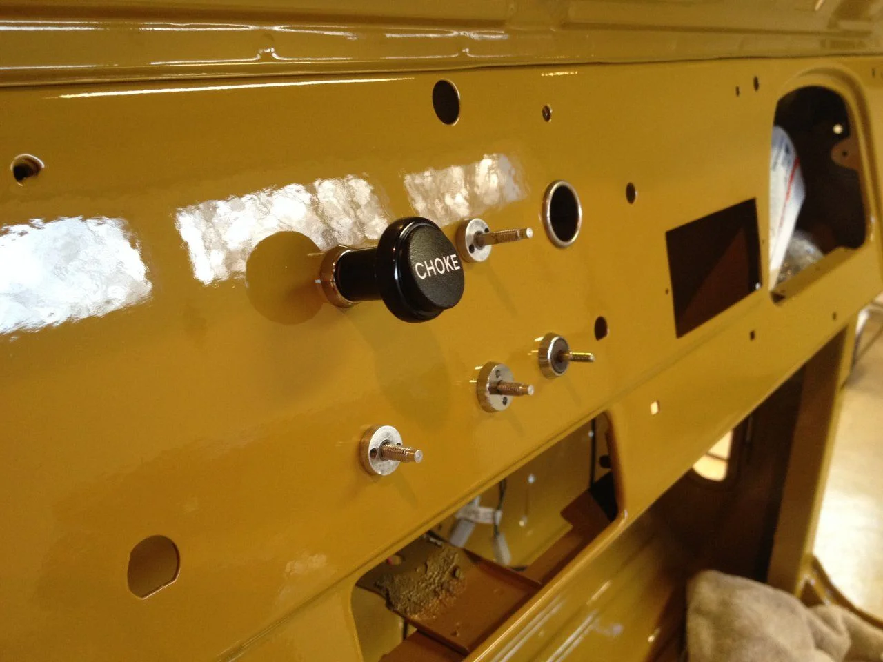

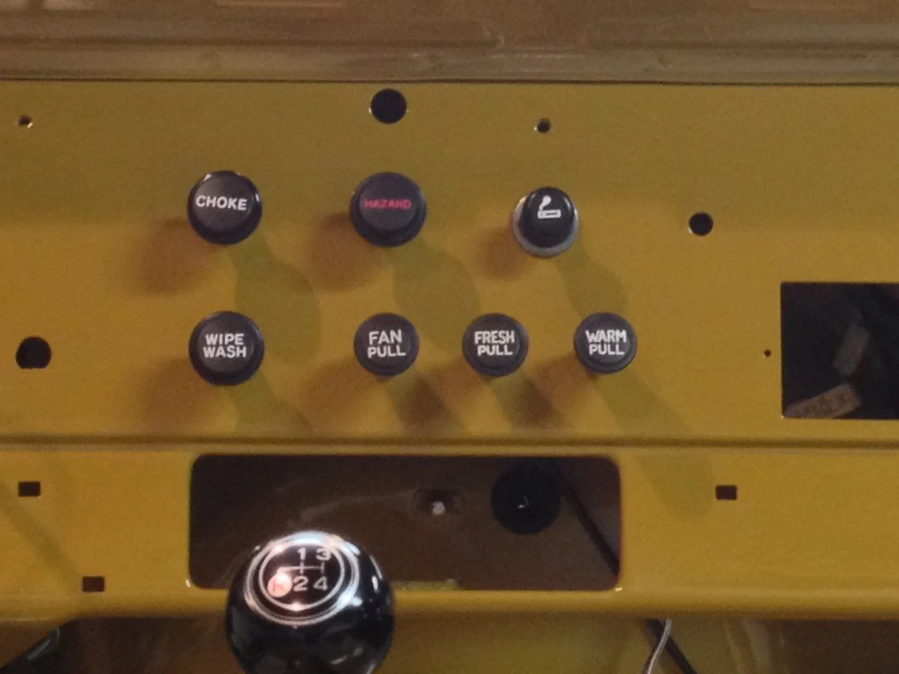

I cleaned all the switches with mineral spirits and Q tips in the terminals and installed them in the dash... Just need the collars for my warm air pull to finish...

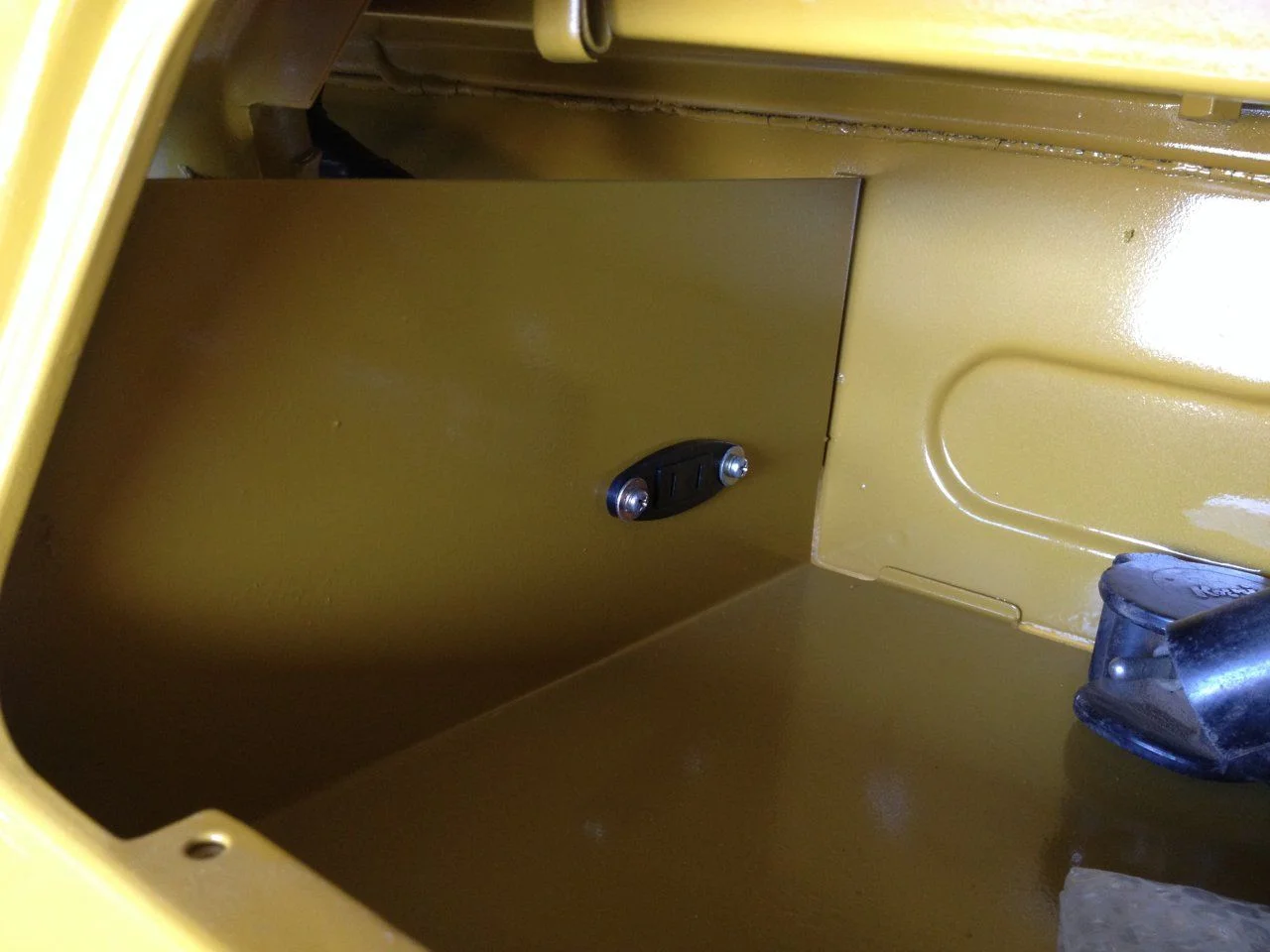

Last I installed my little plug outlet in the glove box, it's little details like this that makes me love Mr. Toyota...very cool. I bought a new OEM trouble light just for it;)

Came home after work today and the wife surprised me with the paint markers I needed to resto my knobs. After following the thread on here and following the instructions, they came out like new! Once again thanks Mud!

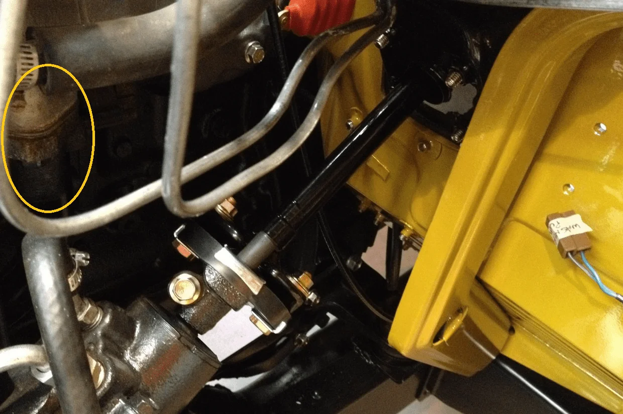

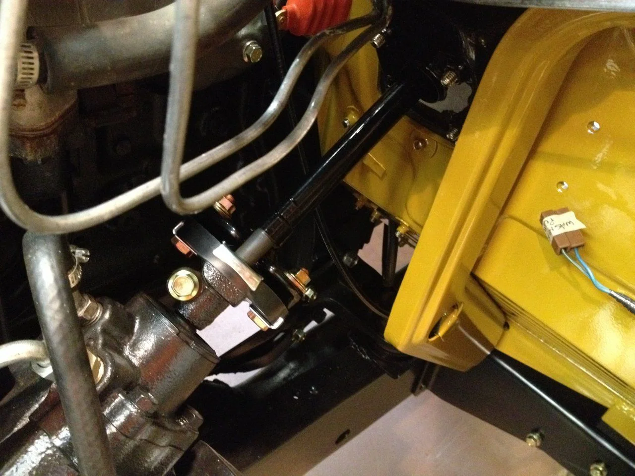

My buddy was giving me crap about the quarter size surface rust on the cast iron exahust manifold in this picture. Now I have to go home and wire brush it and hit it with some high temp paint before i can bolt the fenders on. Never ending.....
Thank him later.
