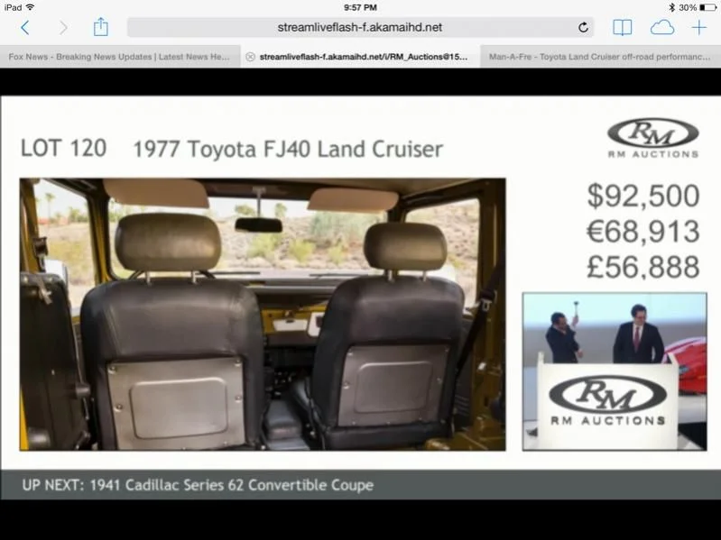

Watched her get sold on the auction block
92k? That must be some kind of record.....nice
