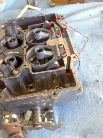

Rebuilt my Edelbrock carb. I followed the excellent advice from this Tech article by Brian Swearingen.
http://www.ih8mud.com/tech/carter.php
I ordered the off-road needles and seats #1465 as well as the rebuild kit #1477. I did make two changes from the advice that Brian suggests.The first was to set the floats at 7/16" rather than the 5/16" to 3/8" he suggests. Edelbrocks factory specs say 7/16" now instead of 9/32", so much less fuel in the bowls. The other change was very minor, Brian suggests splitting a vacuum line down the center and placing both halves in the passage that connects the float chambers to control fuel slosh. Possibly Edelbrock has enlarged the passage a bit as I found that the half sections were a bit loose. Or my vacuum hose is slightly smaller than what Brian used. I cut two 1" sections out at 2/3, their not going anywhere now!
Those mods should help the off-camber situations.
She fired right up once the fuel hit the bowl. Dirty Sal's never run better, very responsive! I'm stoked! :bounce::bounce::bounce:

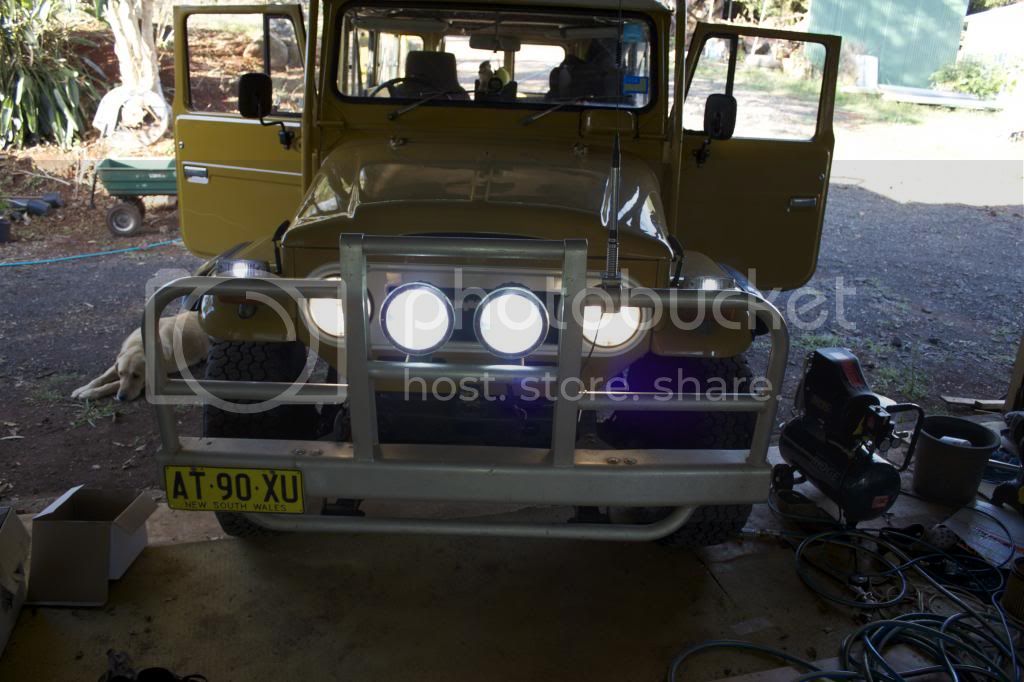

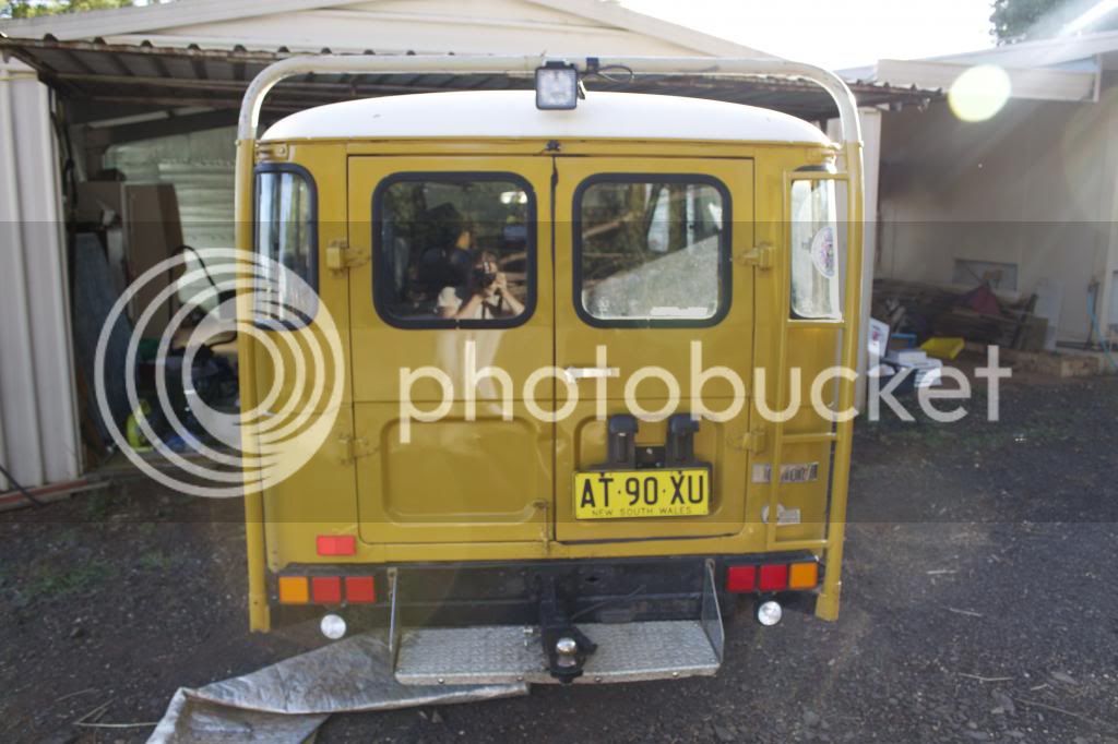

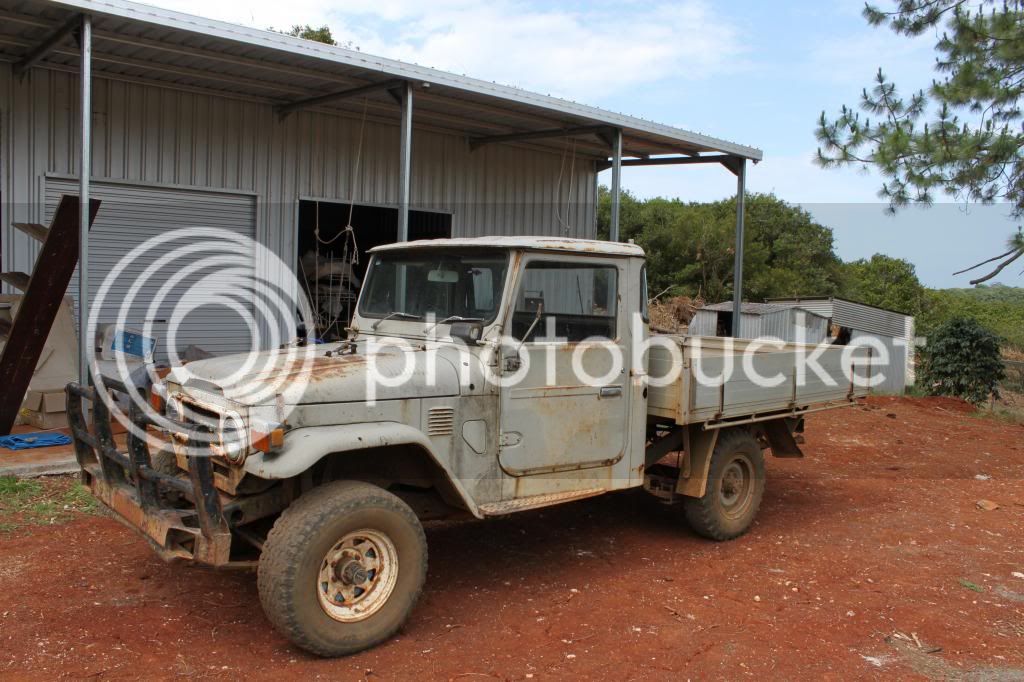

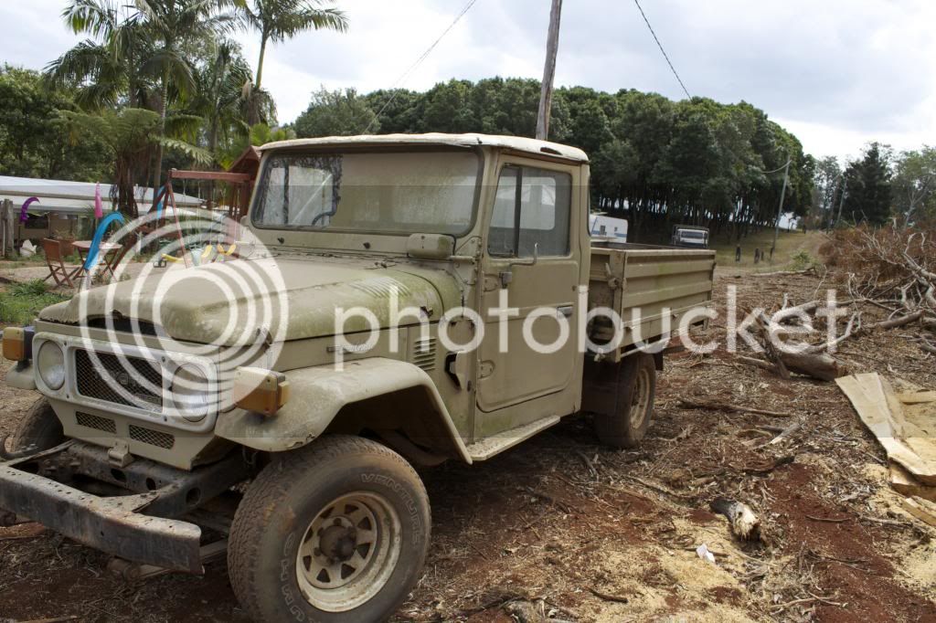

Hey, so i have had a busy week. i was told of a few cruisers sitting in a shed, one was a petrol the other a diesel and the diesel hadnt been used for about 3 years. so i took some tools and very quickly got them both running and driving and then bought them. A 76 FJ45 (2F, Lukey Headers) for working on the farm, and a 12/80 HJ47 ute, with a 2H diesel which i will strip out for parts/sell. They both have pretty nasty rust, and probably wont see the roads again, but good for me.
I also put HID spotlights from ebay on my troopy, along with an LED worklight on the back and new 7 inch crystal lights. And i put my 73 FJ45 project up for sale. Oh and i also started rebuilding disc brake front end for my troopy. Its been a good week.
76 FJ45:
1980 HJ47:
New Spotties and Worklight on troopy.
