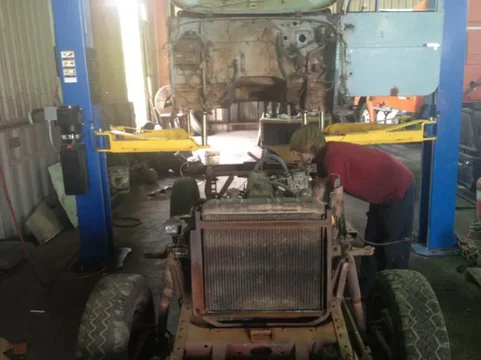

Got my body off the frame JUST to replace the piece of frame where the muffler rides on. Since I'm fabbing up my own bed and fender wells it was a good call. I can also run all my brake lines, fuel lines, and install a rear mounted tank while it's off. I've decided to take it to blasting in the morning and box up the rear section of the frame when it gets back.
Found my skid plate under the radiator is pretty rusted. Does anyone have a suggestion on this? Should I make my own or does anyone re-pop these?
This is the whole reason for the frame off... STUPID MUFFLER

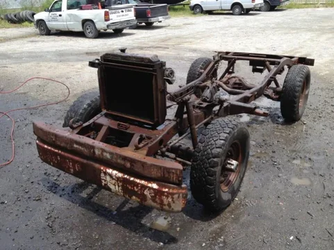

Another shot
The lift and crane we have makes this sooo much easier
Here is the radiator skid plate... I take a lot of pics for documentation... I can't believe this is the best one I have.
Chassis is pretty rusty. Is not severe rust just really heavy surface rust. The worst parts are the section of frame and the radiator and left skid plates. Other than that it's pretty solid. Hopefully I can get it powder coated to... If the wife ups my allowance. lol
