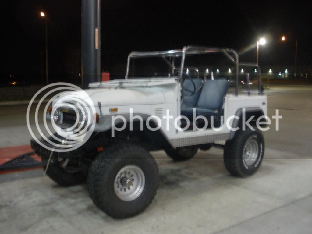

PhilC64 who builds that cage??
looks great!
and are those 35s w/a SOA??
LMFAO!!! i just read yr signature and i think i woke the house up when i started laughing... my eyes are watery now...
A fellow Mudder, 4Rnr, did that up for me. It's a little similar to a commercially available cage but has some definite differences. The side hoops come from the floor to the rear hoop but curve in significantly before they connect to it. The roof bars are triangulated to add strength, not perpendicular in other cages. The side hoops conform to the dash with only three bends and there is a slight hump in the main rear hoop where the two roof supports meet it. The cage has some pretty sweet lines to it as well when you look at it from a few different angles. If I ever want to get "stupid", I can add in more tubing if I want.
The front tires are Goodyear 35x12.5x15 MTR's on an SOA. I'll be adding two more Goodyears to the rears shortly when more of my cash frees up.
