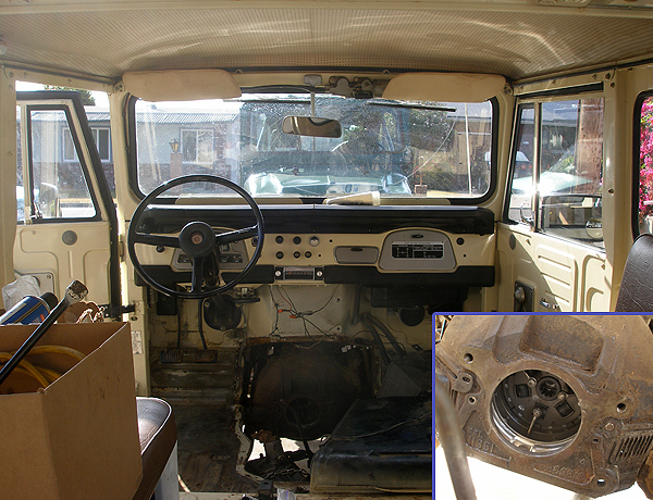

Installed a new oem main seal, pilot bearing, throw out bearing, clutch, and pressure plate, on my friend's fj40. Clutch and pressure plate looked good, but the main seal NON-OEM was leaking, and the throw out bearing was failing. Go figure, the throw out bearing had MEX stamped on it's side. Got the new stuff from CDAN, and they were all the right parts.:clap:

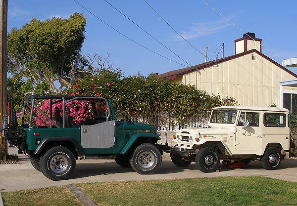

Started to weld up my new homemade floor pan and will then move on to new wheel wells & fenders. I'll finally be able to ride around without fear of falling through the floor!
