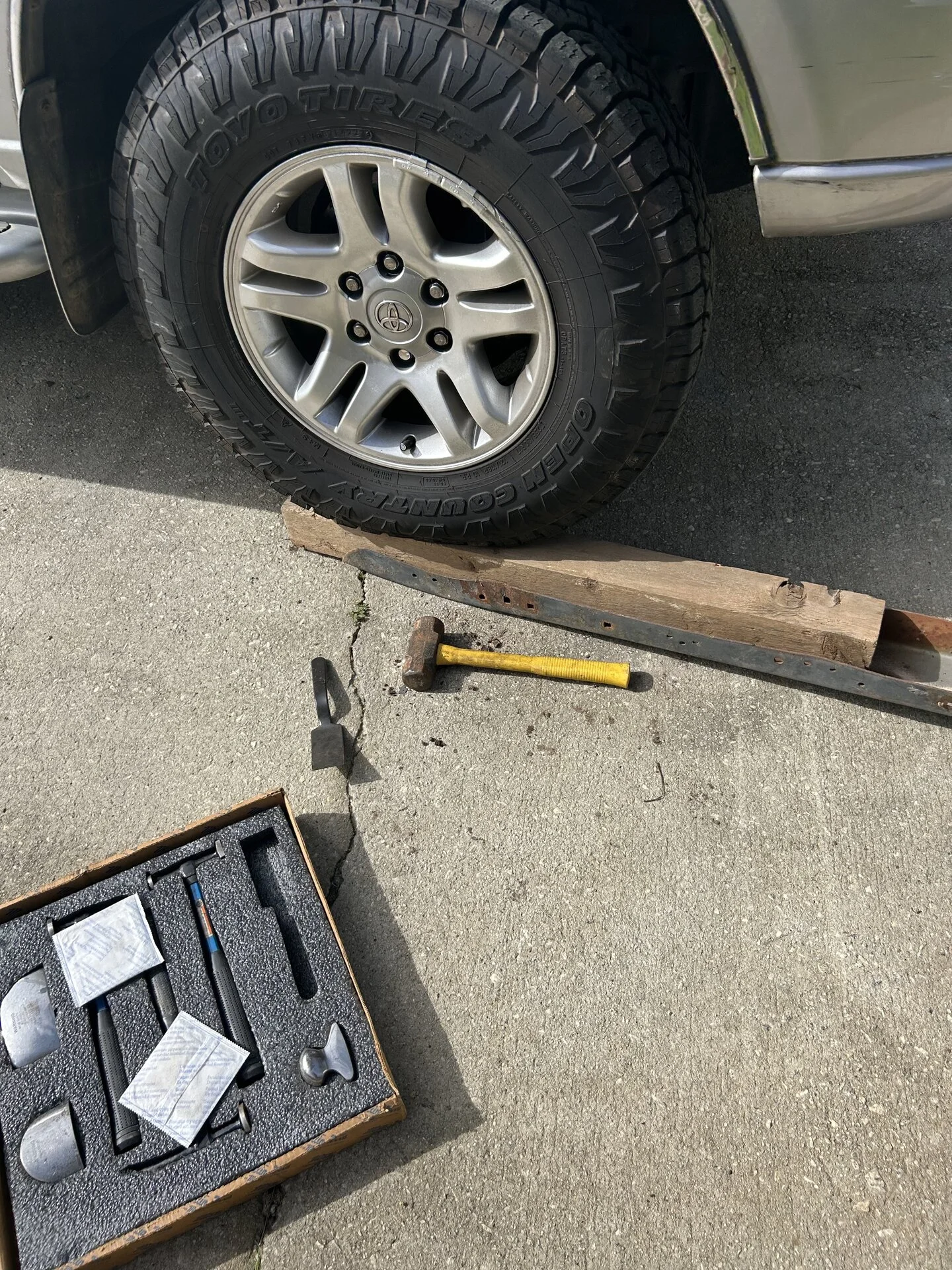

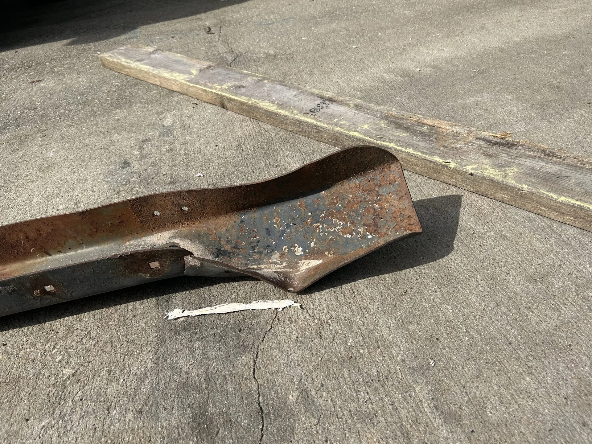

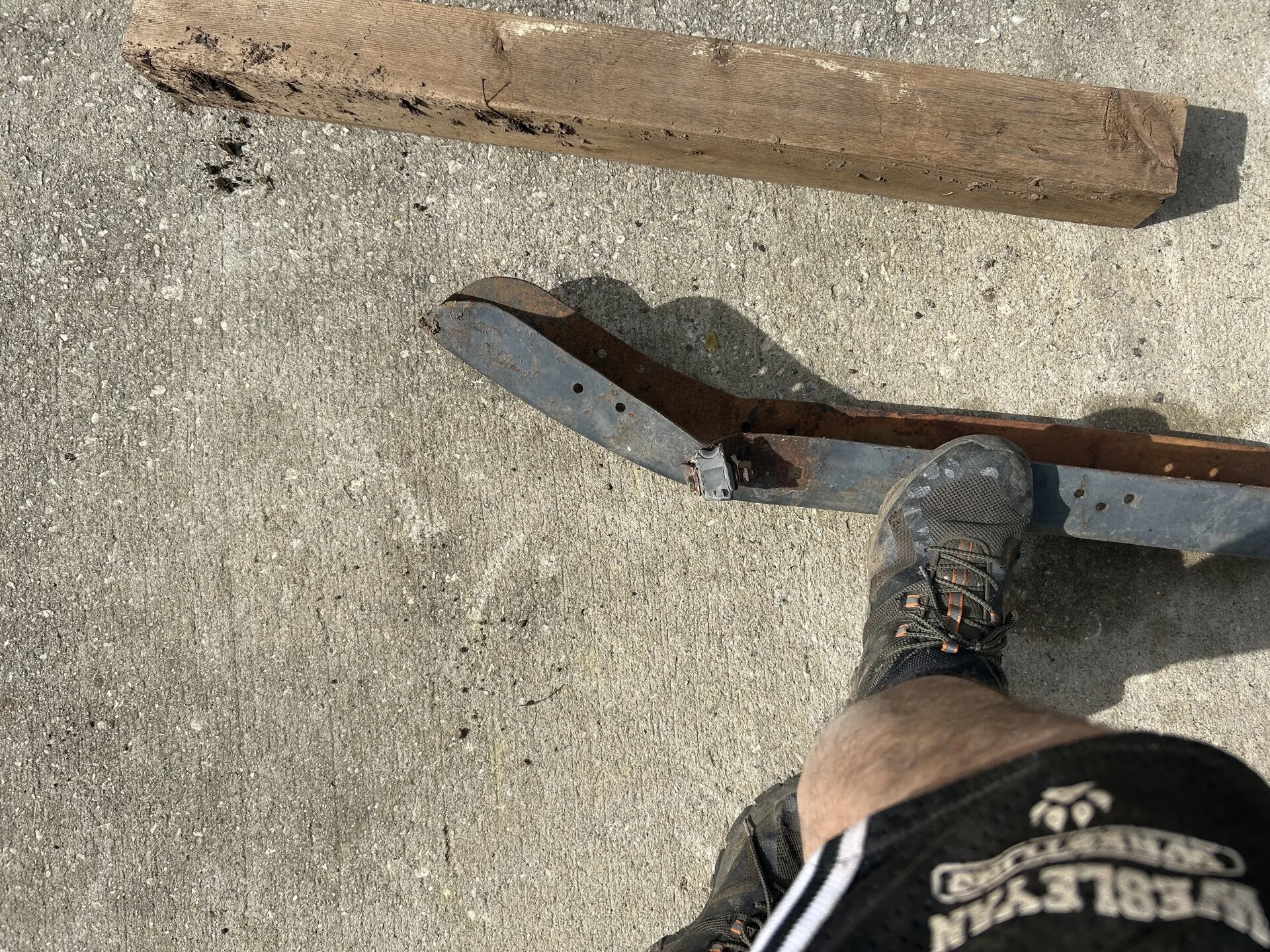

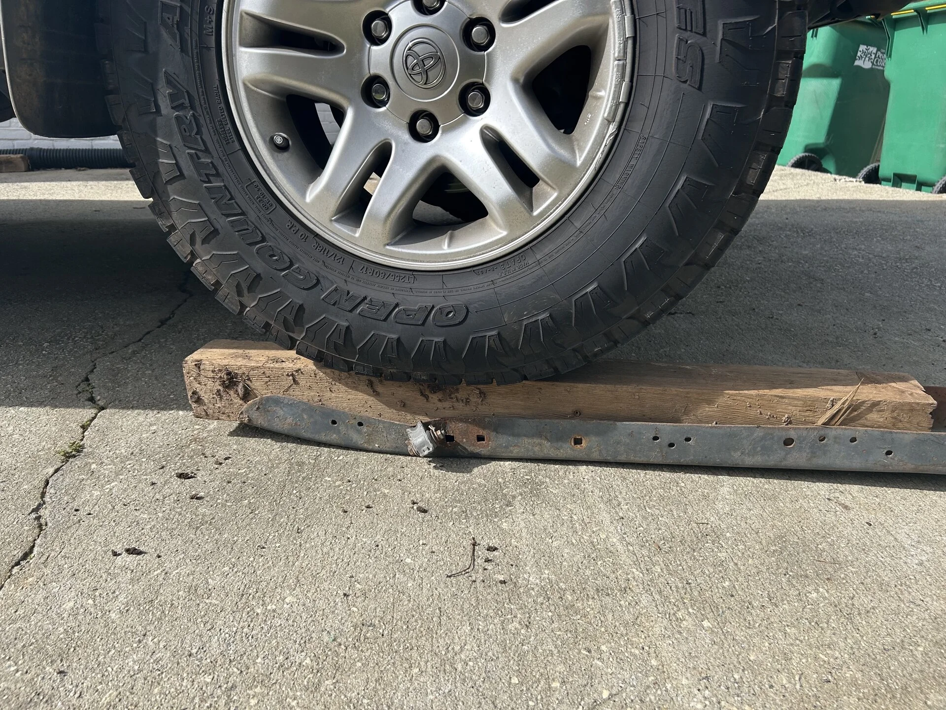

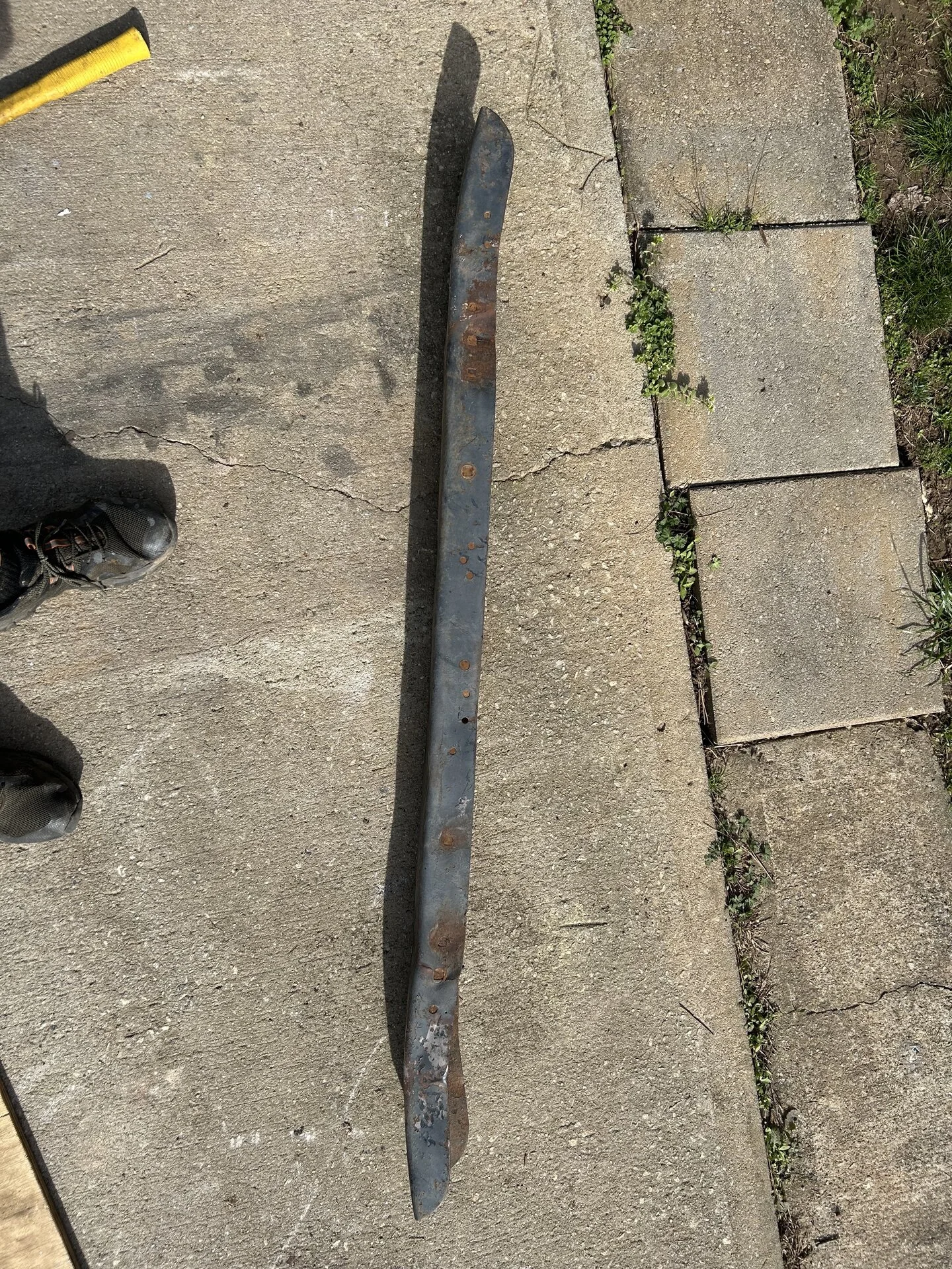

Bumper work...
Still a slight twist on the driver side, but I'm not done with it. :)

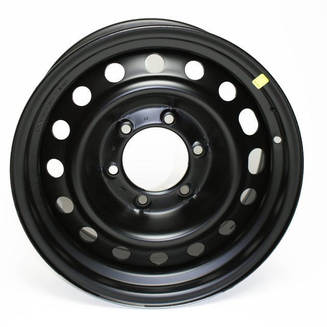

Highly recommend the black steel spare wheels from OEM.
Those look good. Simple and nice. Just got a totalled JDM 1994 FZJ80 that some one had shipped in and shortly thereafter rolled it over hard. Man it was deluxe. Center console beverage cooler, 3rd row AC, premium wheels. Don’t think it has front and rear lockers, but I’m going to pick it up Monday and find out more...

A normal person would probably just buy a new bumper… what a wrencher/hotrodder would do is use an oxy acetylene torch to heat it up and bend it back… what I did (since I do not have an oxy acetylene torch) is some old fashion shade tree mechanical engineering.
Ratchet straps, old tree, cold beer....

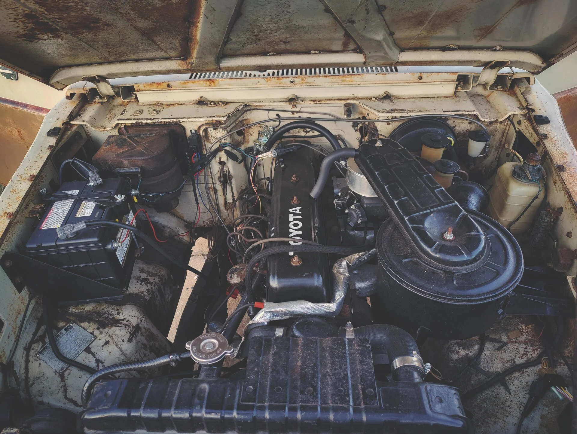

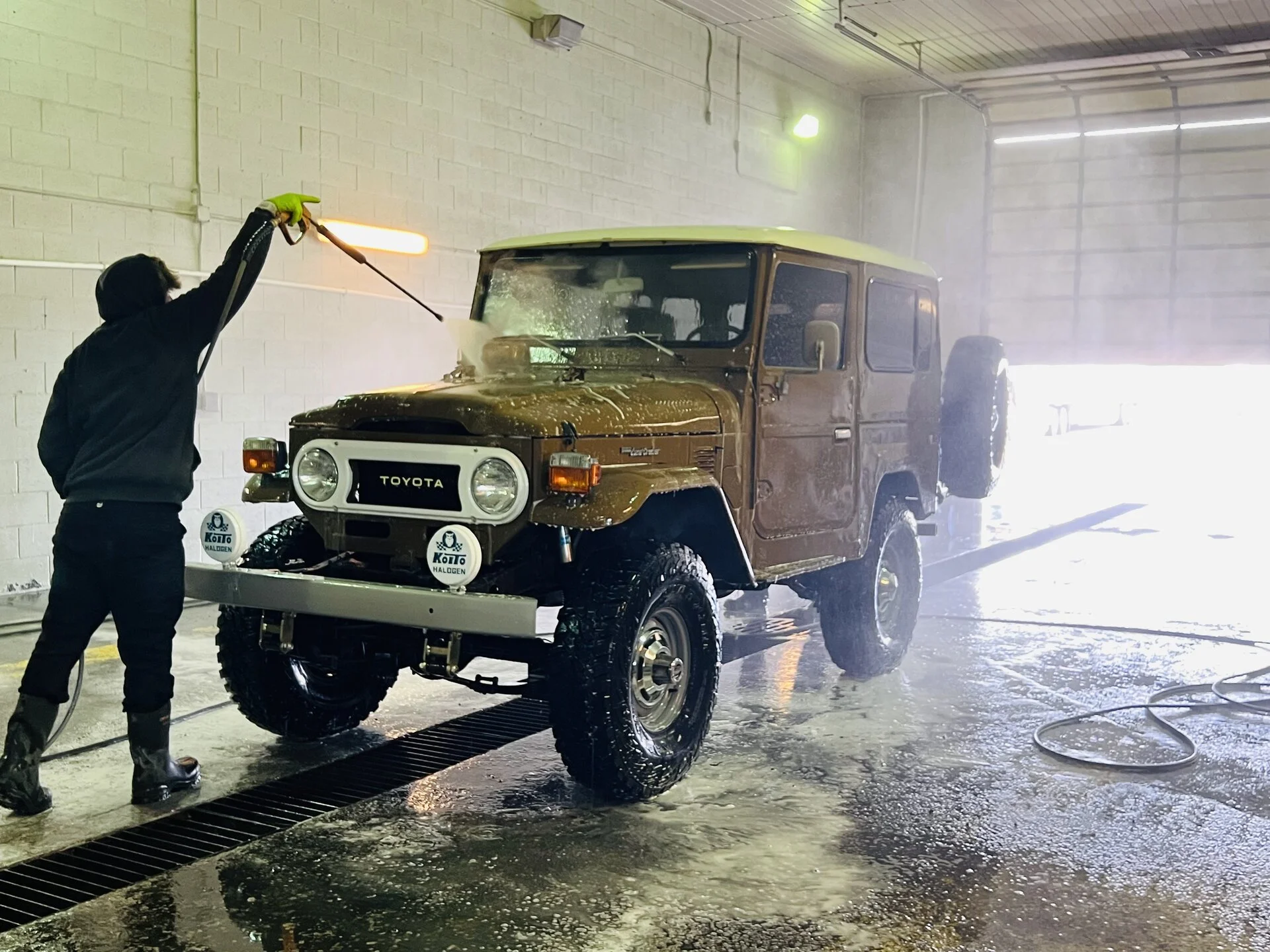

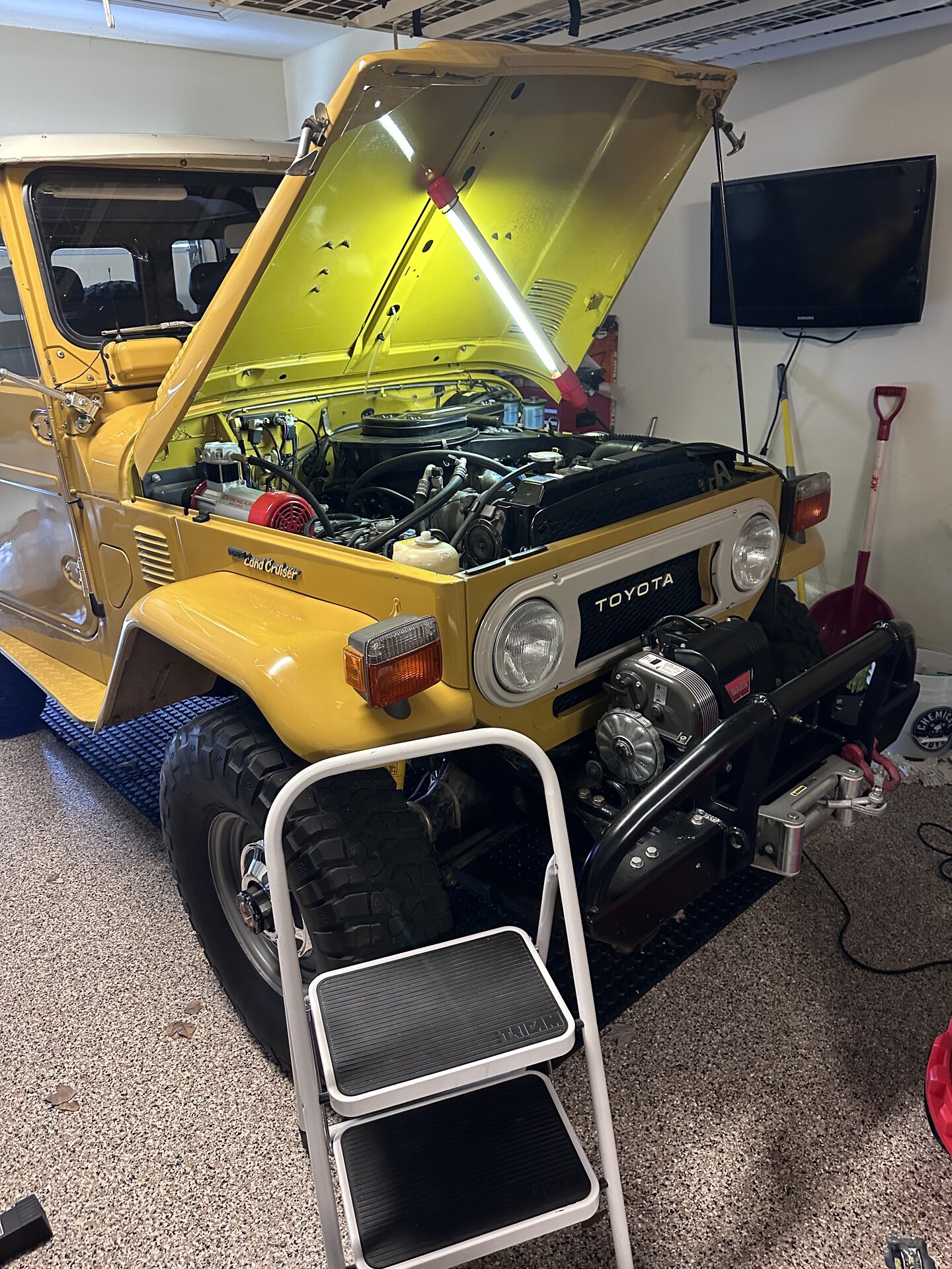

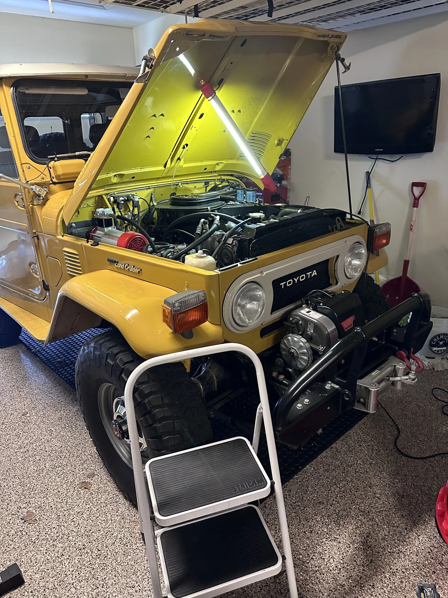

Prepping Chester the ‘72 SBC 40 for the LSLCRU.

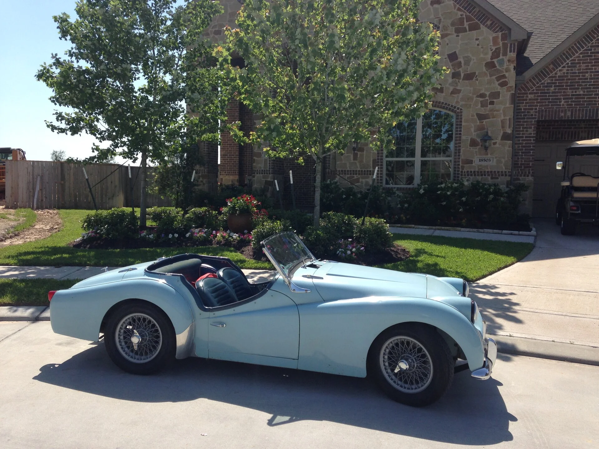

Digging the TR3 in the background
Thanks, it’s been in our family for the last 25 years. We bought it for my Dad as a 50th birthday present. He had one through college and sold it when I was born. It was the only car my parents had at the time and no room for a kiddo. A fun little car that we were lucky enough to acquire from the widow of the original owner, which will be handed down to our son one day! I’ve been it’s caretaker for the past 17 years.

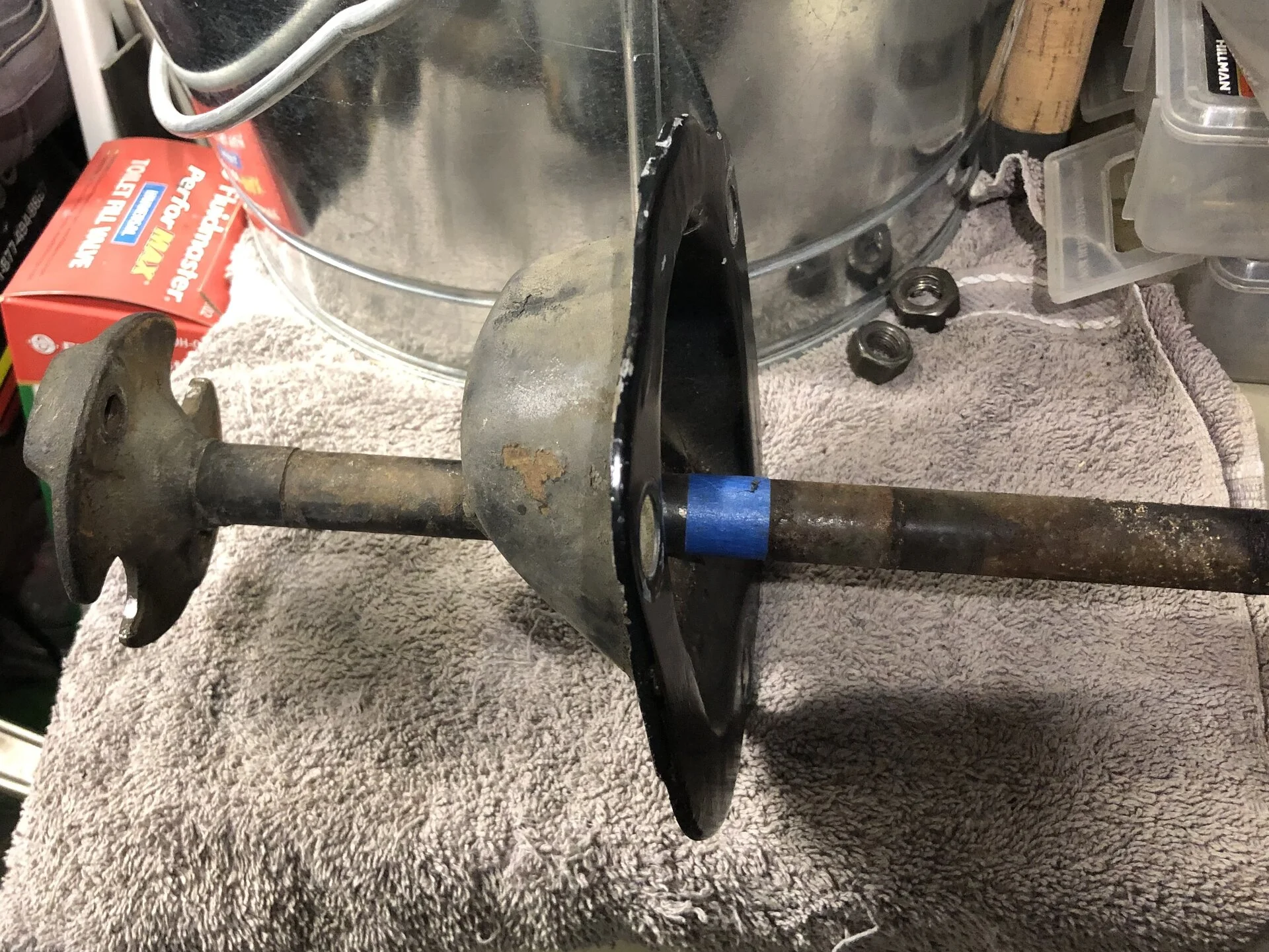

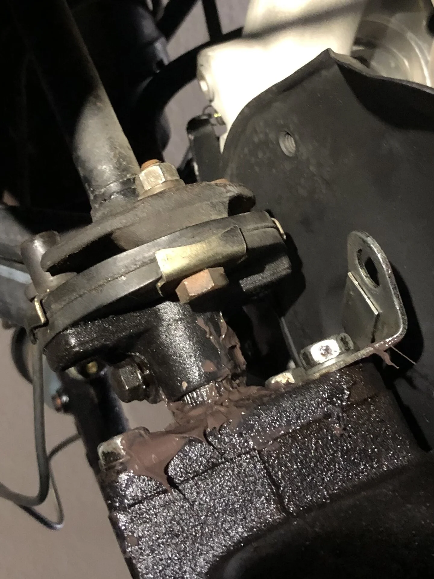

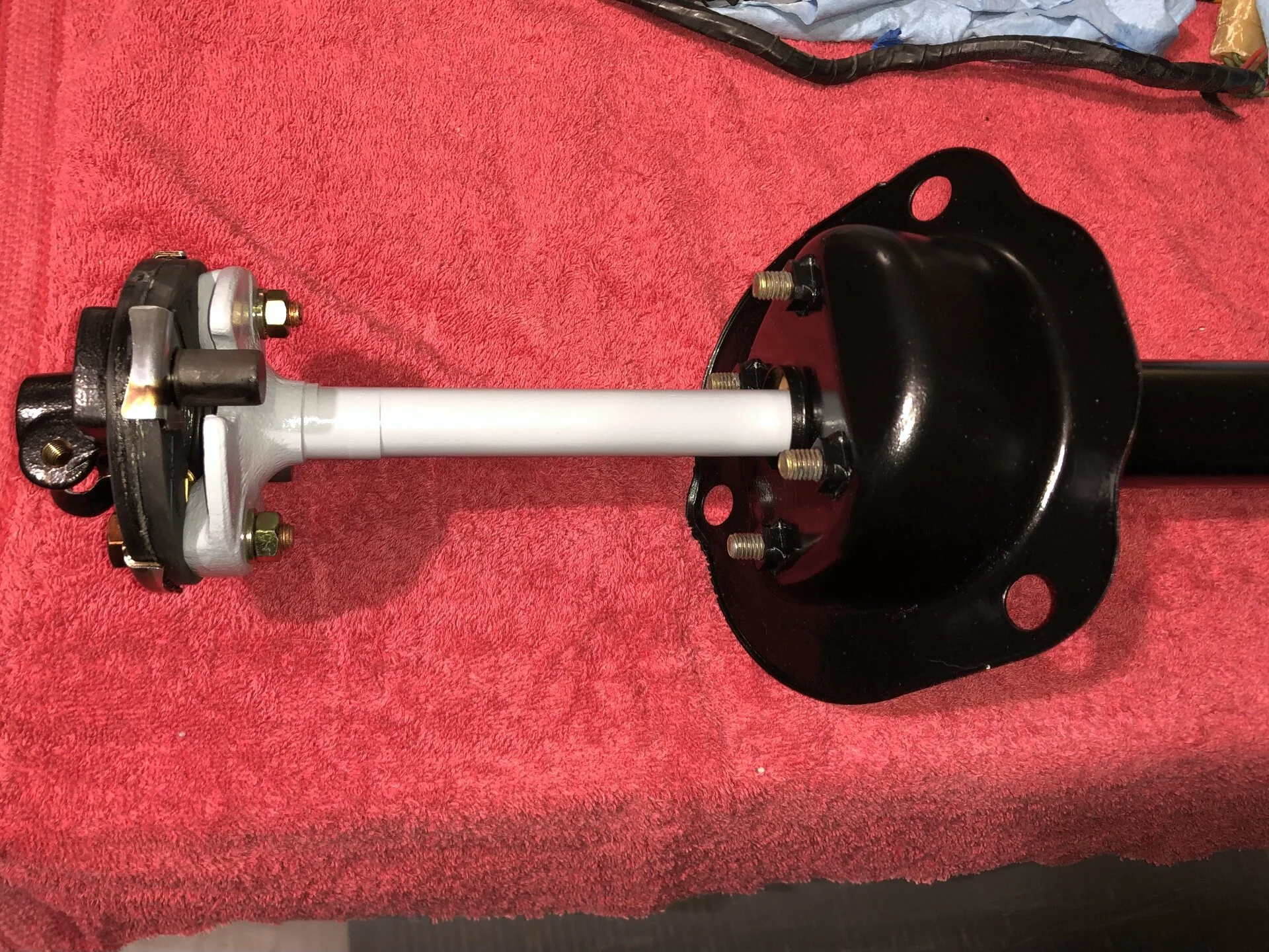

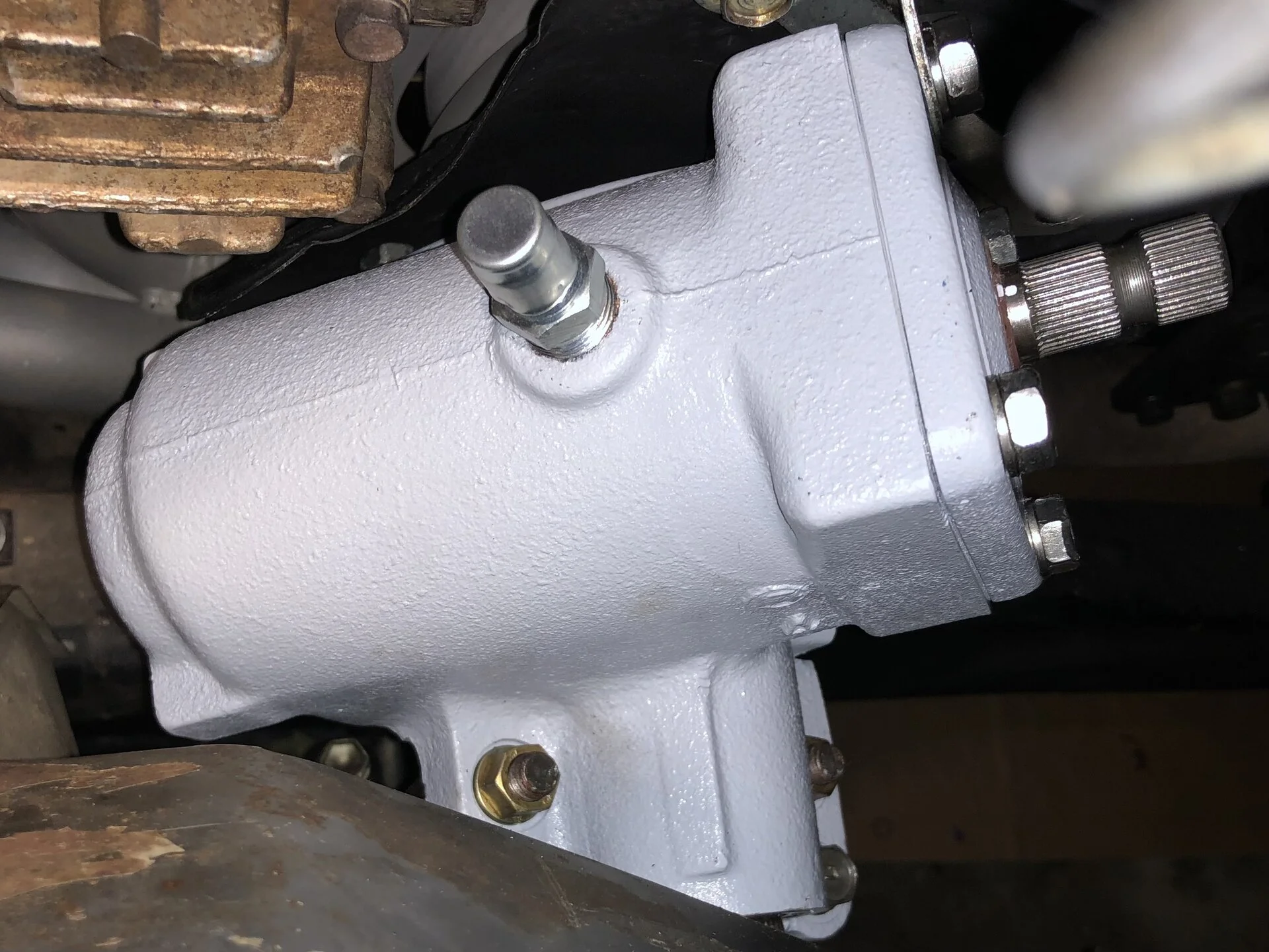

Installed a rebuilt steering box, first time in 20+ years of ownership. The old one was loose, out of adjustments and leaking.
I repainted the box because it was packed in a plastic bag with wet paint and was a mess.
I went with primer gray with a clear coat over it. While I had it apart, I painted the steering shaft and column, installed a new rag joint, and repacked the bearings. The steering is much tighter now and I don't look like a drunk on the highway.
