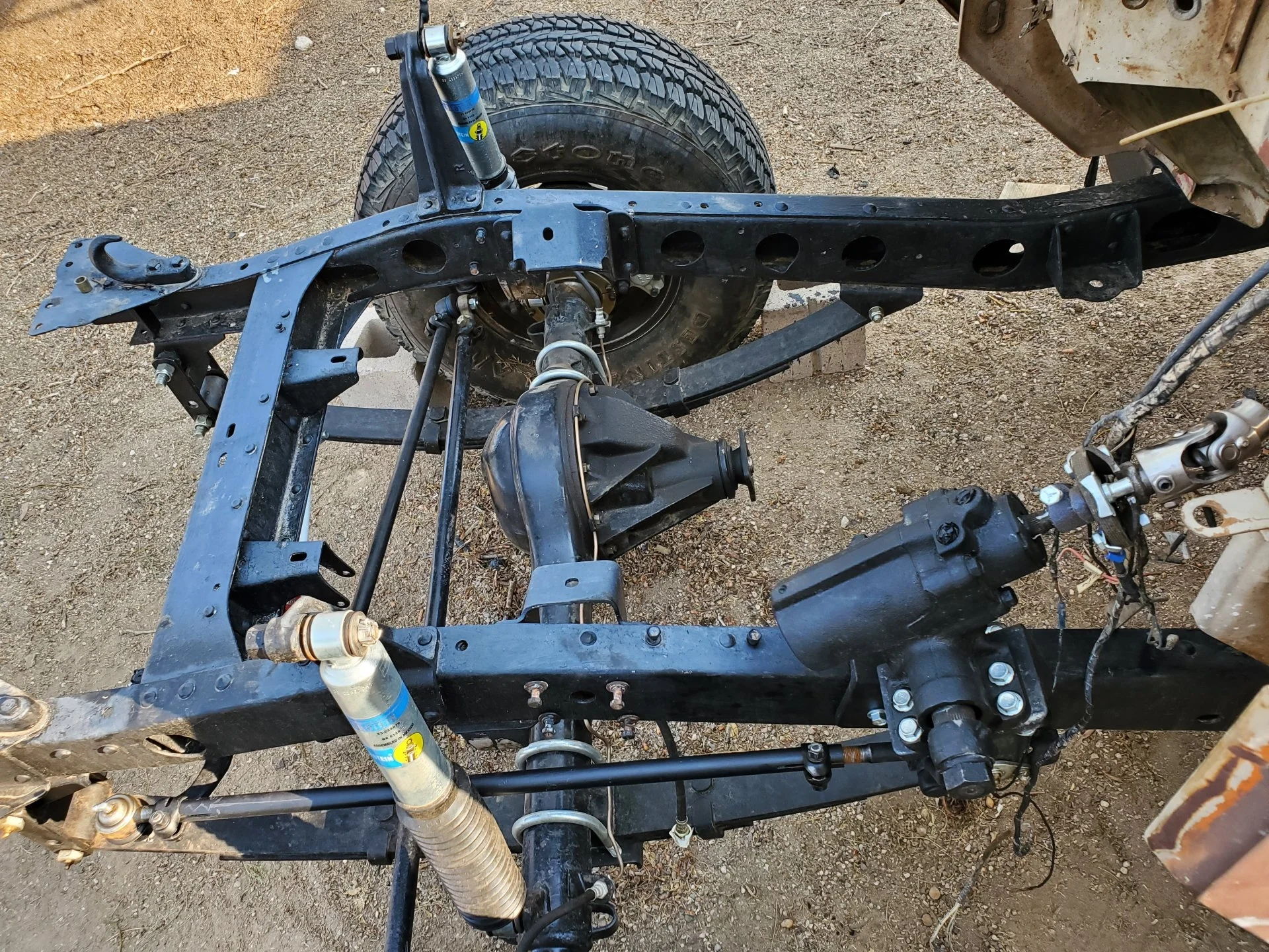

I would remount the steering box up a half inch or so and correct the suspension. Looks like lazy work and planning from the OP.
I was looking at that as well. It actually looks like a pretty simple fix to mount it up an inch or so higher. I'll research a little and probably go that route. Other than that the cruiser is very solid. Definitely pleased with the purchase.

Swapped my leafs from front to rear and rear to front. Cruiser had a bad squat when purchased from PO. Leafs were on wrong ends. Looks appropriate now. Still need to flip shackles however I couldn't because driver front shackle bolt is welded to the inner shackle plate because it's to close to the power steering box to get a nut on the backside. No worries I'm planning shackle reversal or at minimum different shackles period. I like the HFS from ccot but would probably have the same clearance issue without shackles reversal. Either way it's much more level now. Has any one else ever seen this or have any other ideas. I was thinking a thinner nut might clear.
Psssst. Your anti-inversion shackles are upside down.
Psssst. He already knows that.
The shackle issue is a pretty common one. They are upside down because if you installed them the right way, the anti inversion bar will basically be sitting right up against your power steering box mounting plate, and severely limit travel. I had my saginaw steering done by a shop before I was brave enough to do it myself and they left me in the same situation. I resolved it by installing some steel spacers to shift the box as far over in the frame hole as I could, then ground down the top portion of the shackle to make enough clearance for a ny-lock nut. These after-market shackles are so thick that you could probably do this and still wind up with thicker metal than the stock shackles were made of. To this day, I run a standard bar shackle on the front driver's side, and anti-inversion shackles everywhere else. The bar shackle will bottom out on the saginaw box mounting plate before the spring can successfully invert. Not ideal, but more ideal than sawing the entire saginaw conversion off and starting over.

This weekend I finished up mounting the minitruck power steering box after shortening my drag link.
